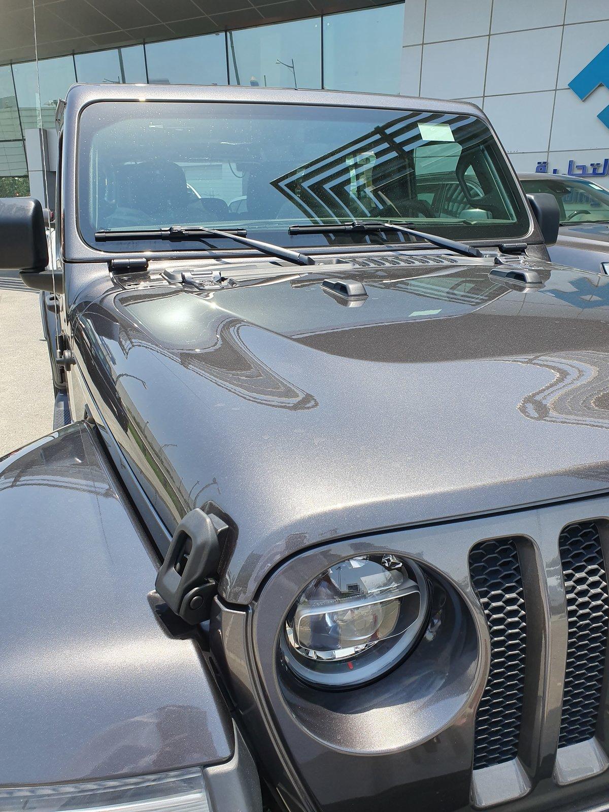

Hi,
I am facing the same issue but a bit different, my Sahara JL 2019 bought in the United Arab EMIRATES (Dubai) is equipped with LED package but I believe the halo is disabled, I guess we are following European standard in terms of specs.
From the look of the headlight, it seems the Halo ring is there but disabled, I am not sure if the headlight is disabled by software or hardware (4th missing wire). Anybody have any information or solution on how to enable them.
I am in love with Halo light they look much better.

Hi,
I’m in same boat as you. My EU spec Wrangler looks like it has halos in there but is disabled.
However with some digging the headlight connector only has 3 pins while USA one has 4 pins, the fourth being the halo. So I’m starting to doubt that the halo is in there for export Wranglers.
Until someone with an export Wrangler opens up the light housing we won’t know if the hardware is there or not.
