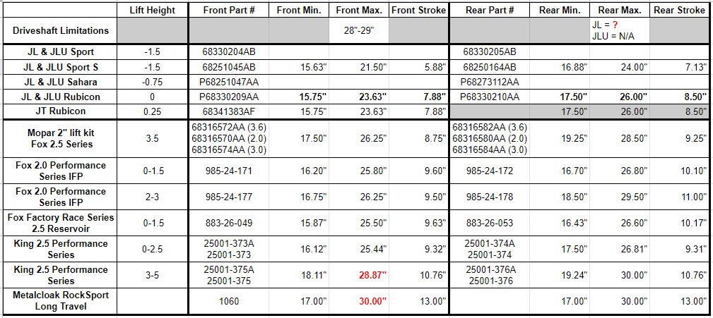

They aren’t short. They are exactly what they need to be with a 2-3” lift. If you were so inclined, you could make extensions work with more bump-stop.
Specs for the Mopar FOX 2.5
17.50 collapsed and 26.25 extended on front
19.25 collapsed and 28.50 extended for the rear.
Thanks @AnnDee4444 for the list.
FWIW: Due to the angle of the rear shocks, the rear suspension travel is greater than the shock travel. For the Mopar Lift Fox shocks, the suspension could have up to about 10.5" of travel even though the shock's stroke is only 9.25".

I know the extended length if that helps, 29.3 “‘ in front and 30.3” in rear. I think the travel is 11.5 in front and 12 in the rear , but not positive. The extended lengths I’m sure of.
Are you sure they aren't 28.3125" in the front? I can't seem to find any 29.3" extended shocks listed on their website. From: http://rockkrawler.com/2-25-loop-loop-emulsion-shock/
