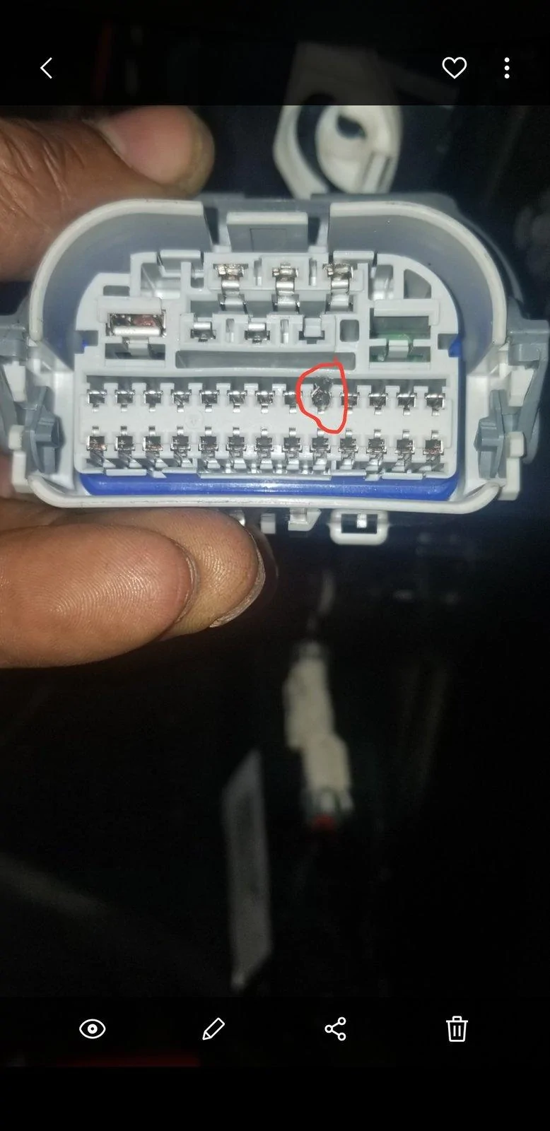

I went to install the mopar auxiliary switch kit and everything was going smoothly until I tried to pull the orange wire #13. I push pin tool in it and tying pulling orange wire from behind and it wont come out. I pulled back the black cover on back of wires and still cant disengage the wire. I hope I didnt mess up the pin inside the connector- how or what can I do to get this wire out - dont wanna take it to the dealer for this wire

i used a simple straight dental pick, and pulled on it with a small pair of needle nose pliers. It wasn’t easy, the lock took me a few times but I felt the wire move when it unlocked.
