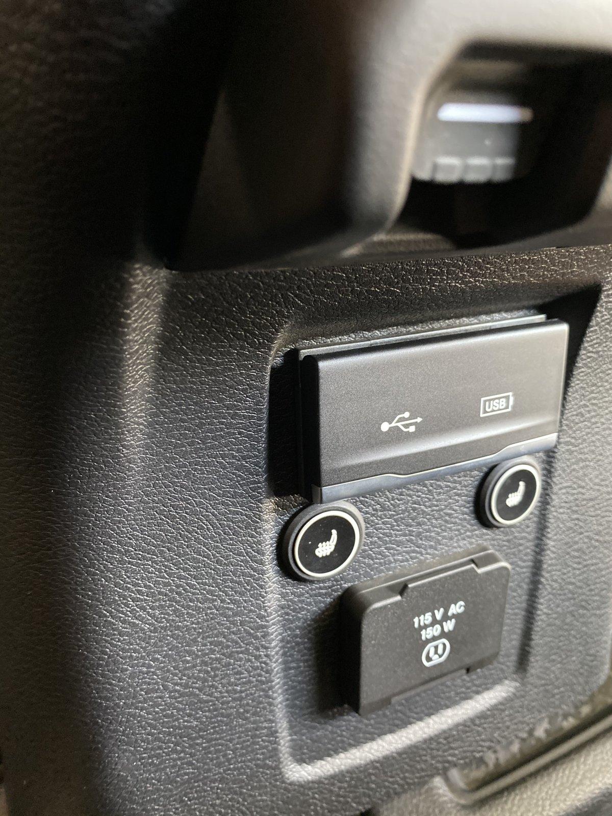

Little project I’m working on!

Once I get it all wired up and going I'll share more pictures.
I purchased the heating pads from amazon ($68), there are a bunch to choose from so I picked out the one with buttons that would look close to factory and I think i made the right choice. Currently I'm just wiring everything up. I will be taking the seats out and taking them to a upholstery shop to have the heaters installed inside the seats. The shop that installs Katskinz leather and great reputation quoted me $200 if I bring the seats to them. All in under $300 for heated rear seats is not bad in my book!

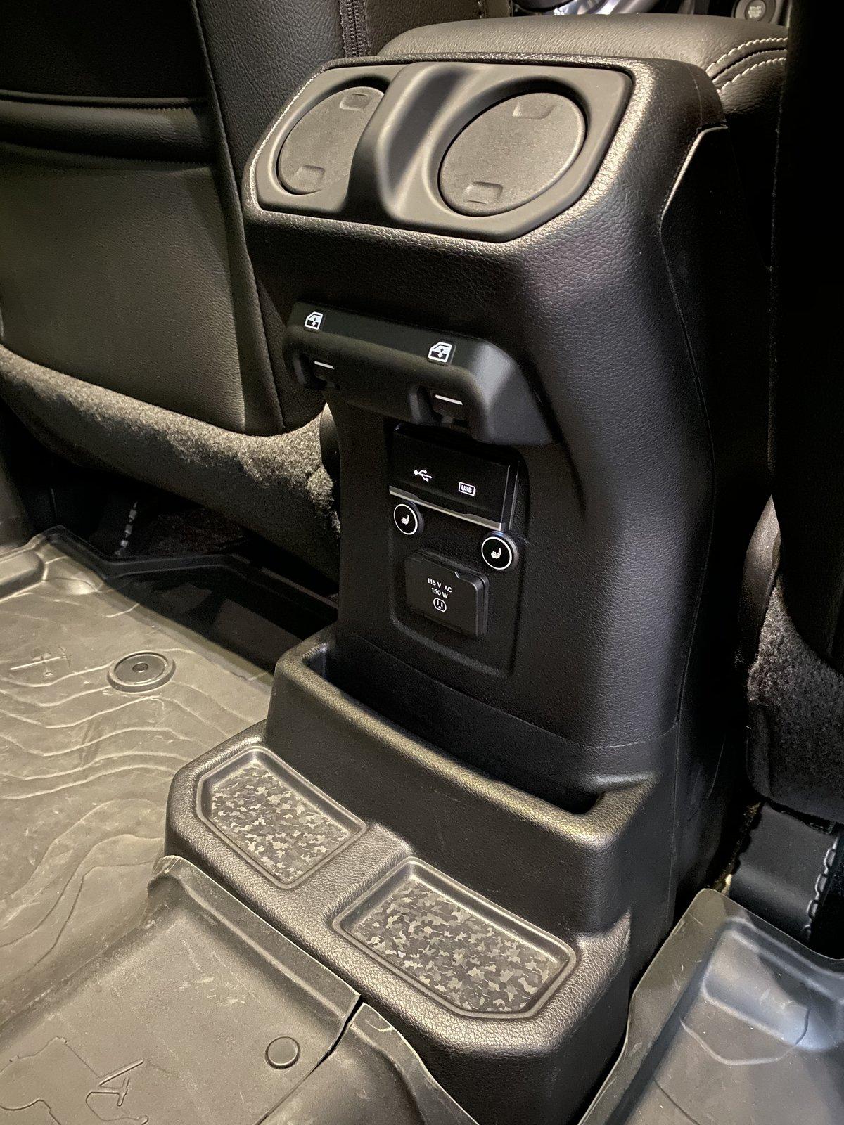

I ended up getting the power from the rear window switch, there is a large gauge pink power wire and dark gray ground I tapped in to. I tucked the heated seat harness and module in the opening under the center console and ran the heating pad wire harness under the carpet to the back of the seats where I will be able to plug the heating elements in.

The buttons look great. I'm interested to hear how it all turns out. I've been wanting to do this for awhile.
