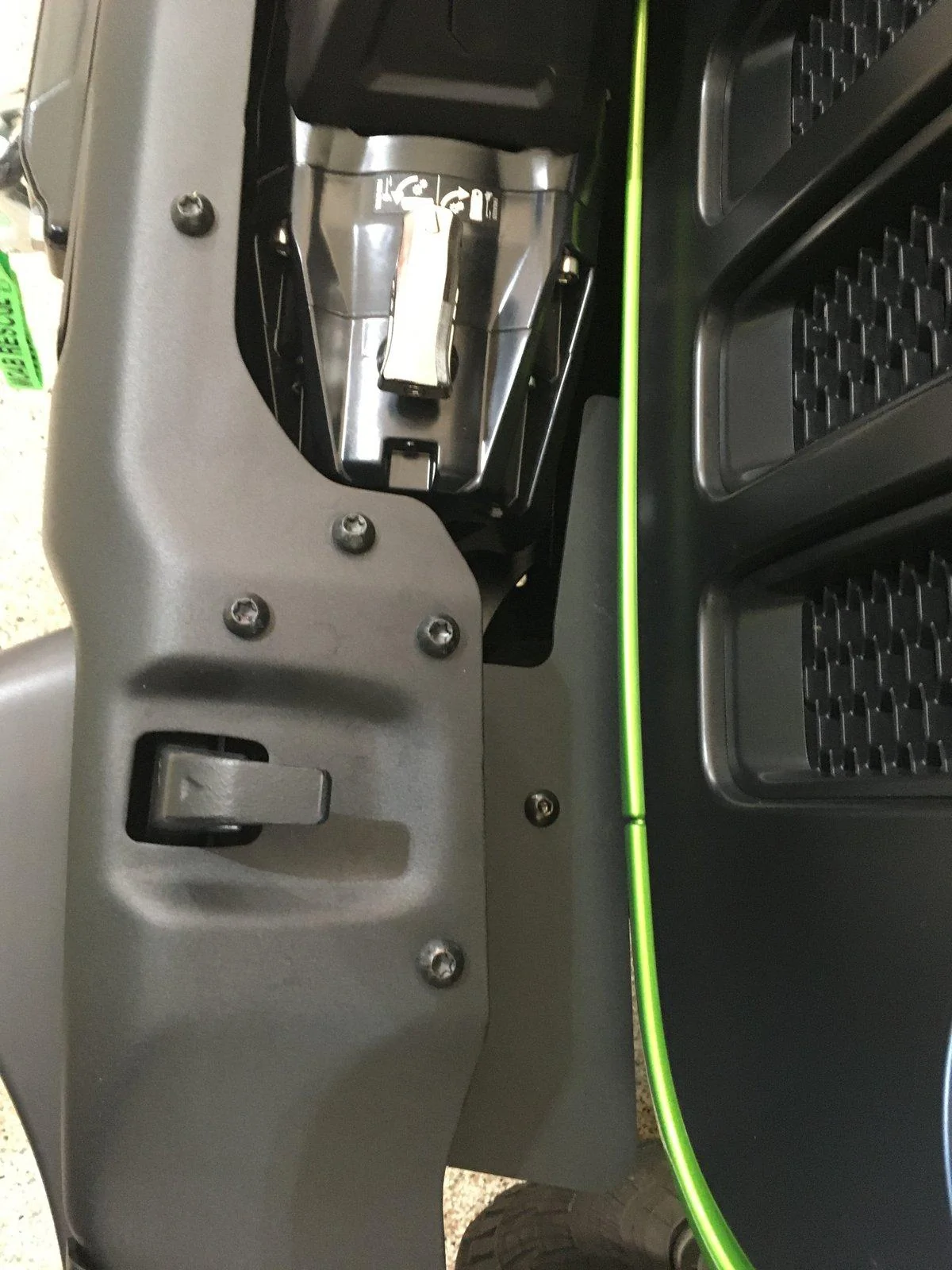

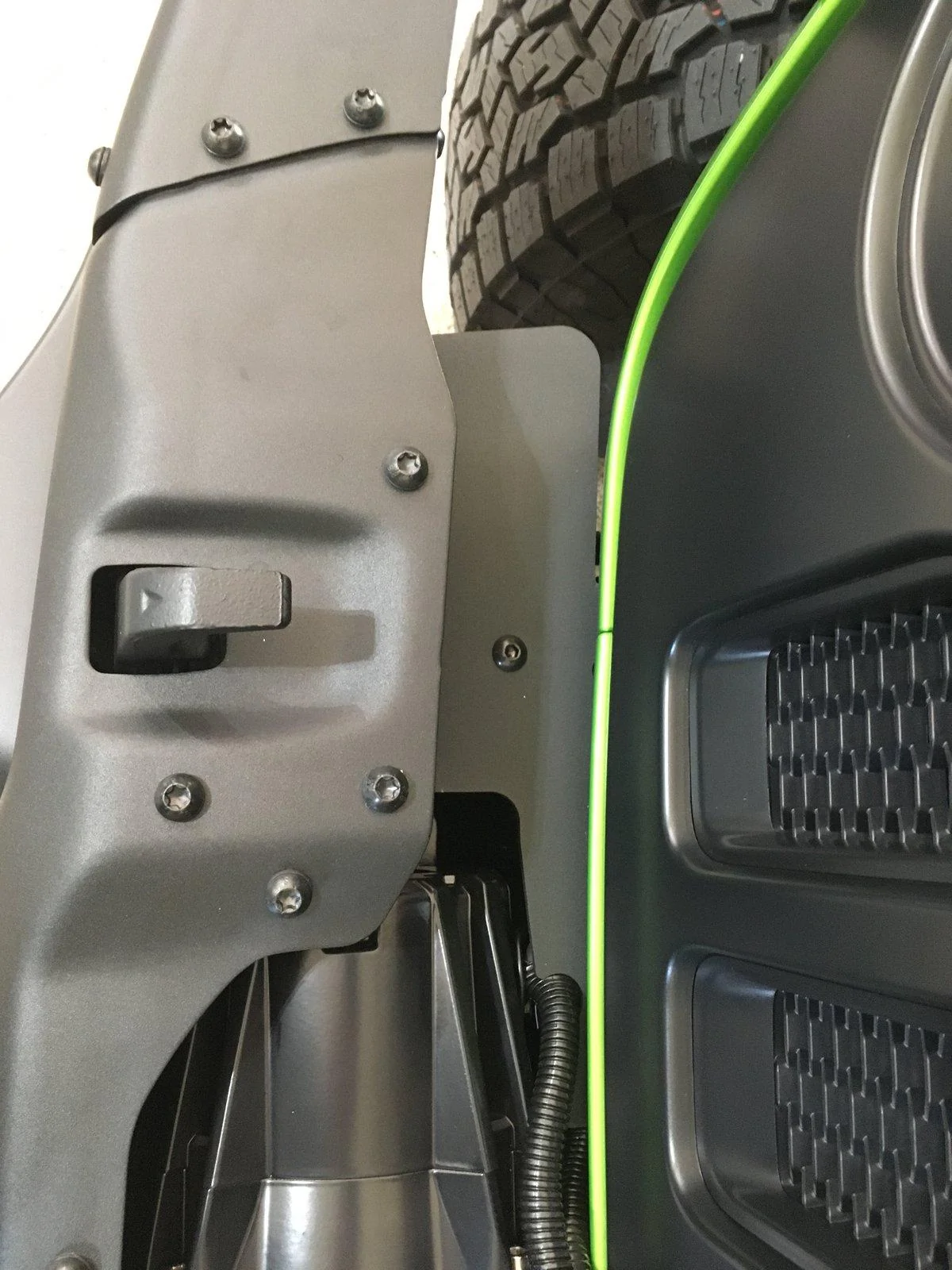

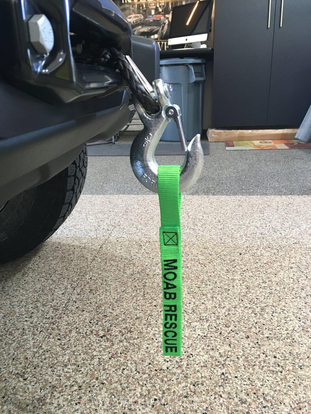

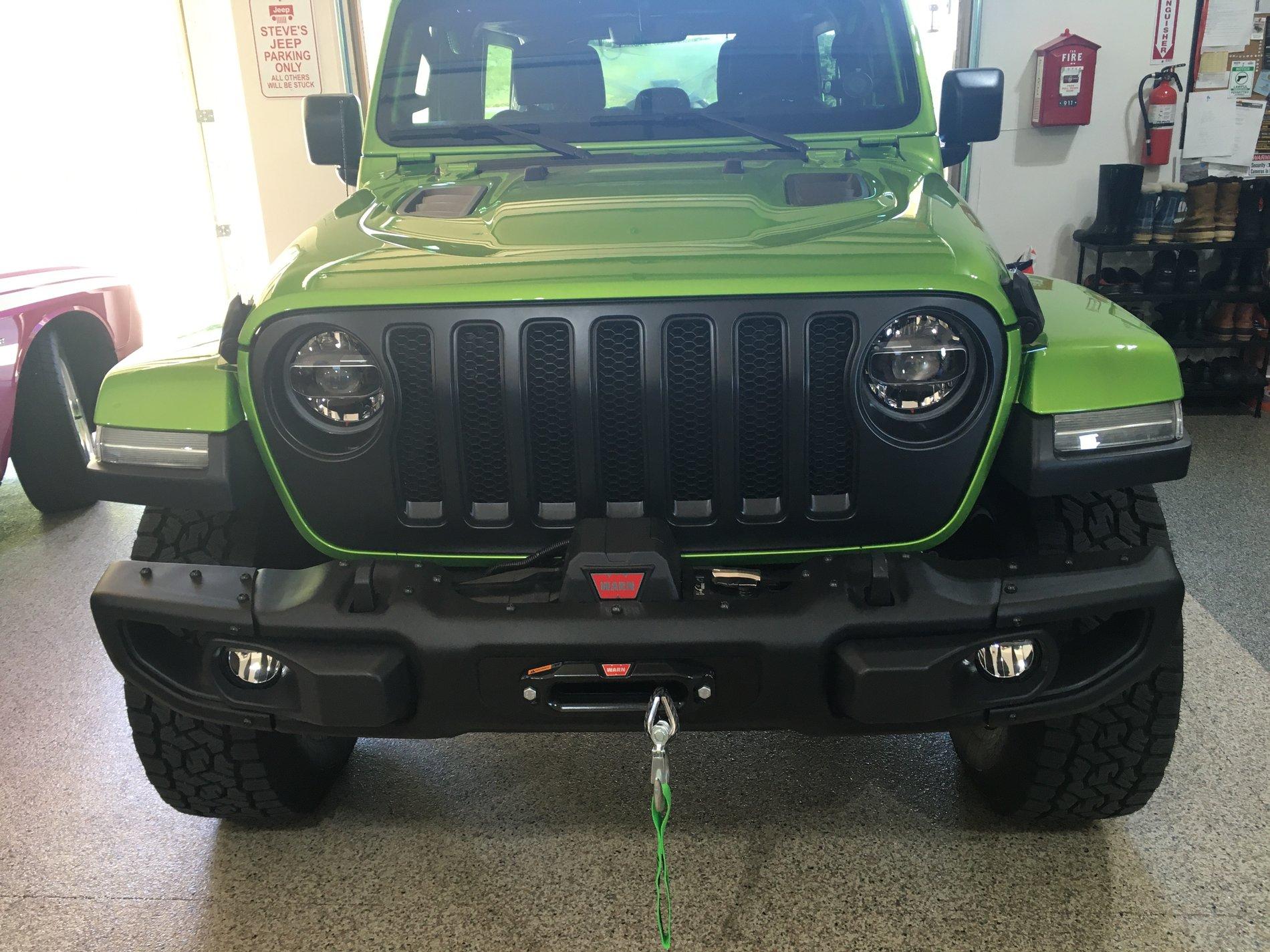

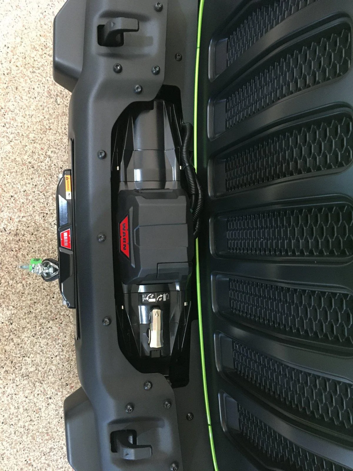

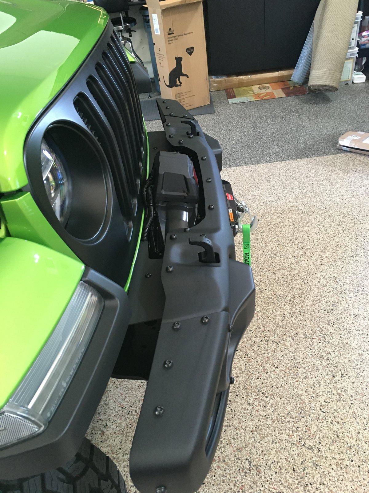

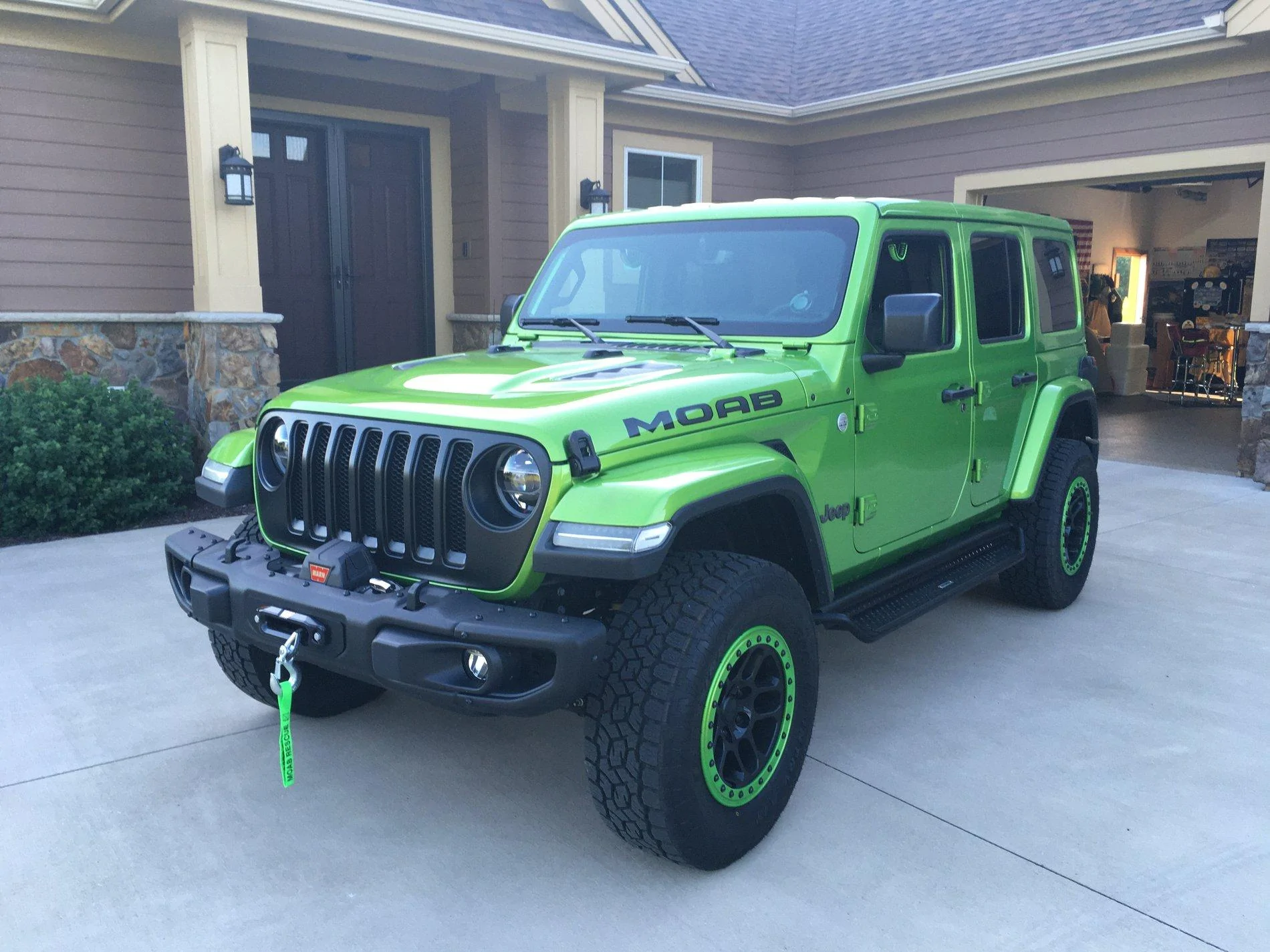

So here is the MOAB with the black grille, the Warn VR EVO (10k lb) winch, and Rusty’s winch plate all mounted up (on the MOAB factory steel bumper). I also contacted Maximus directly about the filler plate(s) because it was not clear to me which ones to use with the VR. The Maximus-3 Sales Manager (Ivan) advised me to use the “Zeon filler trim plates JL1017FZ.” Keep in mind, Maximus also sells a “Standard” JL filler trim plate JL1017FS (note the ”FS” vs “FZ” stock numbers). In some places on the Forum, people said the Zeon filler plate would not work with the VR. As you can see in the pics, it worked fine for me and install just requires the need to set a thread into the hole(s) in the chassis frame (top of the bumper) using a Maximus supplied thread-cutting bolt. Took about 15 minutes to mount the two plates (only because I had to hunt down a tool).
Keep in mind, between the Zeon and the VR, there appears to be a difference with cable and wire routing, and on the VR, as you somewhat see here, those cables and wires will be more prominent on top of the bumper. I covered most of them in black plastic conduit and pushed them as far back as I could behind the bumper.
Also, due to time limitations, I have not had the opportunity to build out my bracket and mount the Warn Power Interrupt Kit. Maybe next week.
Looks super clean, and the conduit cover looks good too. Did you do any measurements before and after to see if it dropped your front at all? I’ve read some guys are getting about an inch drop from the added weight. I ask because I’m considering different options for lifts/spacers.
DrPerez007
Nov 1, 2017
279
848
Wisconsin
See Signature
Public Safety & Legal Consultant
Best I can tell is maybe 1/2” to 3/4” drop, but that is not solid and I would not necessarily rely on it. My notes indicate that the Warn VR winch is about 73 lbs, Rusty’s winch plate 23 lbs, and the Maximus filler plates less than 2 lbs, so just pushing 100 additional pounds.
Lift is the “AEV 2” Spacer Lift for JL Wrangler.”
Hope that helps.

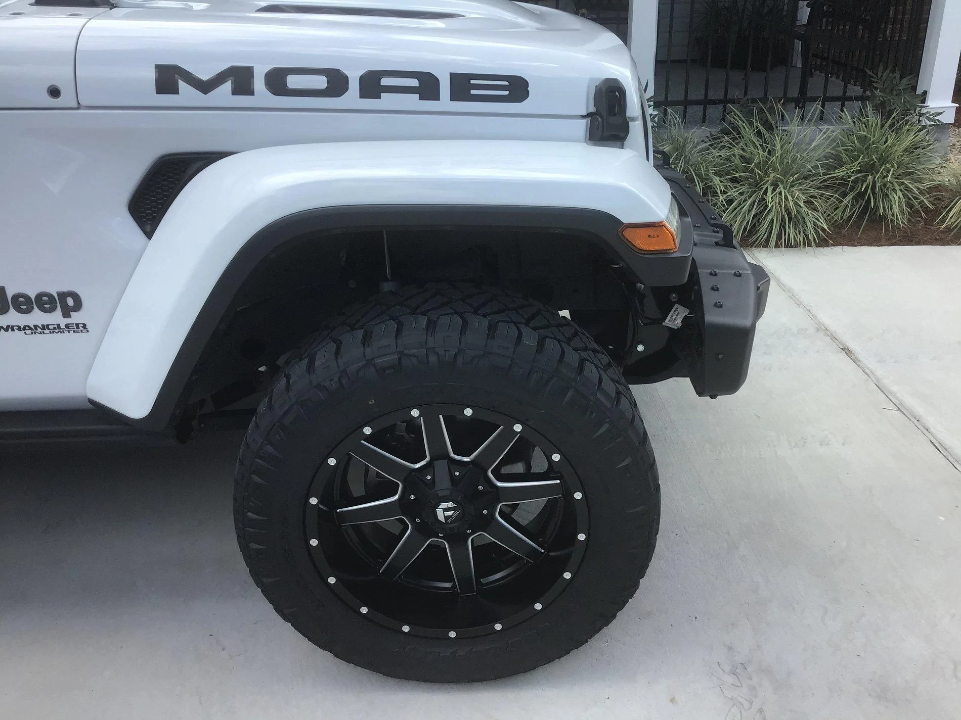

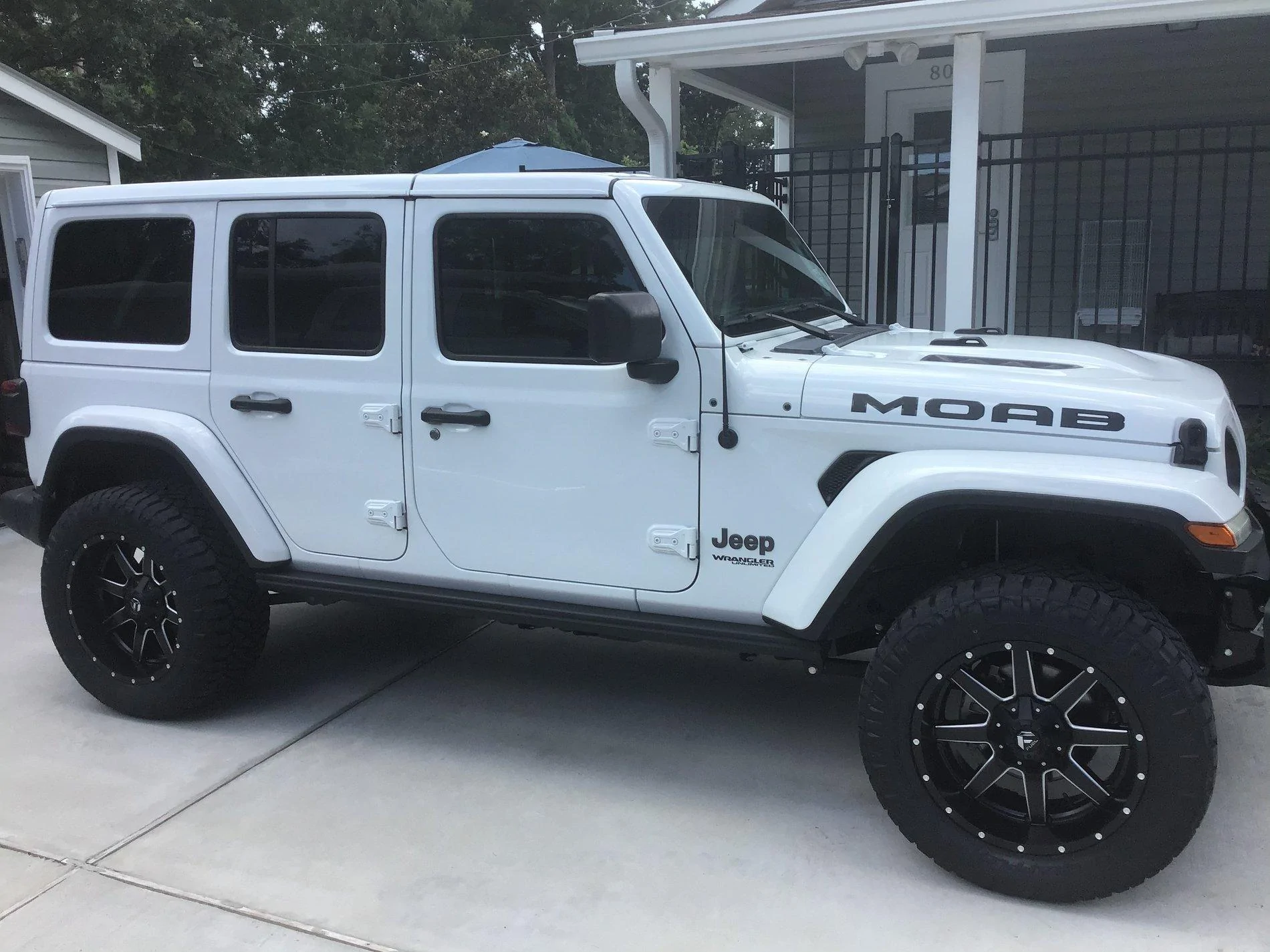

2019 MOAB with a 2.5” lift. Just put these 20x10 Fuel Mavricks with 305/55/20 Ridge Grapplers on it. I can’t get used to the look. Probably going back to 17’s. Still debating
Go 17s for sure
Obviously there is a lot of personal preference involved, I don’t think they look bad, but I prefer the look of 17’s. Which lift did you go with?
