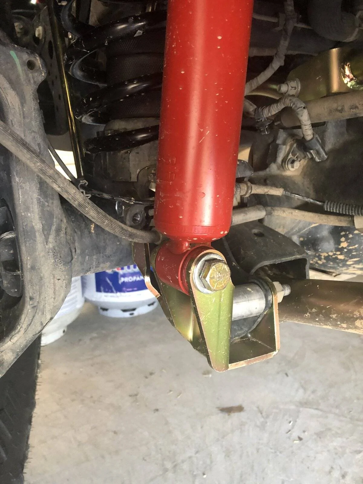

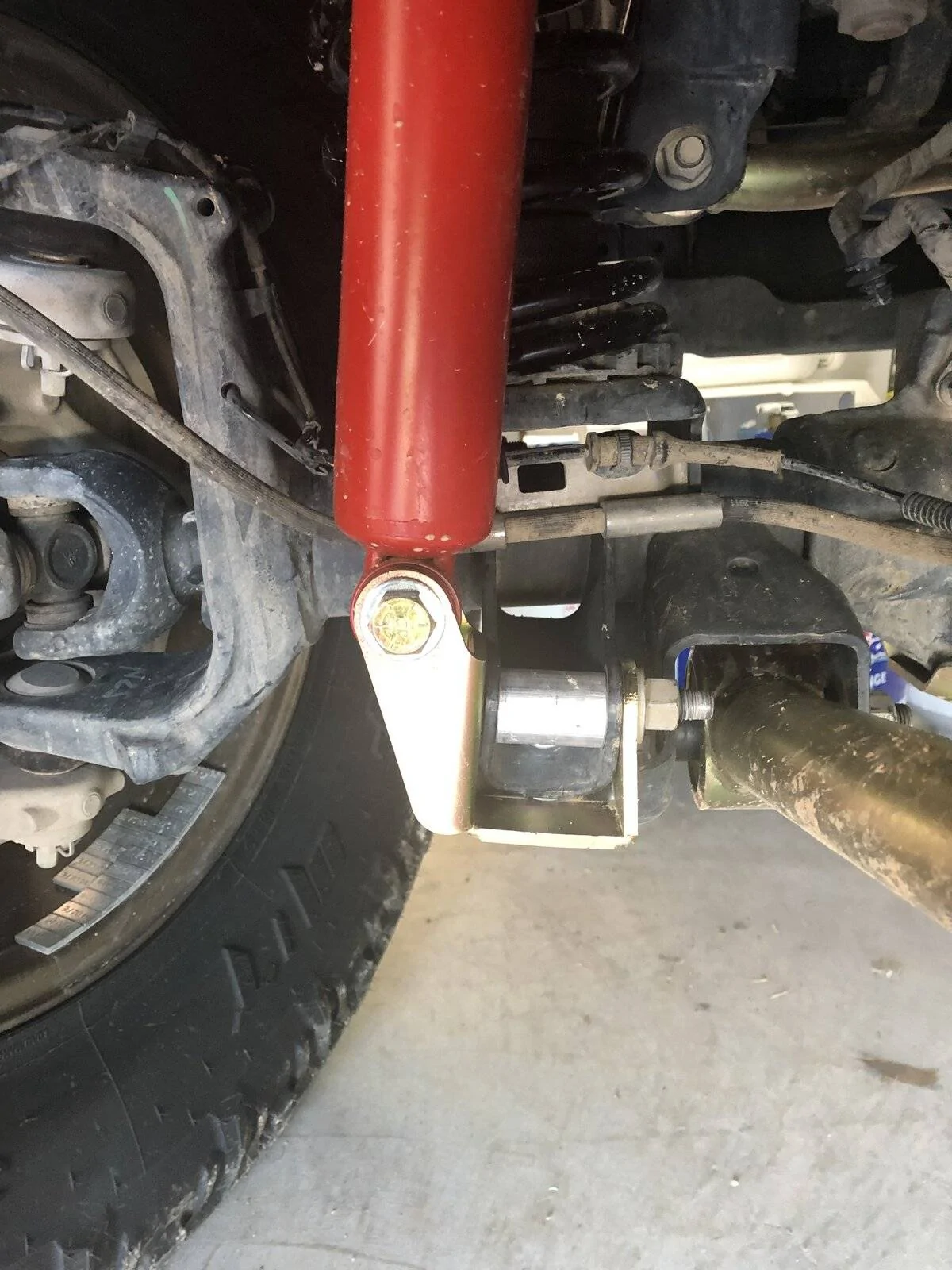

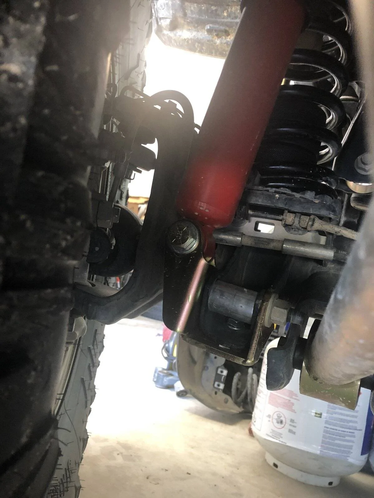

Does your brackets relocate the shock up as well as out ? The outboard shock mounts I’m talking about just relo out, and not up and out.
Yes up and out. Here are some photos for reference. Last picture is as close to full lock as I can get without someone sitting in the Jeep and holding the wheel.
Yeah that’s the difference, you see how close to oem shock mount yours is compared to these...
Well, maybe MC changed their design slightly or the gif is not 100% accurate to design. I'd be curious to find out.
