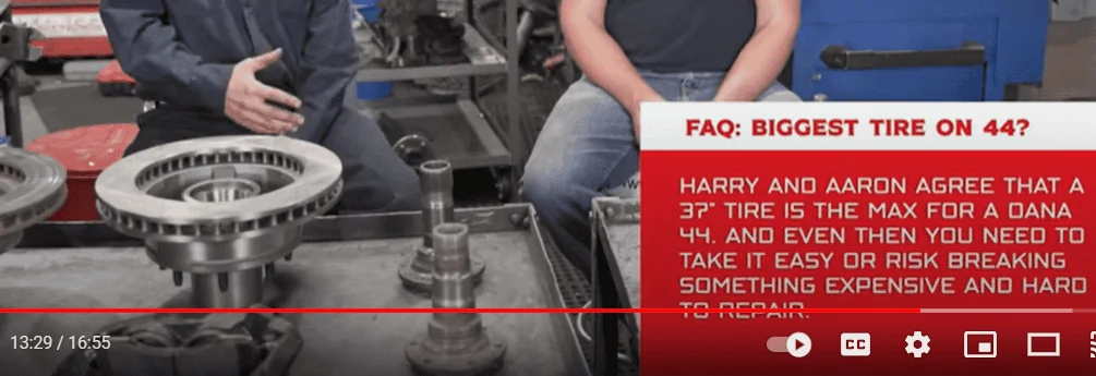

The majority of the off road community would disagree with you. 37s on a 44 is pushing its limits. Plenty of people blow up differentials with that setup. Can you get away with it? Sure. Is it strong enough for everyone? Far from it.
Exactly. It's not premature wear, it's breakage.

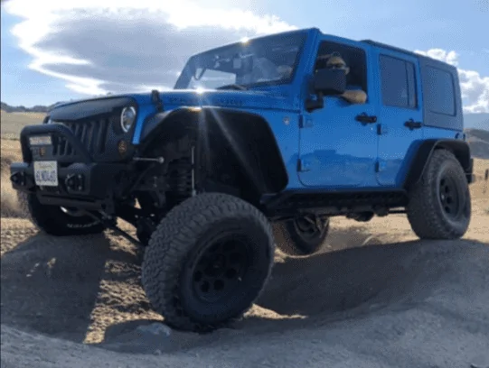

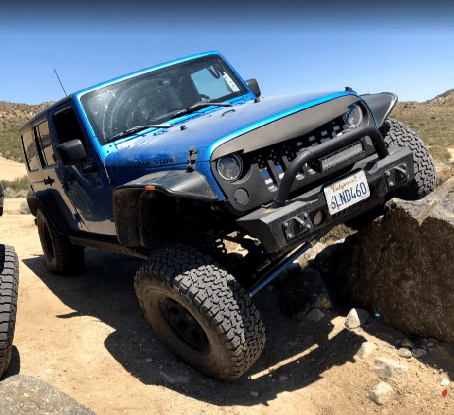

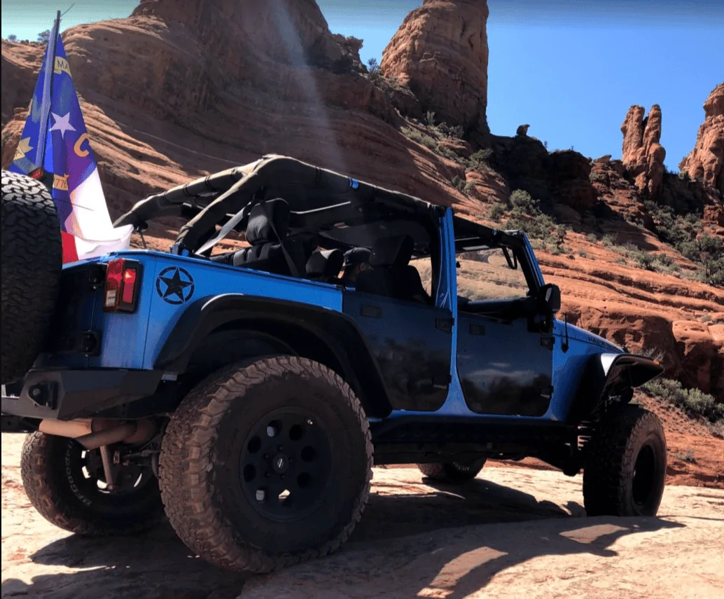

How you use/abuse it matters more than axle size. JK with over 200,000 miles with 37s and a D30:
Right, mild off road like those pics you can get away with it. 200K means nothing, it's not like vastly exceeding torque limits makes it wear out faster, components break as soon as you exceed torque limits.
