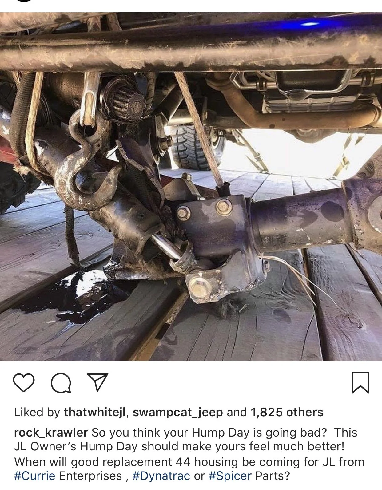

Guess he was going pretty hard on it. Must have been. I read it was an uphill section full of rocks. I think the tire he was running was 38x13.50

From that photo thought not knowing what happened but it looks like I keep the tube took a really good hit at the fad which caused the tube to break probably a cracked fad casting. This is not the larger the allowing the Jeep to go on more aggressive trails than the failure being a direct result of the tire size causing the problem.

A picture of one broken fad, which has a giant witness mark at the point of failure, doesn’t mean much. We have all seen videos of rock bouncers snapping Dana 80 housings. Impacts and shock loading will break anything if they are severe enough. If you want to jump your Jeep, truss it regardless of tire size. If you want to do full throttle assaults in Boulder fields, upgrade your axles. Even in the Jeep world, speed costs money. Slow and moderate, back up, stack rocks, or winch when needed, and the rubi axles will live a long life on 37’s. Wheel smart on stock axles or upgrade if you want to bash your way through terrain. I wouldn’t trust the stock axles on stock tires trying to rock bounce through little sluice (not to mention I wouldn’t bash the rest of the shiny new Jeep that way).
