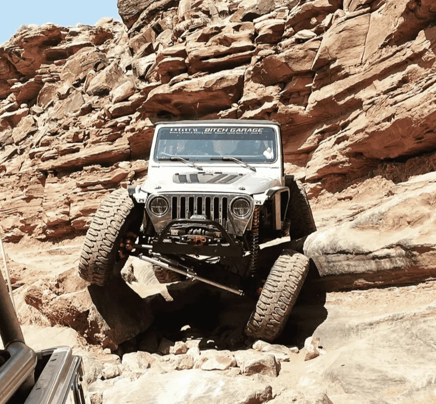

I would argue the JLR44 is just right on 37s. It's a more than capable axle than people give it credit for honestly.
My wheeling bud runs JLR44s in his heavy LJ on 40s. RCVs and Reid Knuckles.
But I understand if people want to immediately jump to a larger axle for ease.
