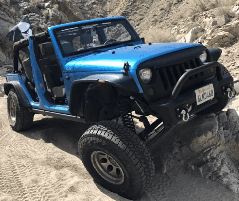

I mean I'd definitely want to see this D30 with 37s - it is hard to believe something like that wouldn't break
Ball joints don't last long with large tires but the only thing we have broke are the ring gear teeth because as I mentioned/warned before, when we put 5.13 gears (and had to pull the axle shafts anyway) we bought chromoly shafts to replace them. Pulled the stock ones and to our surprise and contrary to what the "internet" says, they were in perfect condition after over 100,000 miles on large tires. No twisting in the teeth whatsoever. We put in the chromoly shafts in and less than 6 months later the strength of the chromoly shredded the teeth in the dif. It's not completely the shafts fault becasue truth be told, 5.13 probably shouldn't have gone in a D30 but I much would have prefered to have the stock shafts twist or break before having to re-gear the difs again. My son drives it now. If you have Instagram look up @papa.surf I think he has over 220,000 miles on it now...still rocking the front D30.
Jeep Wrangler JL M200 axle strength?? 1654063894351
