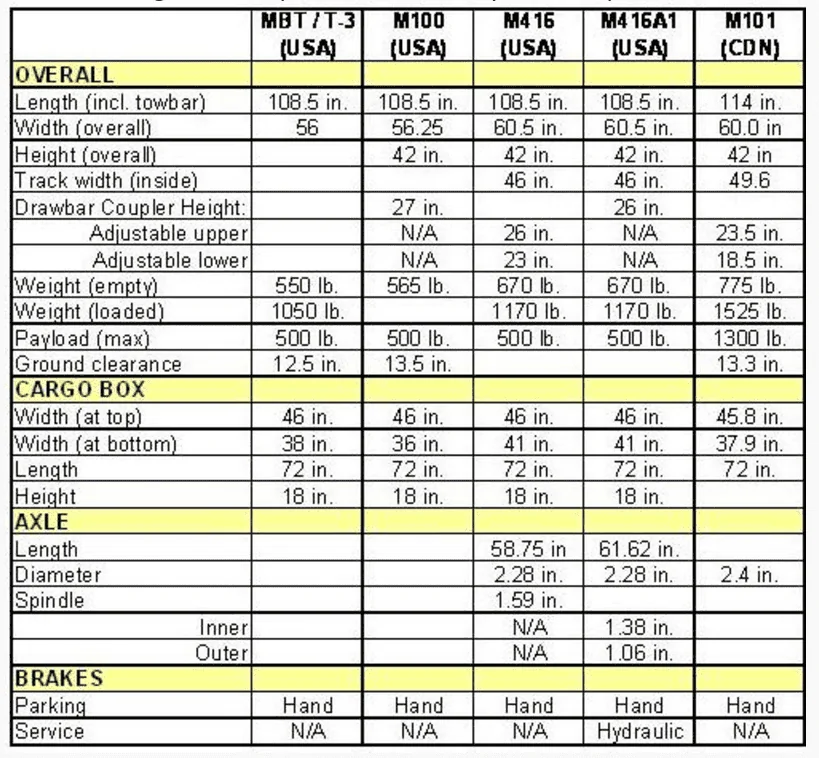

I'm always on the lookout for a small military trailer for my JLURD. I think the M1101/02 are too large. An M101 out of Canada look just about right.
They all have pros and cons! Keep that in mind because the 101 weighs more, uses leaf springs, no doubt will be in rougher shape due to age, I don't believe they have any brakes other than parking, etc.
They are more manageable in terms of outer dimensions, but once I have gotten used to this 1102, it really doesn't bother me. Honestly sometimes I forget the trailer is there when towing it.

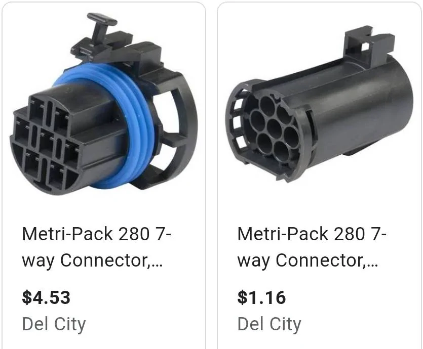

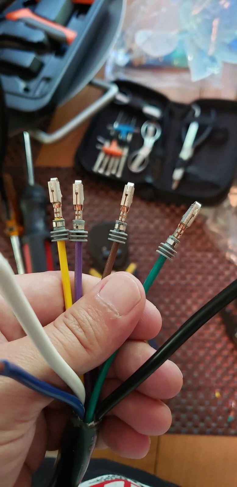

I too ran new wiring, converted the 12 pin to standard 7 pin. However I am kind of anal about how stuff is done and I bought a 4 point 8 indent crimper, solid pin deustch size 12 worked well, and the proper military packard connections for the 3 wires I needed to tie into for lights, ground is just a ring terminal and self tapper to frame. That way I didn't have to cut any wires on the trailer and my factory 12 pin can be re-installed in a few minutes. My tailer brake wire is capped and "dead" so to say until we electric convert, reverse wire goes to a hy-power diode then to trigger a relay for a set of harbor freight 3" flood lights mounted to rear of trailer, 12v+ goes to the relay that powers said harbor freight lights, and I added a manual switch that goes into the other input end of the hy-power diode to manually trigger the relay for the reverse lights for camp setup lighting(diode stops backfeed into jeep).
I did however install a 7 pin metripack 280 connector in between the 7 pin trailer harness and the trailer itself. That way if my plug ever gets damaged from coming disconnected and dragging, or whatever, I can quickly replace it by crimping a few metri-pack terminals and wire seals on. Then it just is a simple plug to connect up to the trailer, all perfectly water proof.
