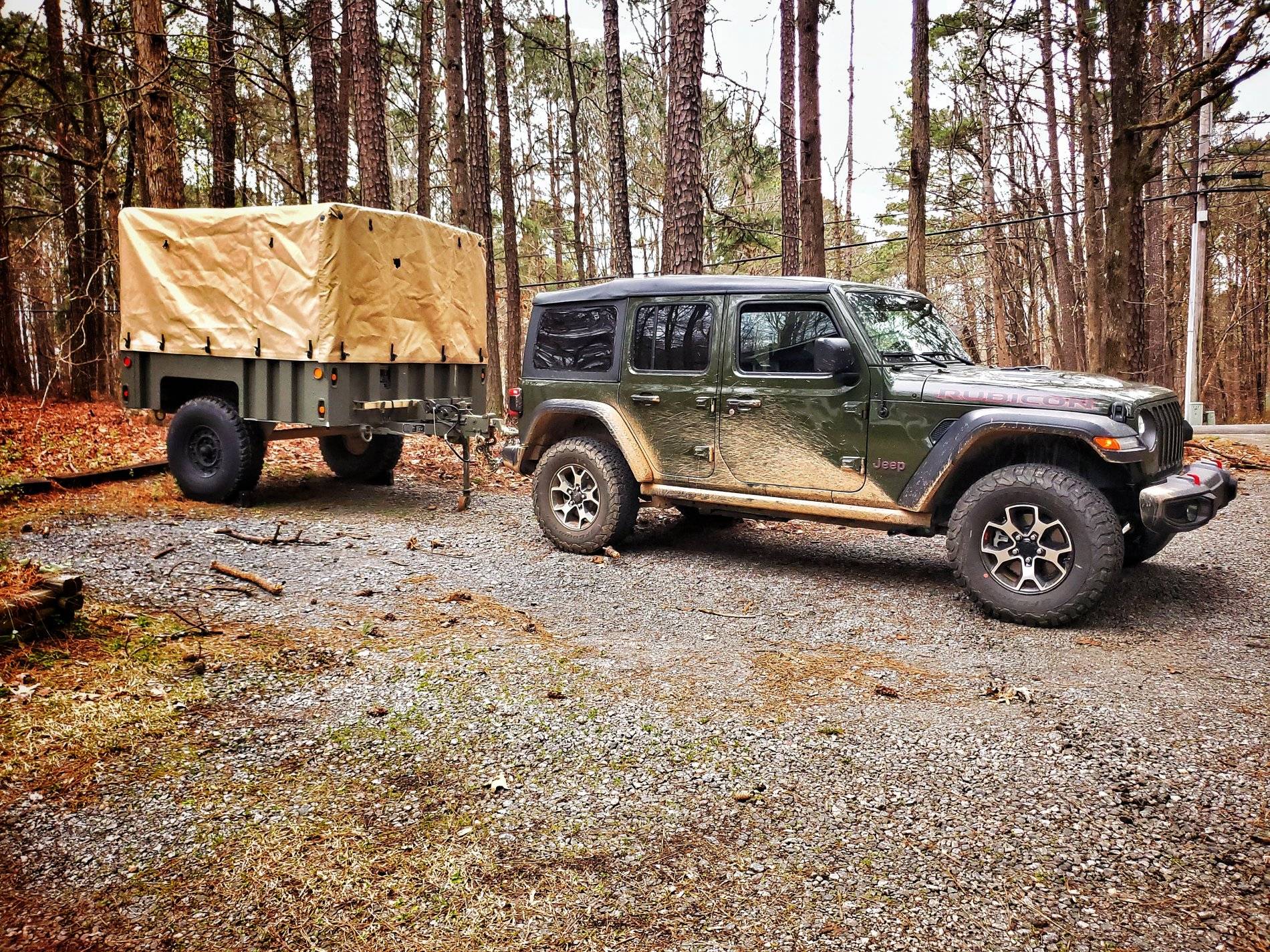

Just picked up an M1102 trailer to modify into an overland/camping setup for the wife and I. This thing is gonna be fun, but its going to take quite a bit of time and some moolah to make happen.
2009 build that is in fantastic shape, looks as if it wasn't issued or if it was it saw little use. It was supposedly painted for use in a movie, from its original desert tan color, and we will probably repaint the exterior to match our sarge green rubicon that is on order but line-x the bed area. We will end up building a rack to throw a RTT on it, and a pull out kitchen in the back eventually.
I am either going to fab a new drop lunette that retains the hydraulic surge brake, or convert to electric over hydraulic and ditch the surge brake setup. Not sure yet as it really depends on how long we plan on keeping it or how well if it fits our needs.
This thing is so ridiculous but so cool at the same time🤣

I have one, great trailer if you need to haul heavy stuff. There is a 7500# axle under it, so they ride rough without a ton or two of weight in them.
I converted mine to electric brakes. Direct bolt in. Also swapped the lunette out for a standard ball hitch, which is also easy to do. I've considered converting mine into a camping rig, but IMHO the axle would need to be swapped out to a lighter unit to make it truly practical. FWIW.

Completely agreed. Already have my 3500lb dexter torflex axle measured out and spec'd. In all reality it would only be another $375 over just converting the 7k axle to electric.
I'm probably going to go with a cruisemaster do35, or if I have to settle it'll be a max coupler. For our first go round she'll be standard with new wheel bearings/grease/and actual proper bearing preload, and probably about 1000 pounds of payload. Still barely scratching the surface and I expect it to be a bit bumpy. Not going on any remotely sketchy trails with it till I ditch the lunette/pintle though.

As I stated, progress would be slow. Mainly because we just picked our Rubicon up and that down payment hurt😂 Took it out yesterday to break it in on some N GA trails. Cant bring myself to wash the fun off yet
Got all new OE military trailer lighting, and added a license plate light. Crimping military "packard" connectors without the very specific crimper is a whole lot of fun.
Scored a military "vehicle boarding ladder" so the wife or I don't take a digger getting out of the trailer.
This package is going to look so great, IMO of course, once I sarge green paint match the trailer. Just kind of wish I went with the tan soft top now.
