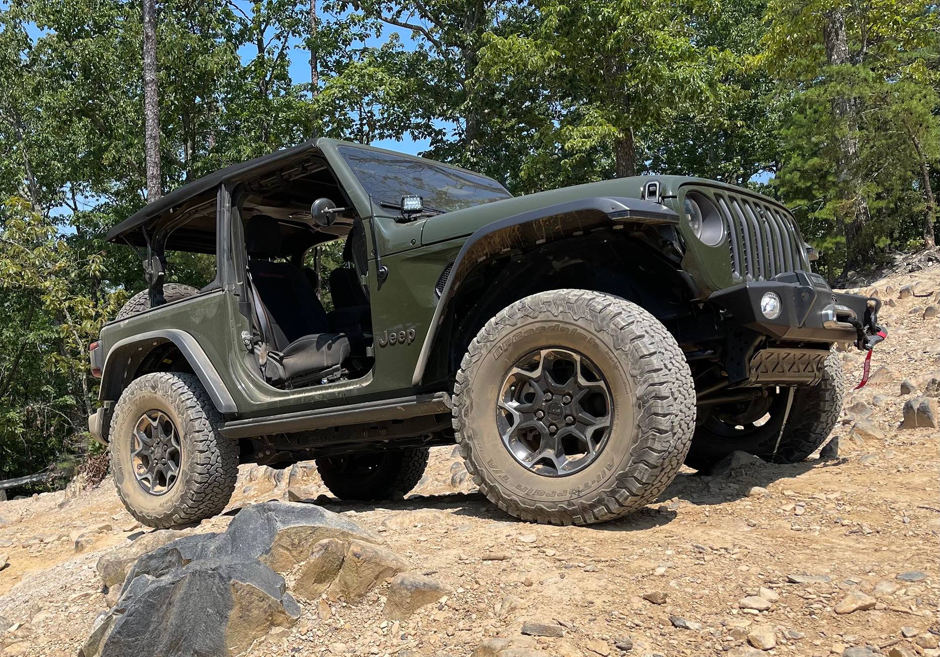

I went with these
https://www.amazon.com/Coyote-Wrangler-Gladiator-Removal-Replacement/dp/B085Z3699Z
Simply because they are fast to swap out and they do not vibrate like crazy. They attach at the same point as the ones you like, except you leave the bracket on the jeep with doors on and simply loosen the nut and pull the mirrors off when you want the doors back on. A little pricey but well worth it. They didn't have the A-pillar mount ones when I bought these or I might have been tempted by those.

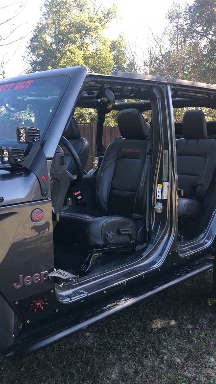

Off Topic, but the red coloring on the side of your Jeep with the badge and also the Jeep wording, did that come with the Jeep or did you add that? And if you did add it, where did you get it if you remember? Thanks!
That red comes standard on Rubicons. The Rubicon word is gone now and I will be popping off those red accents you see and going to black accent ones as soon as I take time to find them. When I do these will be for sale cheap.

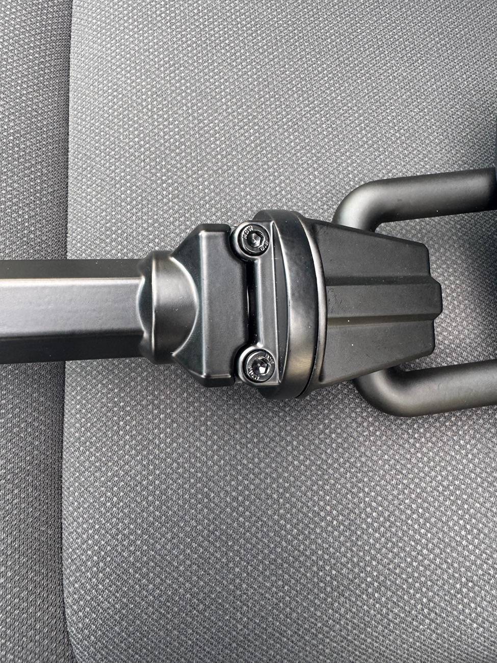

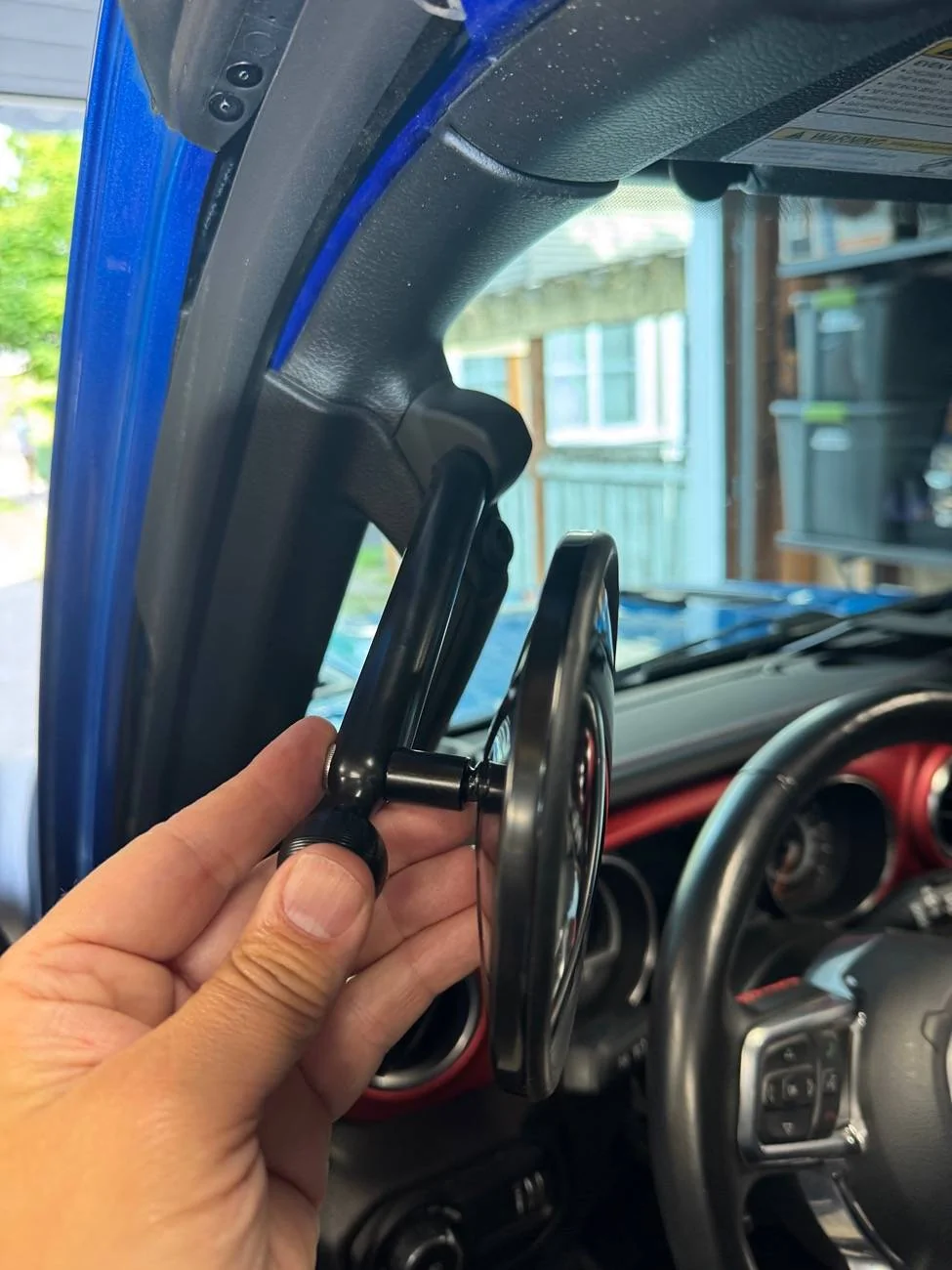

I also purchased these but am yet to use them. Closest setup I've seem to the CMM at a much cheaper price.
Just got finished setting them up. So far they seem legit. I have to go on a drive to make sure but we have a storm rolling in so I had to put my cover on. If you have one that won’t stop rotating 360 degrees take off the 2 allen bolts and that bracket separates from the other half. There is another allen bolt in there that needs tightened. Materials seem like good quality and will last. Time will tell. I’ll get more pics tomorrow of them on and update how they do on the highway.

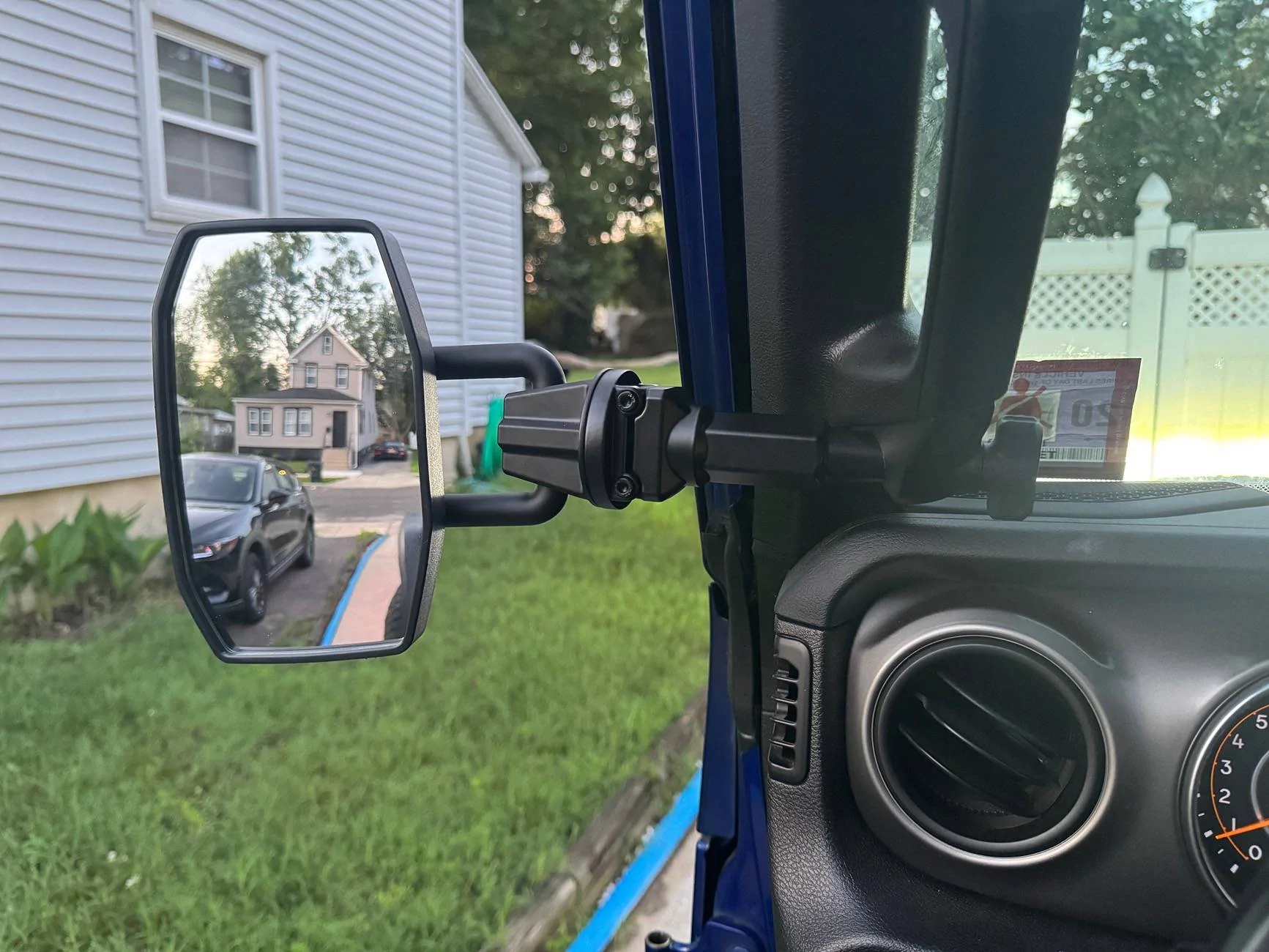

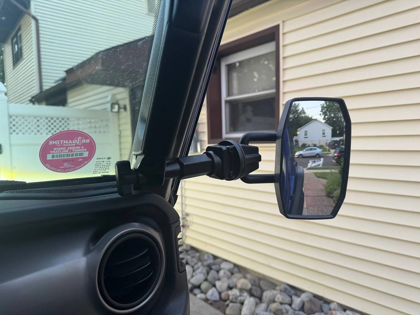

Update as promised. Mirrors are the real deal. No vibration at all at 80mph on my way to work. Easy on and off once initial setup. Highly recommend these mirrors at this price.

Looks good, thanks for the review. I have the mounts installed on my grab handles but put them on top. After seeing your pics I think I'm going to switch to the bottom.
