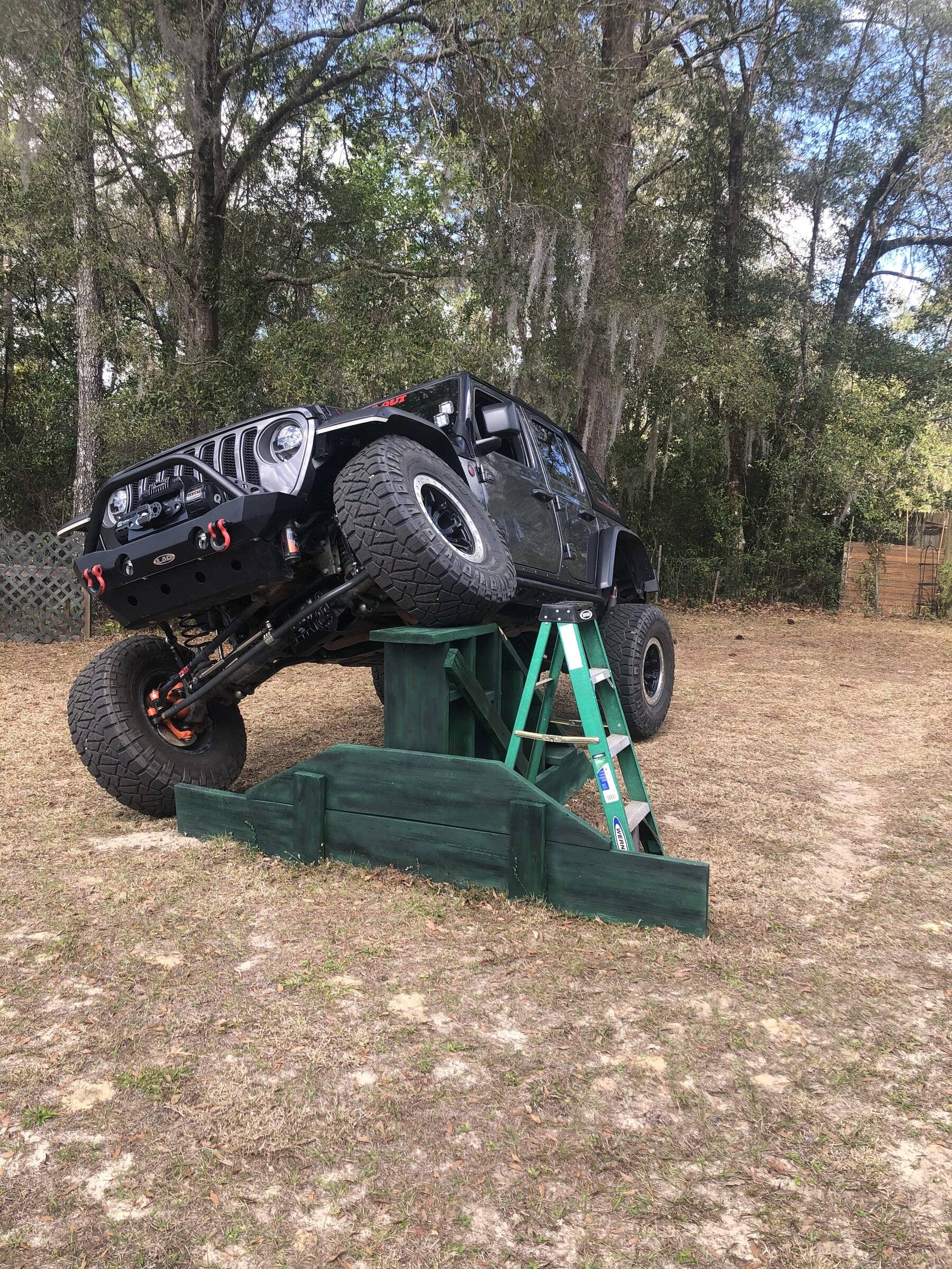

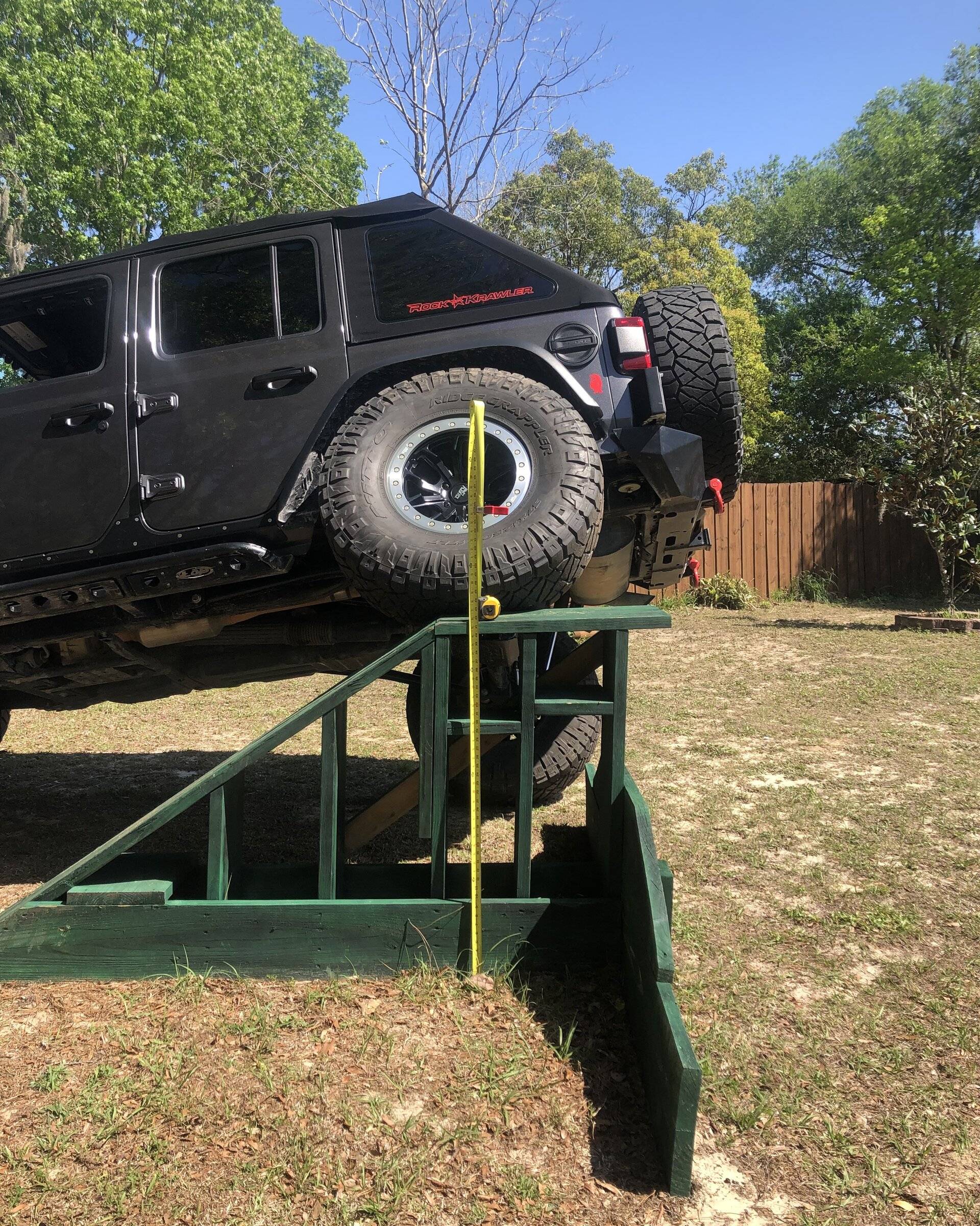

Yeah Kevin’s got an awesome build for sure…..I can’t compete with his 5-7K shock package……best I can do is 42”….. and when you’re old like me you have to use a ladder…….?
