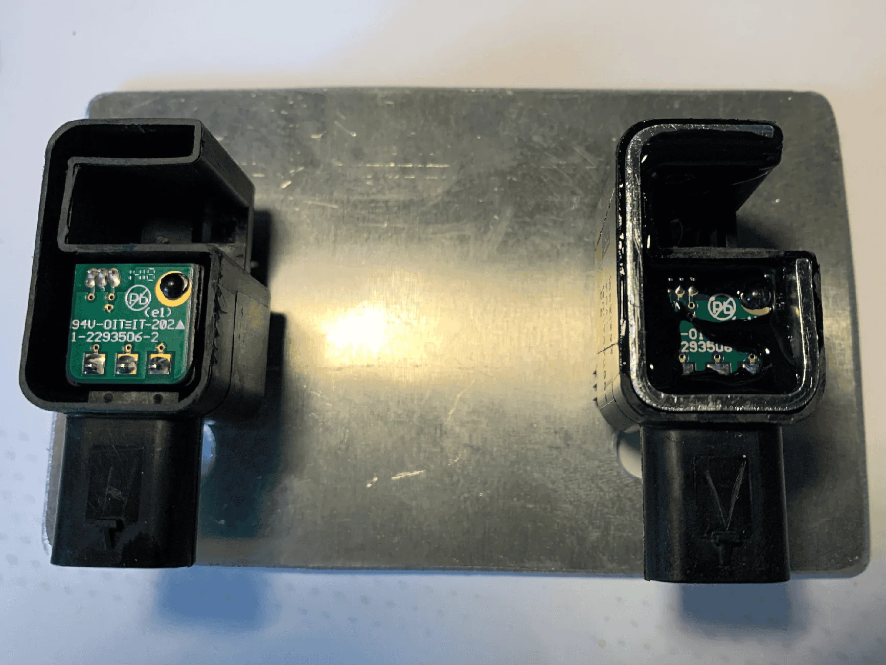

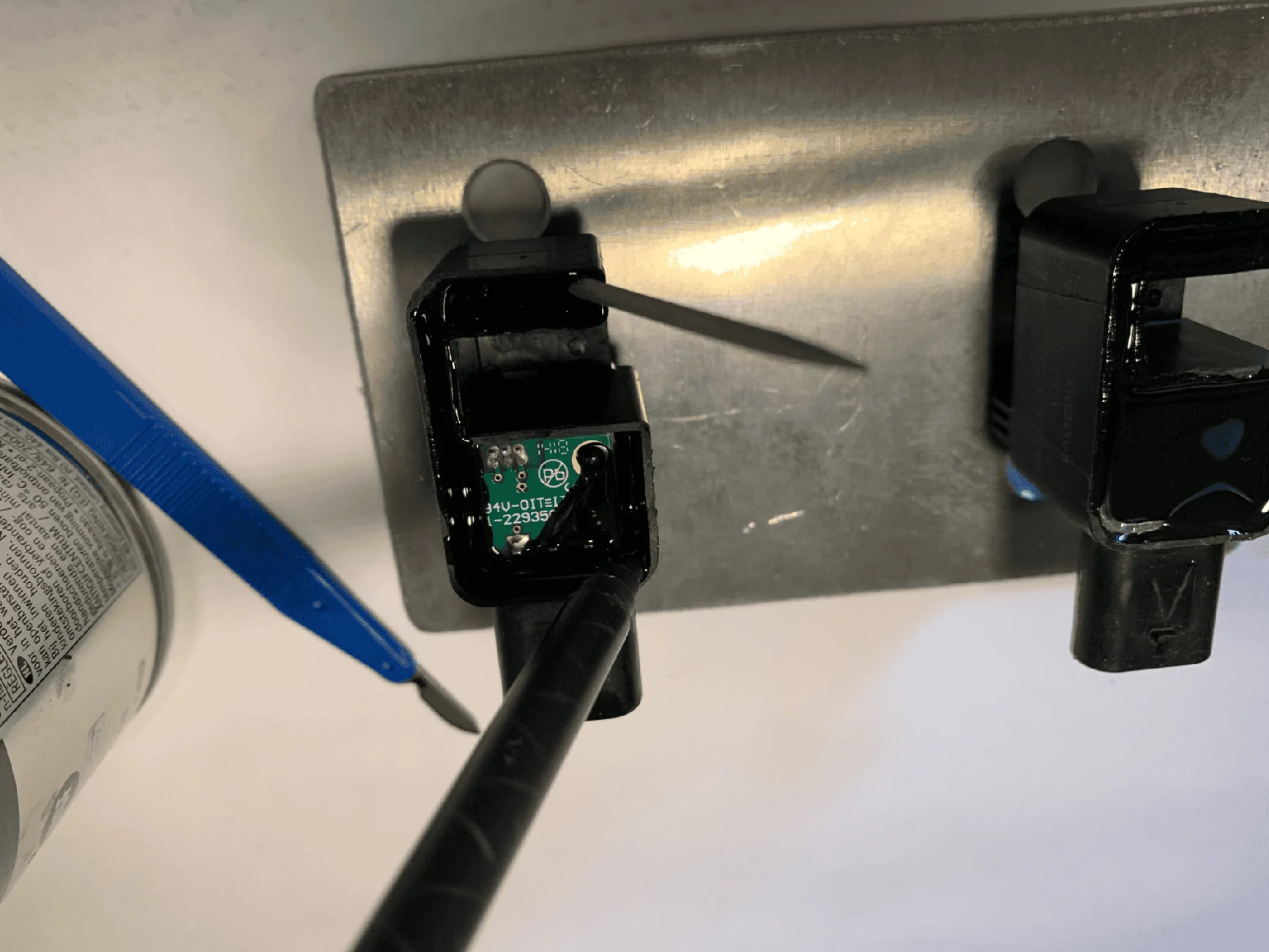

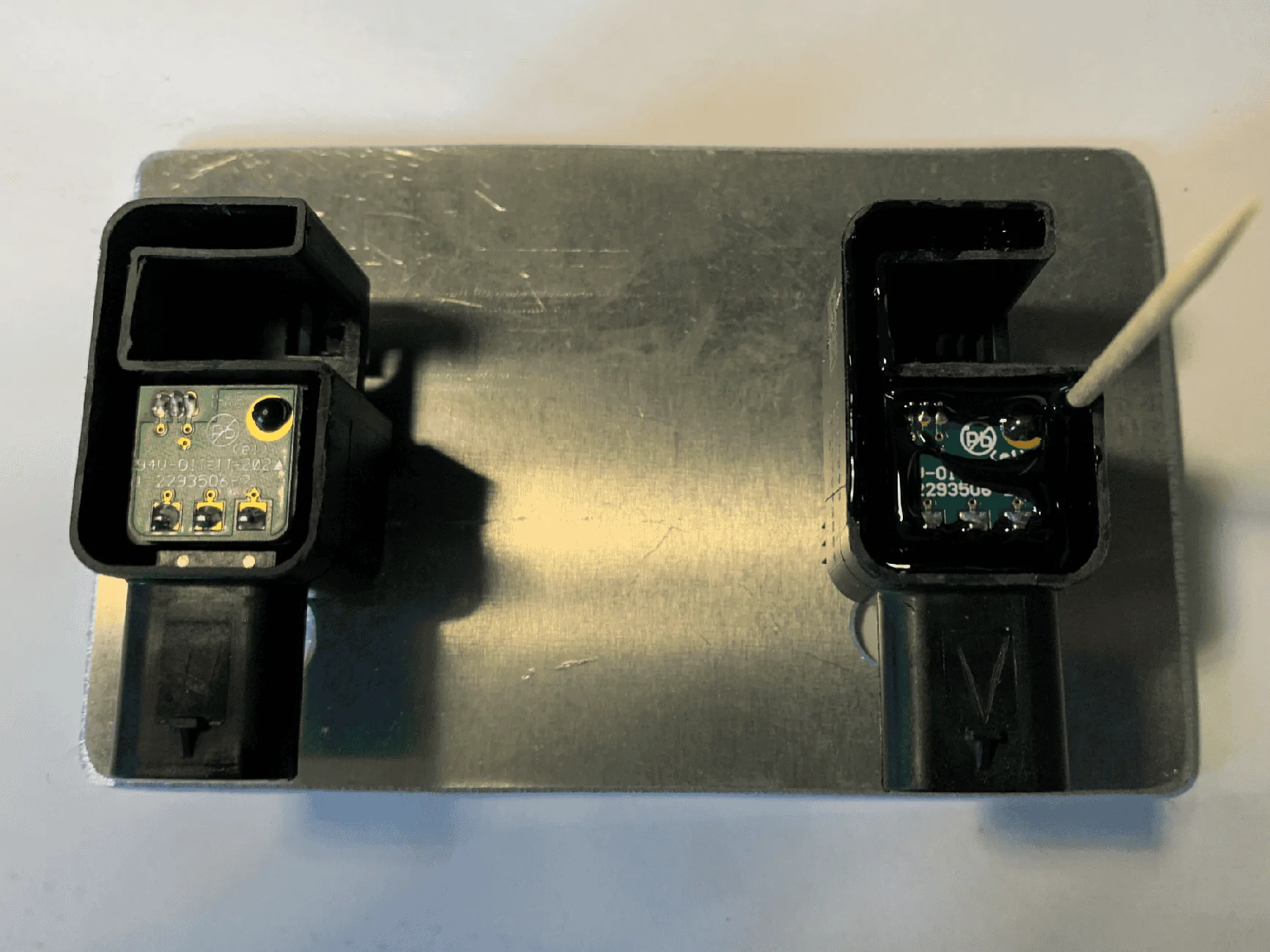

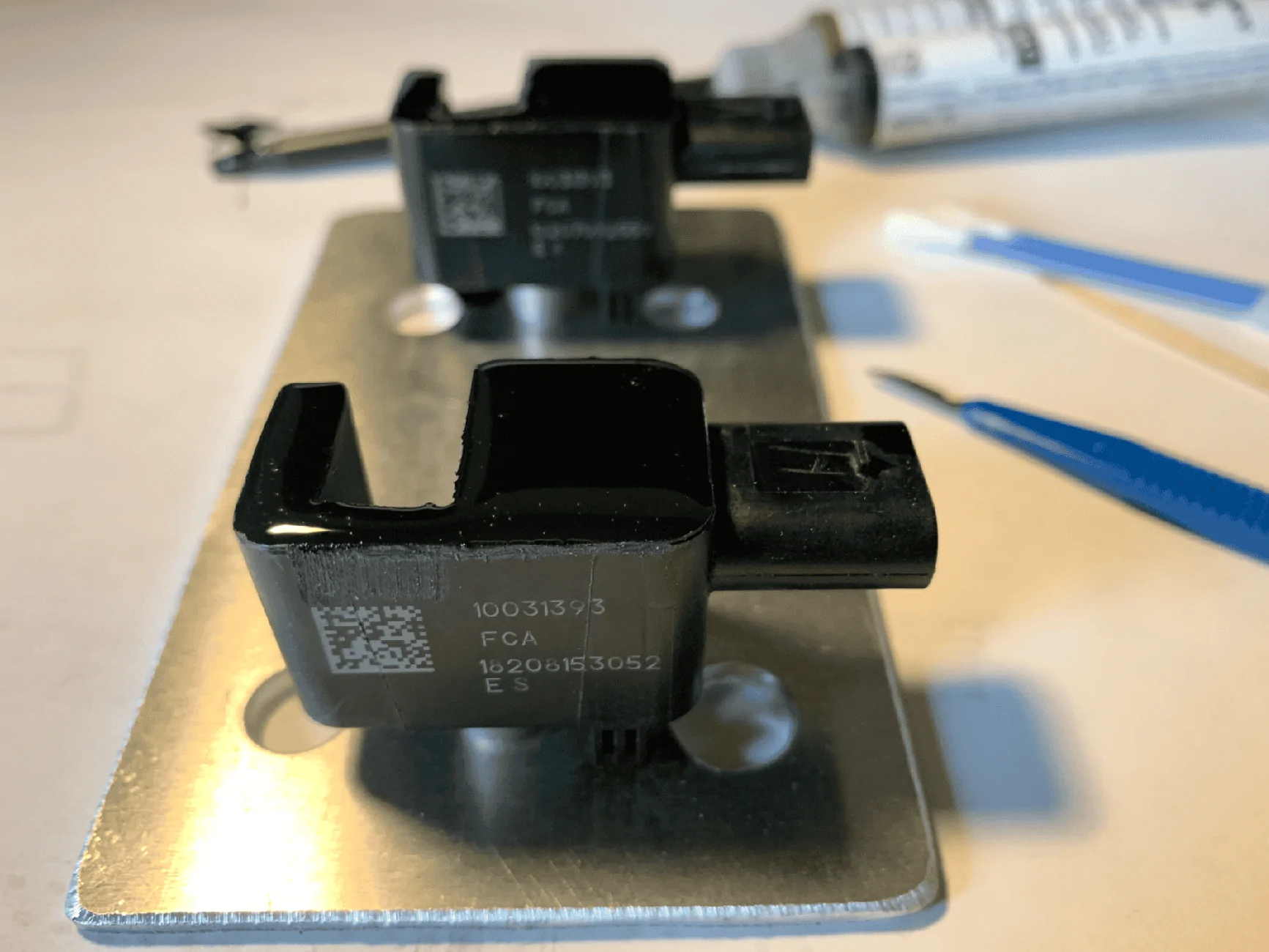

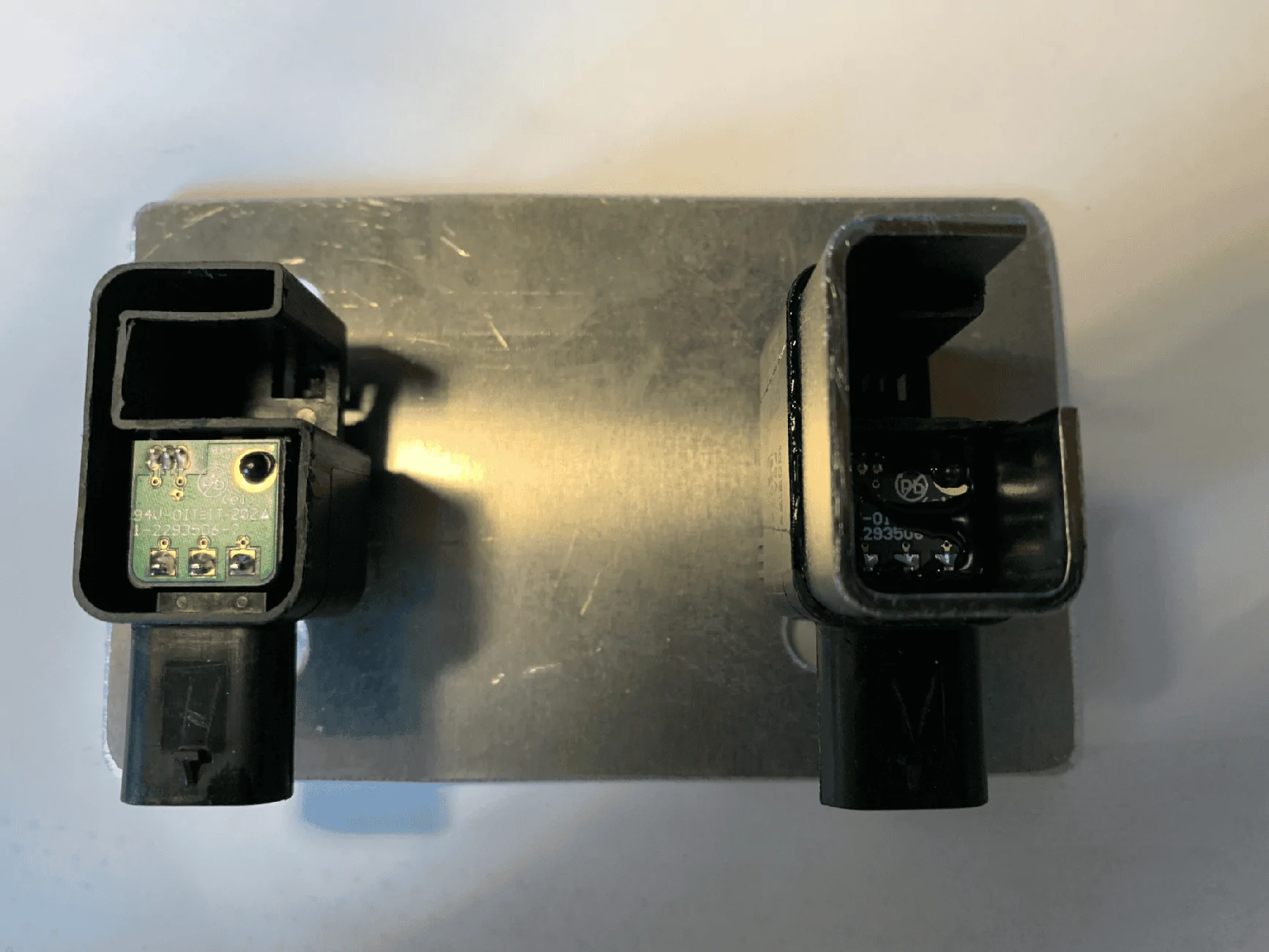

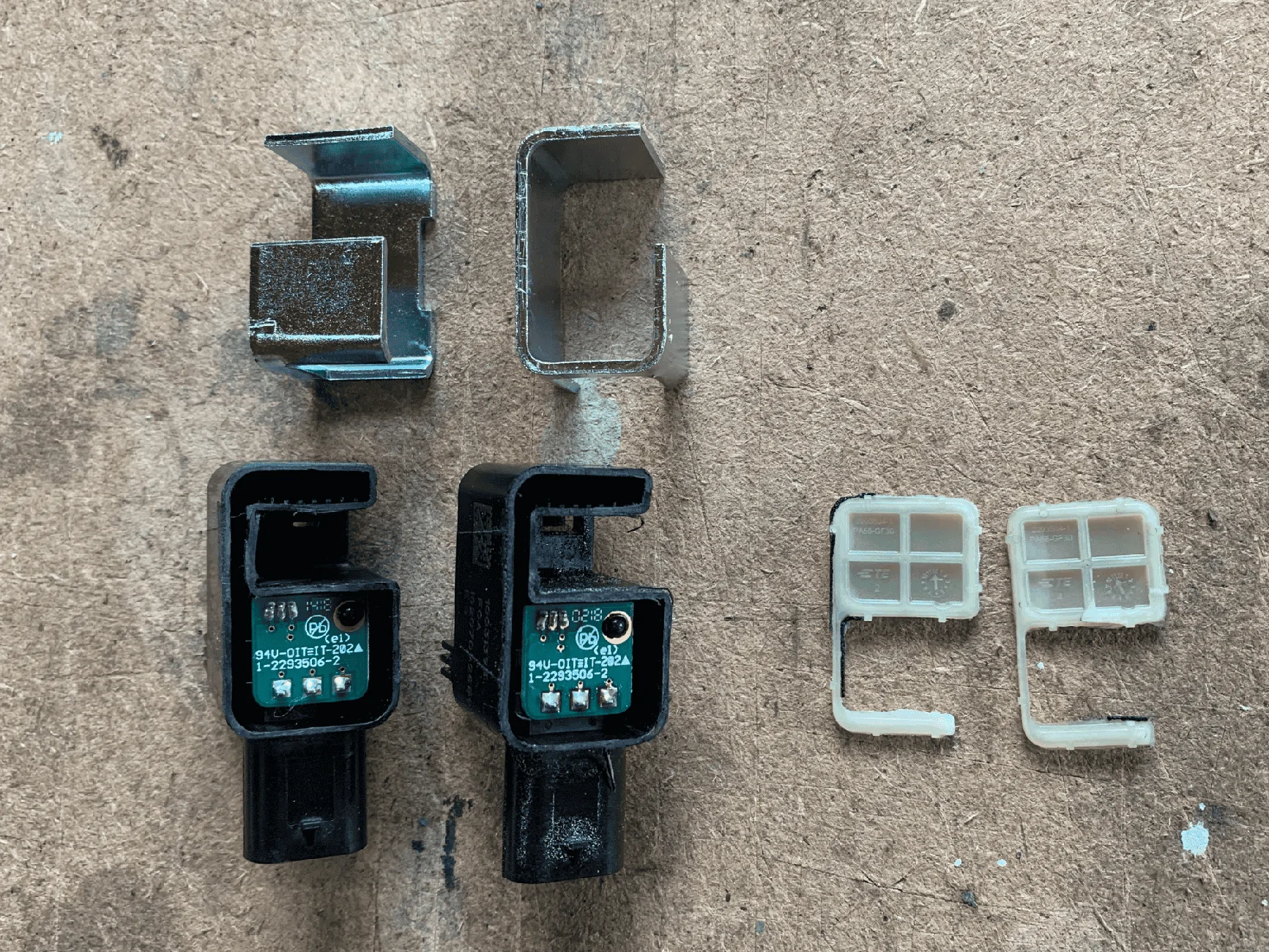

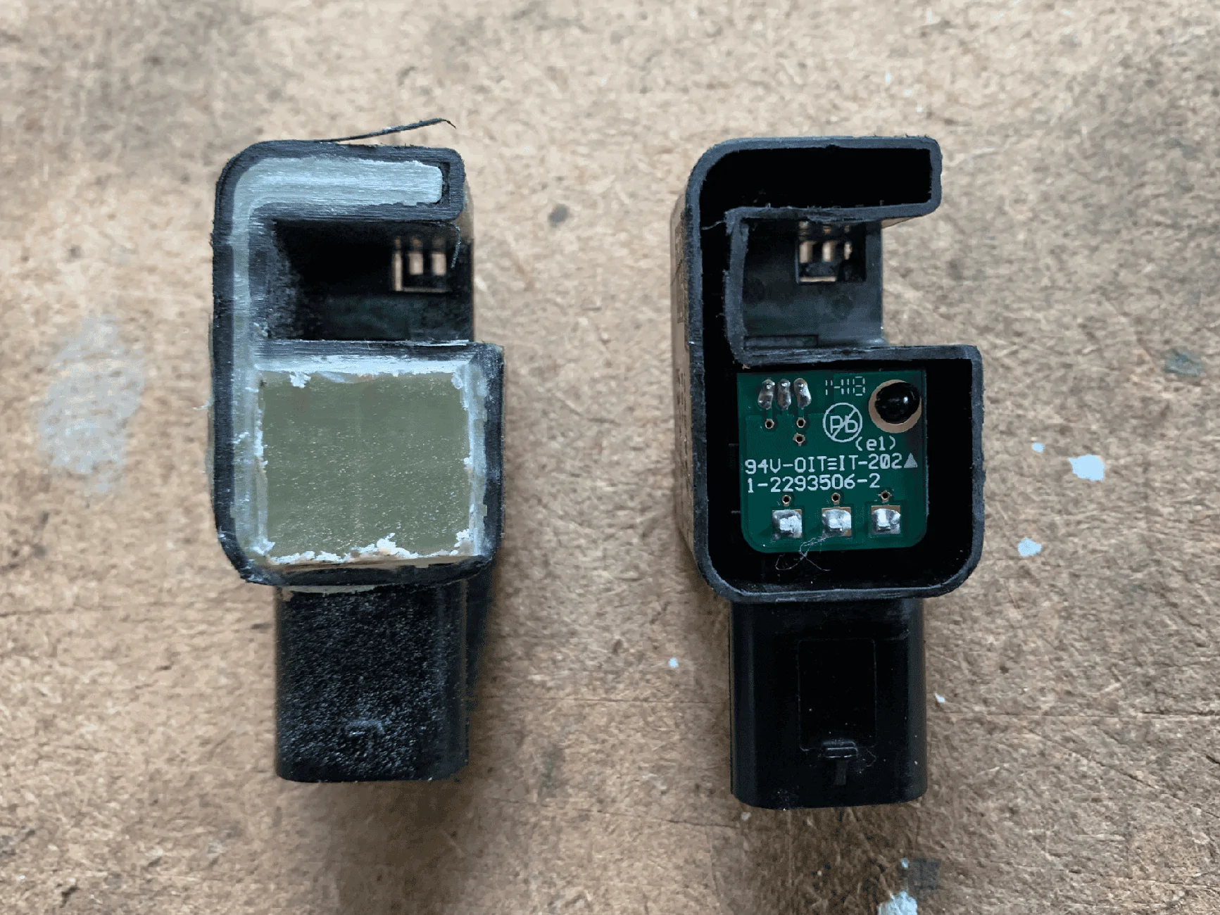

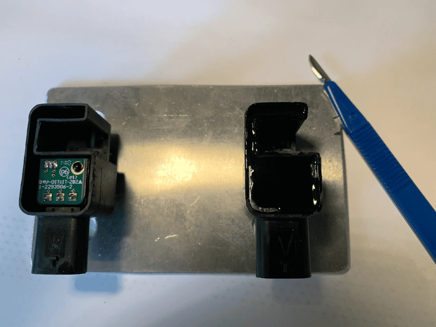

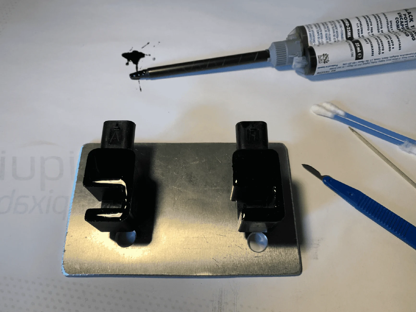

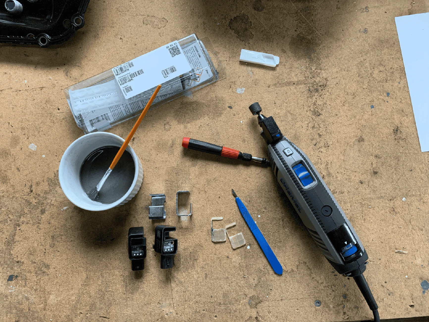

Hello Jeep Forum.
I've been reading your forum for years and have now registered here. I wanted to say a big thank you and share my experience.
In November 2020 my rear sensor failed and I found this description here. Since the Jeep dealers in Germany have little idea about the Wrangler and the service is usually a disaster, I do it myself.
Without this post I would probably never have solved the problem. After all these years and 70,000km further I can say that doing it was a success. Since then no more errors and everything works. I did a few things differently, you can see them in the pictures. I separated the cover from the sensor with a Dremel and took out the clamp. Then shed the sensor halfway and pushed the clamp back in. Then fill the sensor up to the top.
Everything else I did as shown here by the creator. Both sensors already had oil inside. After disassembling, I washed everything with electronics cleaner.
The sensors have worked without problems since then. I was traveling in a jeep in Africa in the Sahara at 50 degrees Celsius in the shade. And another tour was to the North Cape in Scandinavia in temperatures of -40 degrees Celsius. These temperature differences have no effect on the casting compound either.
Many thanks to all contributors and creators.
Excuse my English.
Greetings from Europe

BTW, that piece you called a "clamp" is the part that forms the magnetic poles of the hall effect sensor.
