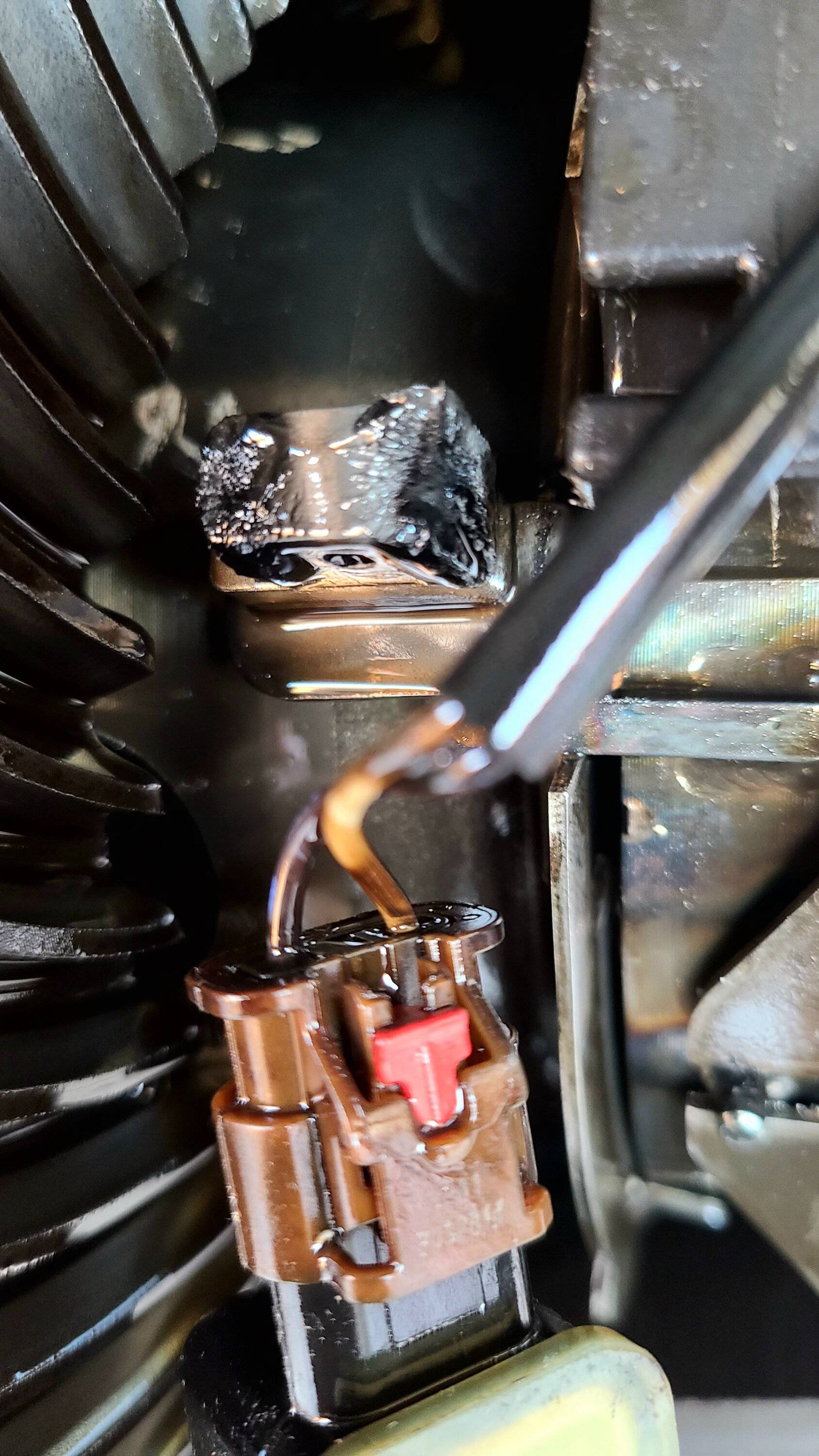

Had mine replaced once already... Went again. This time I think I'll have to fix it myself as I've had gears added.. I'm guessing fca are unlikely to warrant it even under warranty miles..!?
Anyway sensor "looks" ok. Have ordered potting mix. Will clean up and test, then pot if all good.
Note the huge amount of metal on the metallic sensor arm...!

By the way. I didn't have to take the cap off to get my torx bit on there and take the sensor out.

If you’re already throwing codes potting your sensors will likely do you no good as it’s too late. You may still be able to get them replaced under warranty. I doubt many dealers techs will know you have gears.

You are right. It's bad.
Plus the locker actuator is ill too now.. Slips in and out, rattles.
Booked in for warranty..
These lockers and sensors are pretty feeble. Mind you is done plenty of 8 and 9 rated trails.

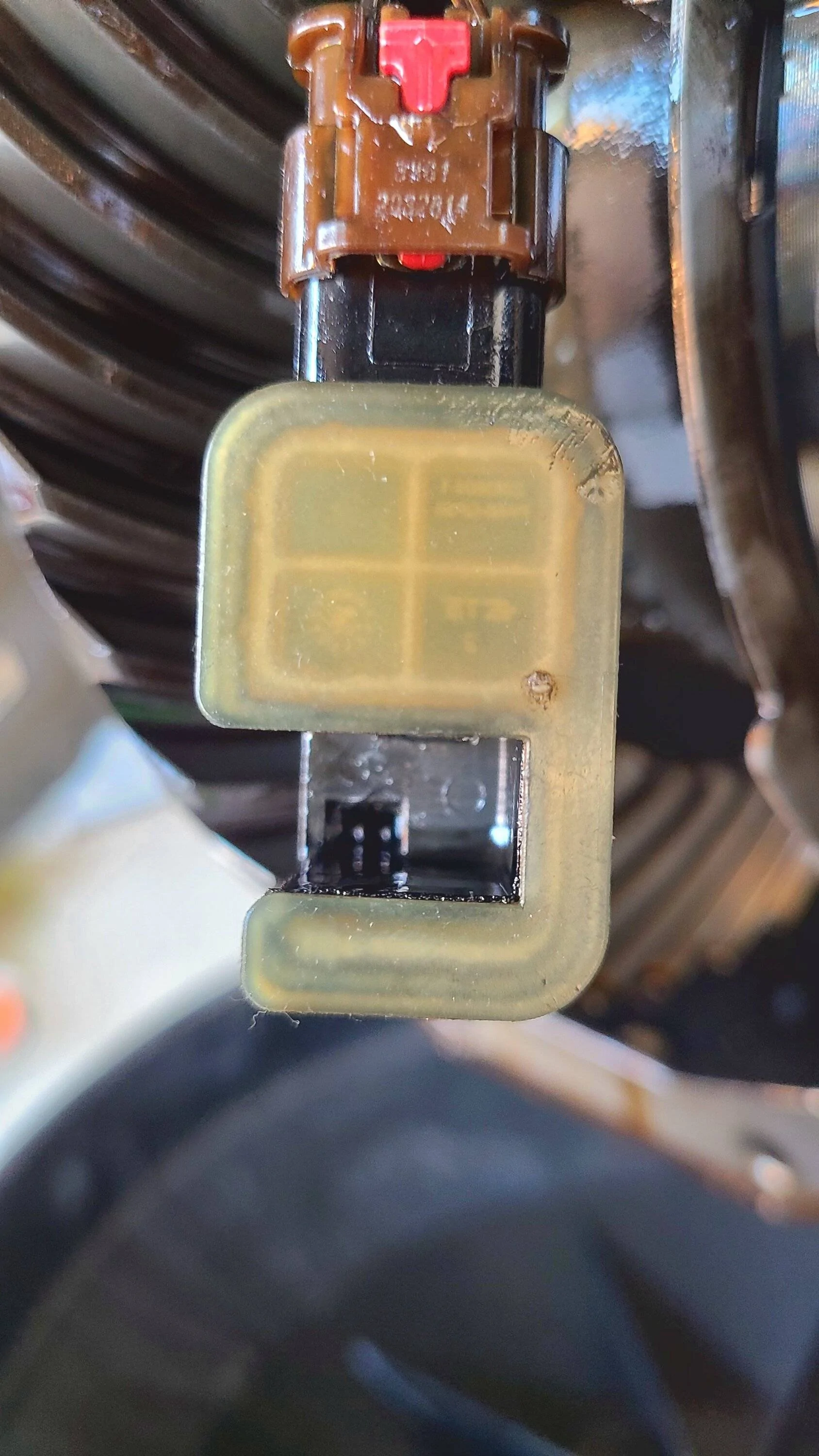

My sensors and potting compound are arriving today. I'm using the same compound @chevymitchell recommended in the first post (https://www.amazon.com/MG-Chemicals...locphy=9009606&hvtargid=pla-376934479130&th=1).
Can anyone tell me if it contains enough compound to pot all 5 sensors? I may just pot them all and let them dry first, then swap them out. That way my Jeep won't be out of commission for a day.
@DHW
I potted mine quite some time ago, I just pulled, potted, and replaced. So only 2 sensor potted, seems to be plenty left so I'd say should have enough for 5.

The sensors come in packs of 5 and then it’s trial and error to see which one is correctly calibrated. Then you pot the right sensor and wait 24 hrs until it cures. If I pot all 5 first I can just leave the right sensor in, refill with oil and go.

Ahh, gotcha. I didn't realize your factory sensors had already failed. I would think there should be enough compound to pot all 5. @chevymitchell probably knows exactly how far one tube will go.

It can do all 5, for sure. And then some… never tested the max usage. Just depends on how much you bleed out of the sensors when potting them. It’ll do 5 though without a problem.
