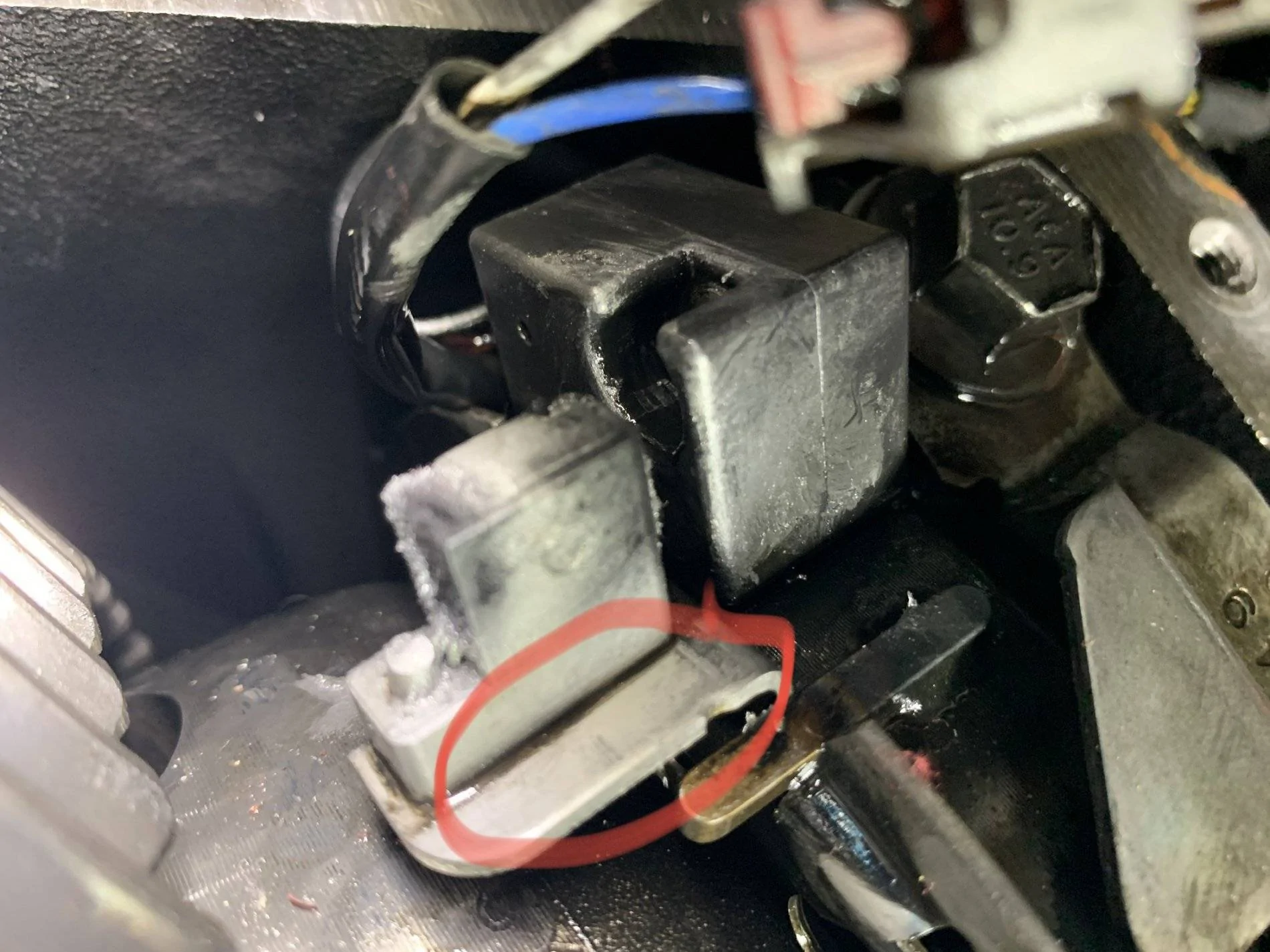

A couple of tips that I haven’t seen mentioned:
  • Milwaukee M12 3/8” ratchet made diff cover removal much easier than hand tools would have been
  • Neither my Milwaukee nor my Tekton ratchet could squeeze in to get the very top bolt (true for front and rear). Make sure you have a good 10mm wrench or a shallow 10mm socket (I will be buying a cheap one at Harbor Freight, tomorrow, to make reassembly easier)

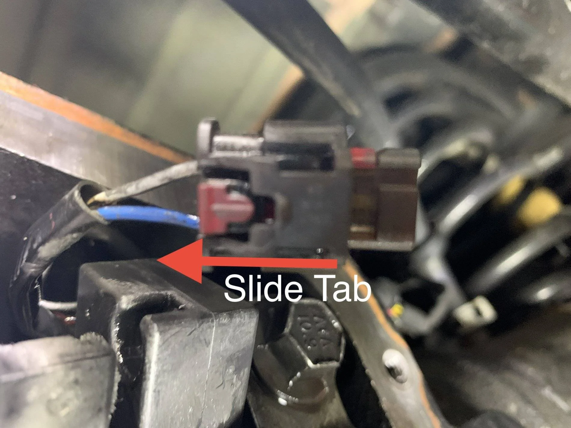

  • Getting to the red tab that releases the wiring harness is pretty much impossible unless you wiggle the sensor free, first
  • Wiggling the sensor free takes patience. I found that I had to put some pressure on the metal clip thing (see picture)
  • T20 screwdriver was a piece of cake. I’m glad I didn’t monkey with the “single use” cap bolts. (I don’t know if they’re all the same, but my T20 is a Tekton. It fit easily and the handle is stout enough to get plenty of torque to prevent stripping.)
  • I found the front to be easier to see. I started with the rear, but recommend starting in the front so you can get the hang of wiggling the sensor out and disconnecting the harness.

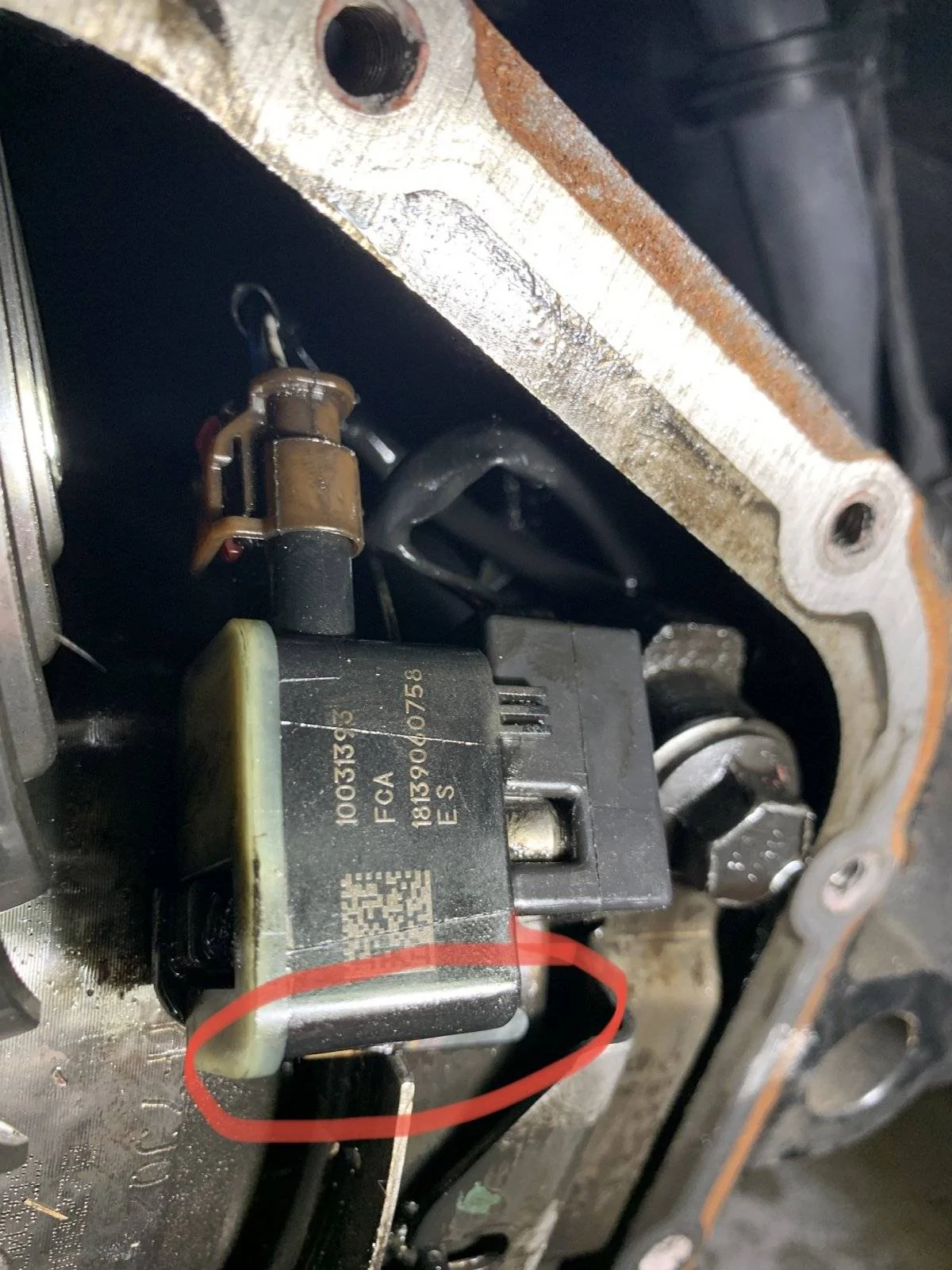

Gently pushing the circled part helped me get the sensor free:
Here’s the red tab. It slides. Small flathead for the win. Easy does it!

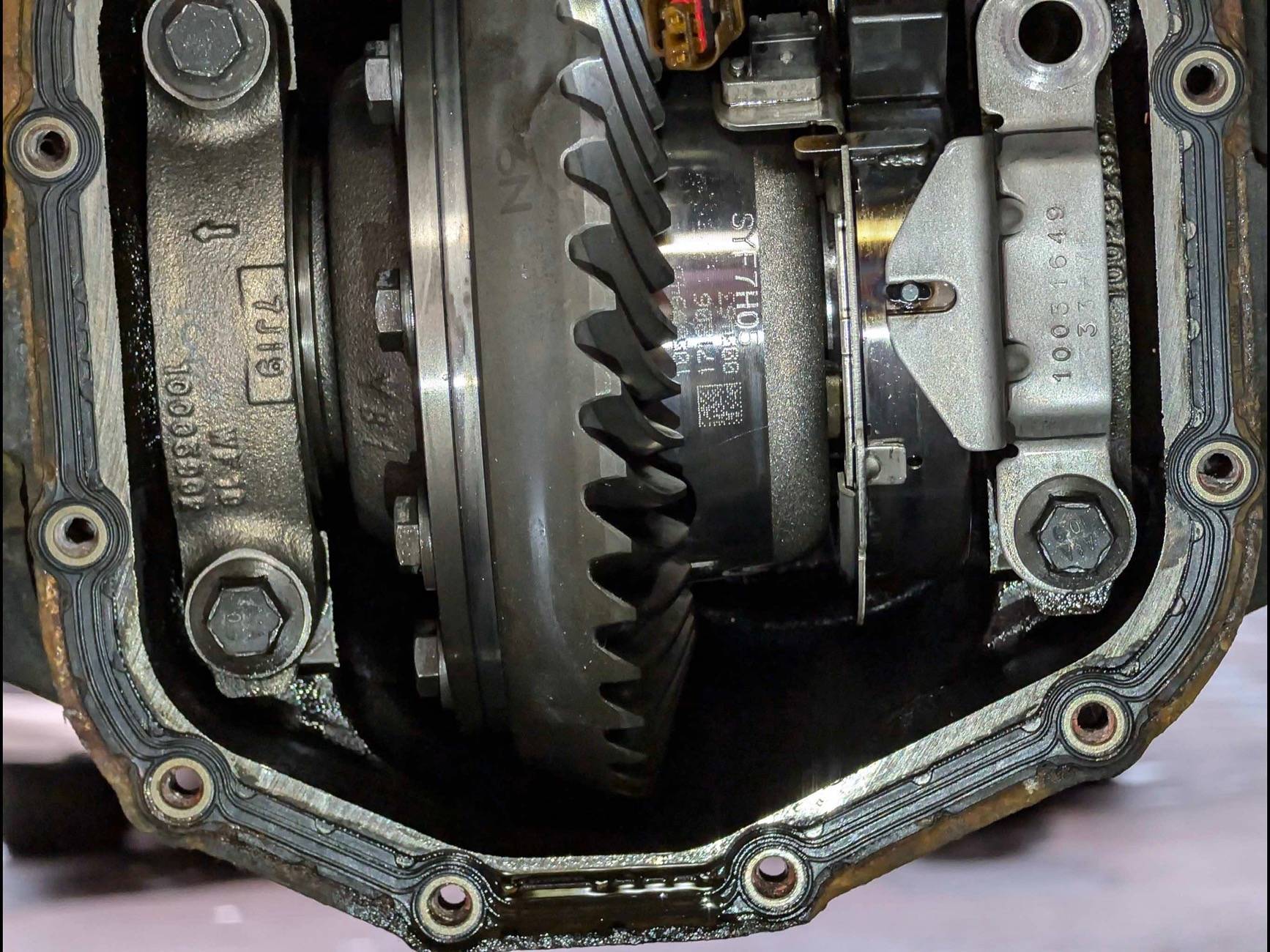

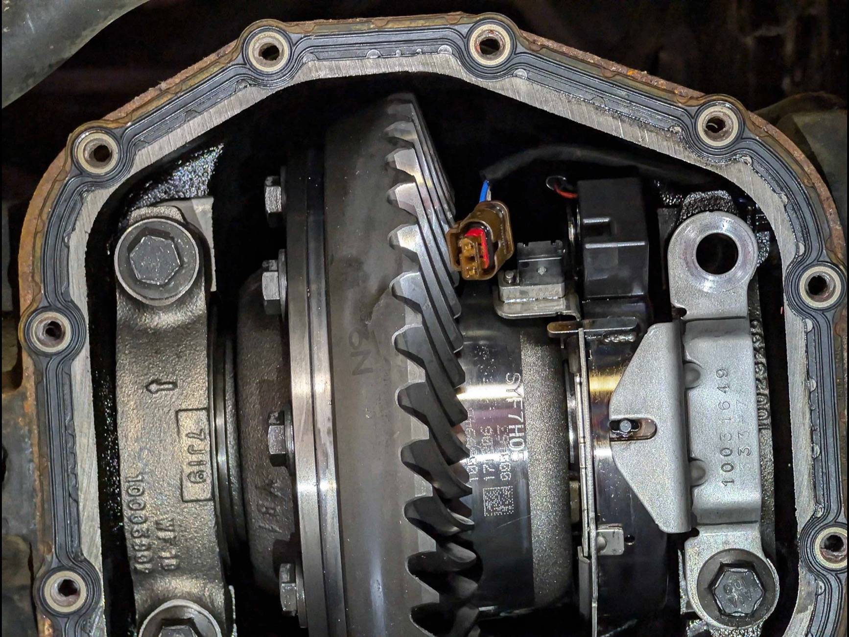

But wanted to service the diff fluid and check the magnets for big chunks of metal - so popped off the cover and pulled out the "locker sensor".
Front. Fluid looked not that bad. Zero really bad smell. Not burnt. Magnet at drain bolt and magnet under locker sensor - covered in super fine metal particles. But zero pieces of solid metal fragments like others have shown. All super fine super silty.
Locker sensor - 60% to 85% filled with diff oil depending on which position it is oriented. All of the oil looking to enter from the connector. Very surprised this has not already shorted out long ago. So am super lucky everything is still working perfectly with zero idiot lights zero problems.
Takeaways for others planning to do this. Do this asap. Minimum get a couple of ramps - 4 is better. Ours is OEM so no suspension height upgrades. All stock. Since we have only 2 ramps those went on the front - jack stands with blocks under - went on back axle for max height up. Lift as high as you can for better access vs all cramped.
Also "add a jack at the boxed frame rail" - on the drivers side under the driver door area for the front diff. This lifts the track bar up and out of the way of the top 10mm hex bolts fastening the diff cover. Lift it high so you have really good clearance. More the better as after the diff cover comes off - you have to remove the T20 screw holding on the "locker sensor" component. Standard draining procedure with 3/8" square drive for fill - and drain with magnet.
Like you did not need to remove the cap nut. The T20 fit fine - but was stuck in very tight with some original red substance on the threads. Probs that typical dry thread sealer factory product. So will use red Locktite as ChevyM recommends. It needs to be affixed tight so it will not loosen off. With a longer handle the T20 would have easier to remove - but all we had at the moment was a shorter stubby with minimal grip purchase. Probs will pull out my extension to crank down when re-installing.
The red tab on the wired plastic connector needs to be pushed backwards towards the wires with a thin flathead. Then the red tab needs to be pushed down as it acts as a clasp. Locking on a small piece of plastic nub on the "locker sensor". If you do not push down on the red while pulling apart - the connector will not disconnect.
Was careful not to push or pull too hard - as others have unfortunately broken off some small brittle pieces of plastic. Same pulling off the "locker sensor". It is magnetized in place. So you have to lift up the bottom corner to release the magnetic force. With gentle persuasion it will detach once enough force in the proper upward tipping direction is applied.
Then wiped away all the metal silt stuck to the magnet upstand. Then sprayed brake cleaner to dissolve the remaining oil stuck in the diff letting it all drain out. Will spray CRC electronics cleaner on the connects and will apply some dialectic grease at the connections. As that whole wired connection was filled will oil.
Now once the "rear locker sensor" is pulled - will drill clean pot both yada yada. Got 3 pouches of Valvoline Flex Fill 75w140 since Dana recommends 140 - and not 85 like FCA. For sure 140 will protect better vs 85 at high temps and high loads. As am not worried about MPG like FCA is. But definitely do your research on this - as if still under warranty - you do not want to jeopardize your coverage.
Takeaways. Even if your lockers turn on and off perfectly in about a second or so with zero idiot lights. Pull out the "locker sensors" and pot them with proper potting compound as per ChevyM recommendations. Makes a lot of really good sense vs leaving them to their own devices to eventually short out with hot oil and metal particle contamination.
Just assemble everything and get your quacking ducks in a row. Then trust your expertise and your skill set. It is a task that most Rubicon owners should "at the minimum" be capable of doing at the drop of a hat. Since FCA or Dana will probably never do this very important task.

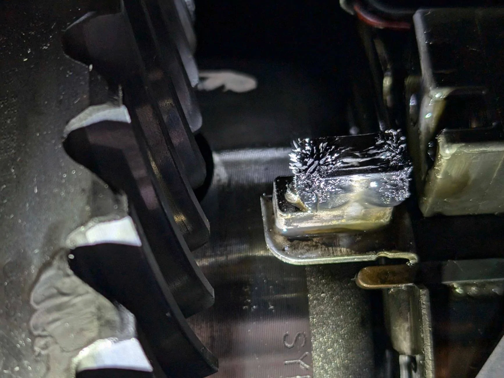

4 Notice the size of metal particles on the fixed magnet - these are not very silty

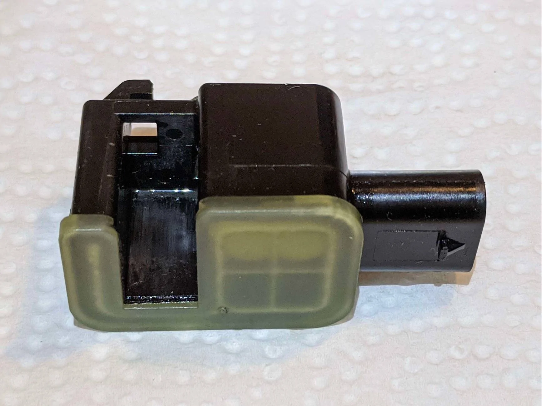

5 Otherwise all looked fine and was now time to drill clean and pot both sensors
6 Drilling was super simple if you have a moveable guide on your hand drill
7 Just take it slow and make sure you have very bright lighting to see depths
8 Note that the front translucent is much firmer vs the black back material

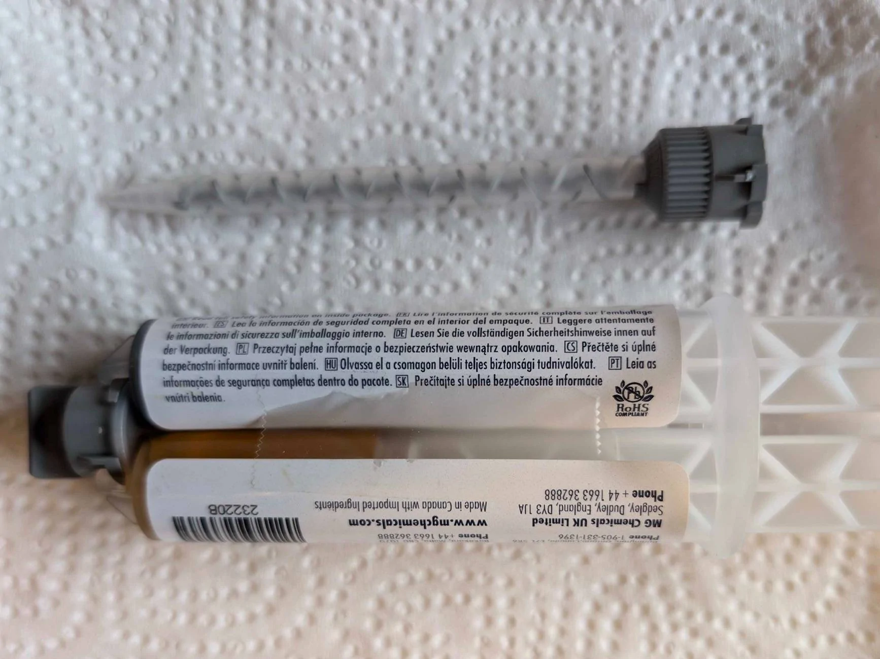

9 Potting used more that 1/2 of the 25ml tube - to pot both front and rear
10 To ensure every air bubble and air pocket was for sure pumped out
11 You want a very steady stream of compound to flow not sporadic bubbles
12 Which actually did happen for quite a while - while doing the final injecting
13 Tomorrow will re-install and probably pull the front cap bolt for the T20
14 That way enough straight on drive force can be applied with red threadlock
15 Also might as well buzz off any rust and apply more CRC Marine cosmoline
16 Since after 6 salt brine years the amount of underbody rust is almost zero
17 Finally notice the potting compound injector nozzle looks almost unused
18 Just run under very hot tap water and the product clears right out
19 Then blow air through and it can for sure be re-used again
