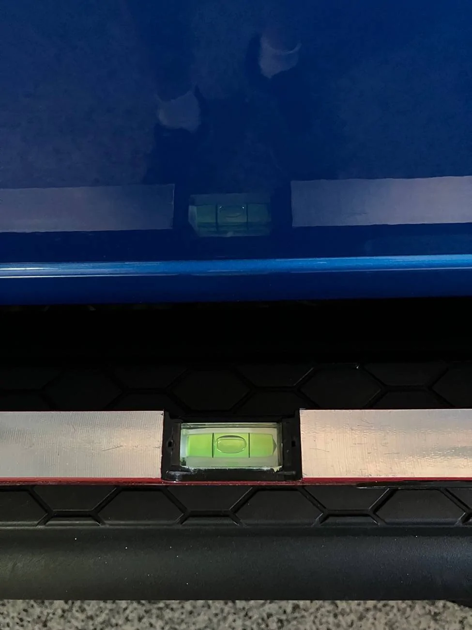

That's basically no weight. Something is screwed up with your suspension.
It'll beat the crap out of you on and off road. Those springs are intended for rigs that are loaded down with overlanding gear. Consider AEV's 2.5" springs instead.
Mine has steel bumper, 35 and gear, on a 2 door. It sagged in the back on Mopar 2: lift. the front was noticeably elevated. The 3.5 rock Krawlers leveled it out

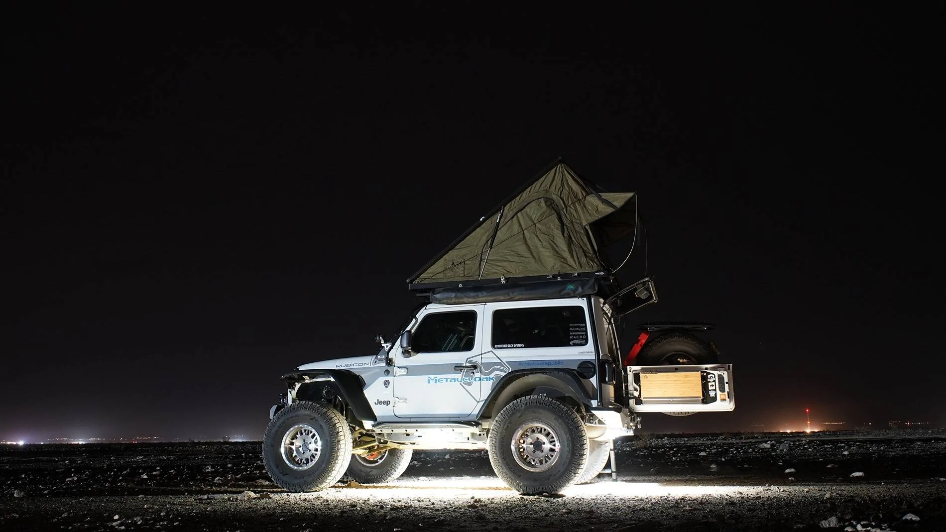

I run a beefier spring in the rear with a Metalcloak 3.5" lift (overland build) so that I can regularly add 300-400 lbs of gear and not have sag. Here's a pic fully loaded for a week-long overland trip.
