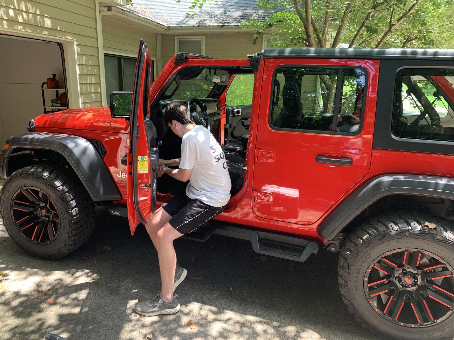

I have a 2019 JLU. It currently has a 2” Mopar lift with 35” tires. The tires rub the fenders a little when I make a hard turn. Can I have a body lift added to what I have and not mess anything up? Plus, I would enjoy the extra height. Or do I need to pull the 2” lift off and put a 3” lift on. FYI...I don’t take it off road.

The rubbing on turns has nothing to do with lift height. This is caused by the backspacing of your wheels and chosen tire size.
Which wheels are you running? What is the backspacing?

The backspacing is 5.71? Is that what you’re looking for?
It is rubbing that piece between the fender and the bumper. That’s exactly it. Thanks.

If it is rubbing the bumper piece just remove it. It is not necessary.
If the tires were rubbing your inner fender it would be wheel backspacing. 5.71 is higher than most people run with a 12.50 wide tire but it doesn't sound like that is your issue.
