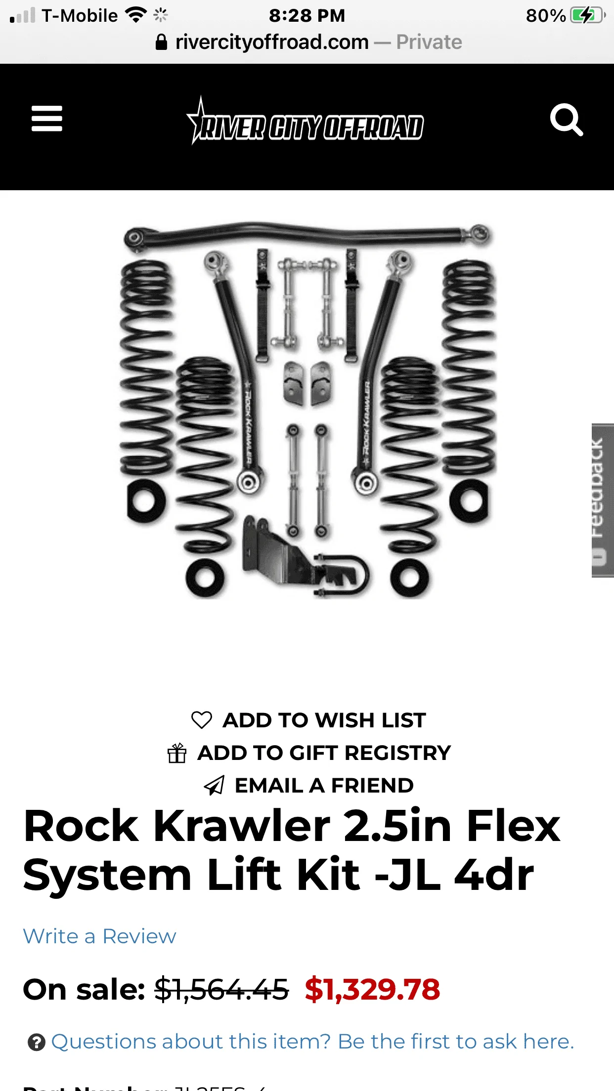

@River City Offroad has this kit on sale, you pair this with Fox 2.0 shocks and you have everything you need for your intended use…..
Jeep Wrangler JL Lift decision headaches 4DDD226F-5340-4F4A-8013-581FEA5E1E38
