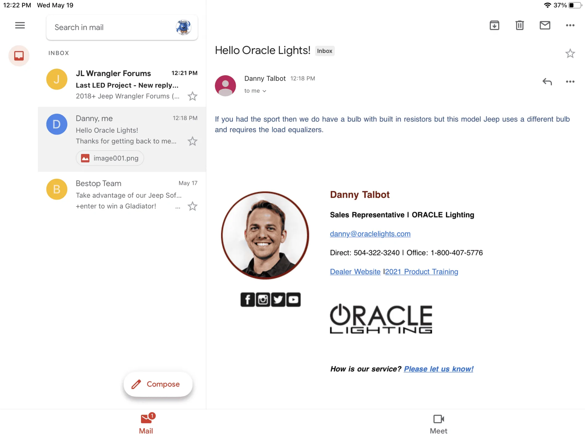

Possibly. But, as you can see in my chat, I specifically mention Sahara. If they are selling that DRL bulb specifically for the Sahara and Rubicon and it requires a load resistor, then the web site should say so in the bulb description.
Yes, the Sport can use a switchback bulb that Oracle (and others) sells that has what's needed built in. I have a set from another company installed on my Sport Altitude.

And it’s not that installing the resistors is an issue but I know they get very hot and there’s not a lot of room in that area behind the fender flare and I don’t want to take a chance on melting wires and adding the resistors just adds another possible failure point.

JP here from Product Development. I'd like to start by apologizing for the misinformation given surrounding this topic. We'll be addressing that internally to better serve our great customers! Allow me to clarify a few things here:
1. No JL or JT Sahara or Rubicon models need resistors or "canbus decoders" for the front signals - The only bulbs that require resistors are the Stop/Turn bulbs in the tails.
2. The CK bulbs we offer for the Sport models do not have "Built in Resistors"
3. I see the bulbs you originally bought which hyper-flashed were of the "canbus compatible" type. The issue here is that the IC built into these bulbs are showing the Jeep something it does not need to see which is likely what is causing the error which cannot be cleared with the JSCAN.
Simple 7443 LED bulbs will do the job here for the signals without the need of resistors. Here's a link to ours in amber: https://www.oraclelights.com/collec...ignal-bulb-single?_pos=4&_sid=5074792b1&_ss=r
I hope this helps & we can earn your business in the future! Feel free to PM me with any other questions/concerns.
