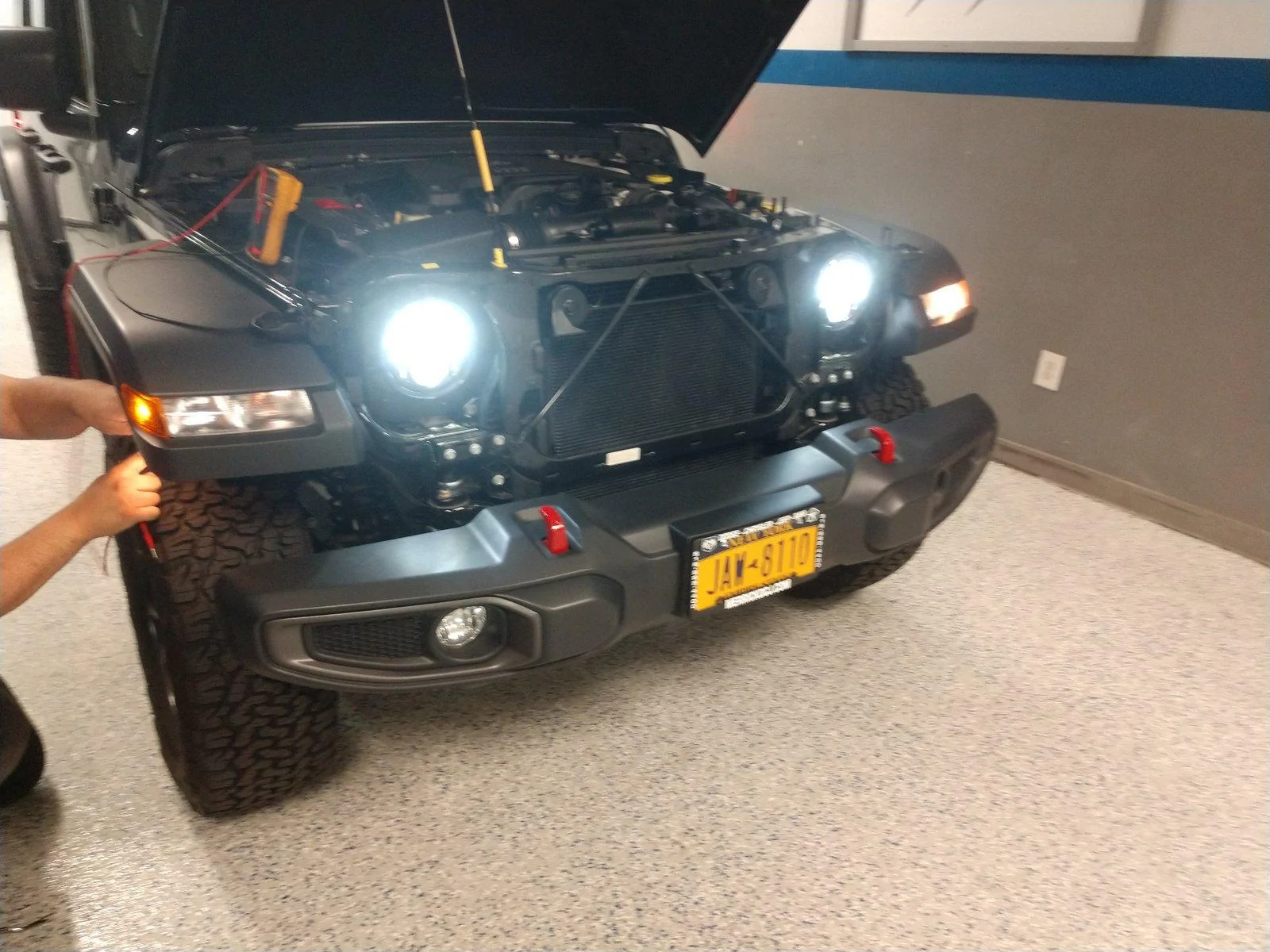

The headlight connectors are removable from the back of the headlight but you need two people to release the latch from outside and one to turn it . My project is done. You rock Americonium

Thanks to Teghogh, the wiring has been fished out of the headlight buckets. I've painted the brackets I made and final install should be tomorrow.

I have a couple questions. Is the headlight you use a JK LED headlight? Im trying to figure out what I need to do this conversion: HD light bracket, fabricated bra
I still don't know how much these brackets are going to cost me. Once I find that out, I'll pass it along.
Count me in. Great work!
I'm using a seven inch headlight, and yes, that is compatible with the JK.
You'll need a pair of lights, an HD adapter, the one I'm using is in a link somewhere in this thread, an adapter plate, and possibly an anti-flicker harness . I should know more by the end of tomorrow.

Done. Lights light. No flicker. With adapter harnesses. Engineer running. Just need some darkness to confirm.

Whenever you figure out if/how you are going to sell these, please let me know. In the meantime, I may attempt to copy your setup. I give myself a 10% chance of pulling it off :)
Patience. We're so close...
