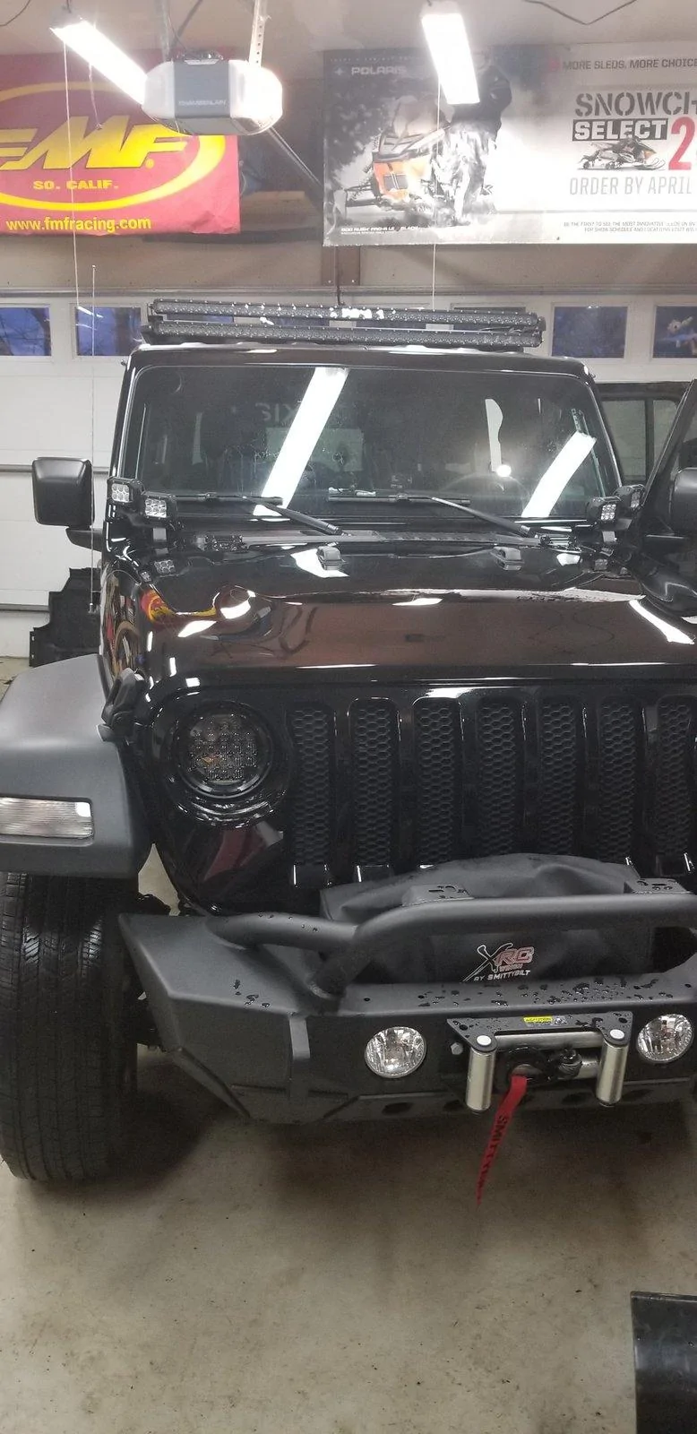

I just installed some. You need to make sure that they come with the right cable adapter for the JL, different then the JK. And you need to get the Headlight bracket adapter for a standard 7" headlight. Dont waste your money on expensive ones.
