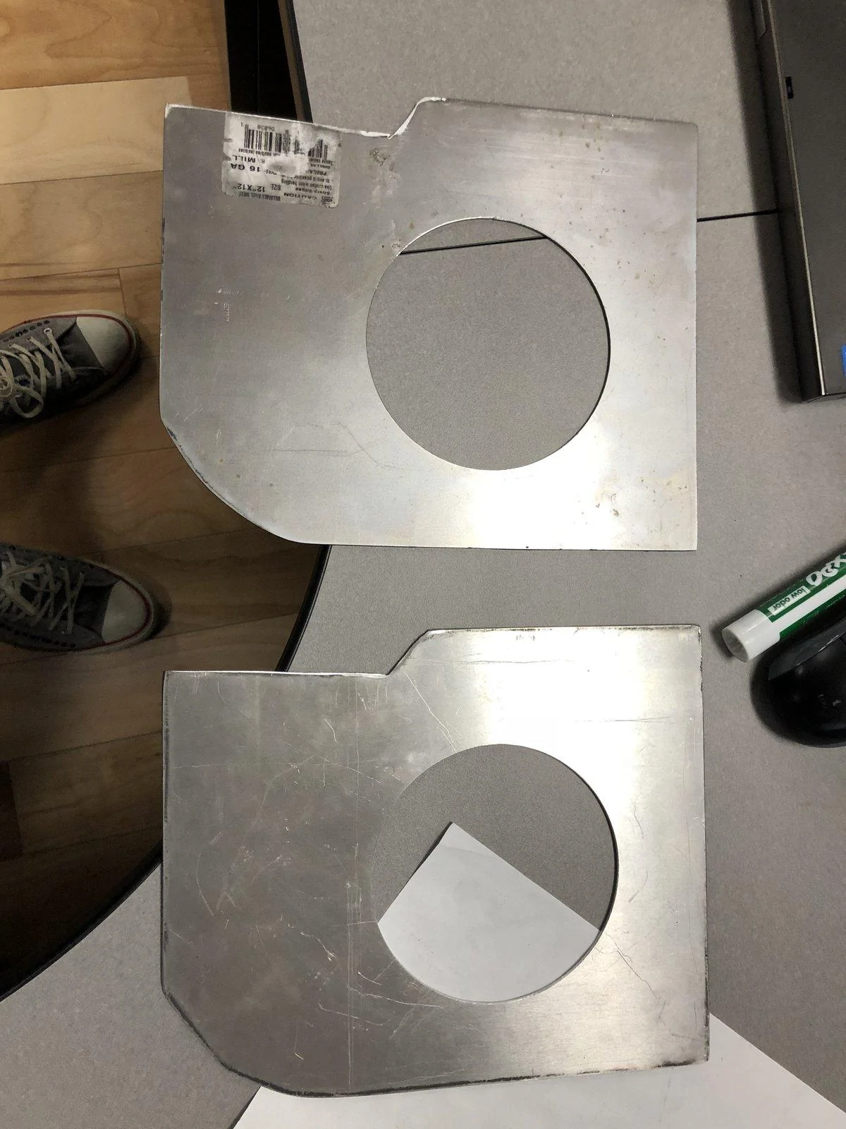

I have deleted the files that had the brackets on them. Why, oh why did you do that? Because the CNC Waterjet guy said that we're making these. So.
1 week from today I'll have 3 sets. I'm going to test them out, make tweaks, and then, we're selling brackets.
Do you want them spray painted black, fully assembled with the mounting rings and installation hardware, and ready to install?
Do you want just bare metal waiting for paint and your hardware?
Do you want the anti-flicker wiring harness?
Do you want a complete plug and play system?
And how much do you think you should pay for the level of completion?
We have a week before these will be on my desk, so let me hear what you want and we'll go from there.
Thanks.
Abe

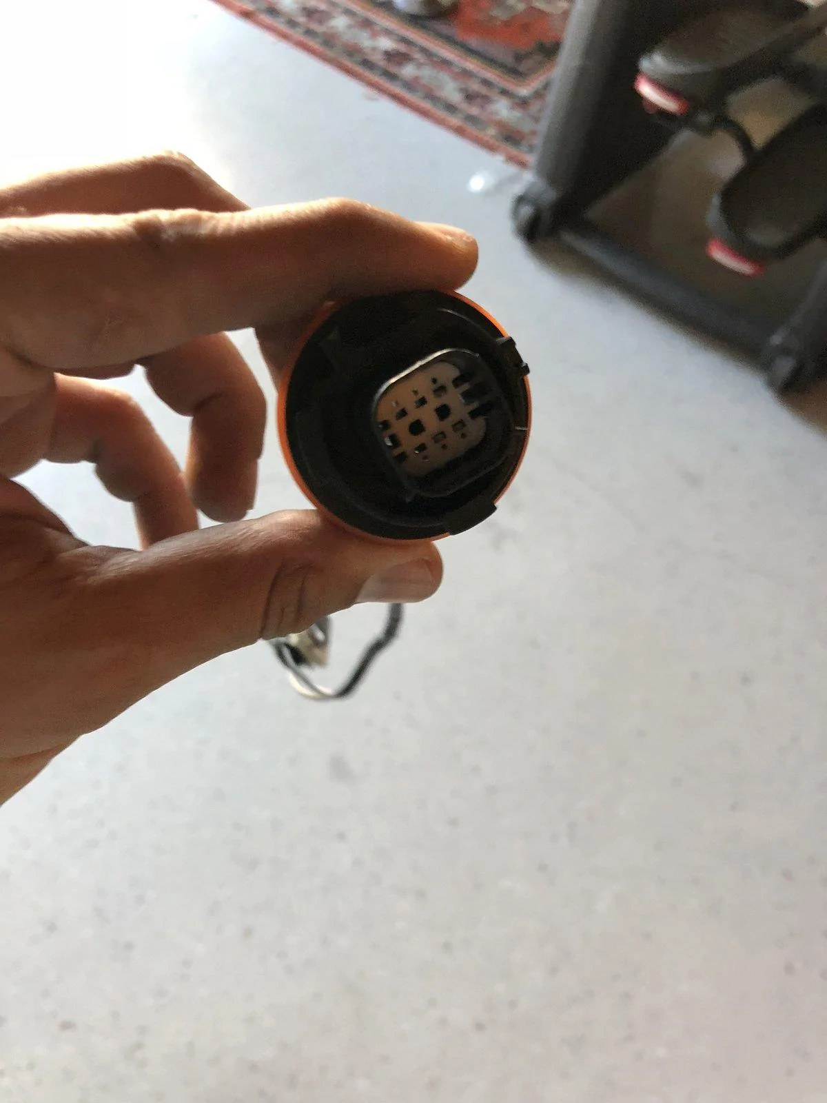

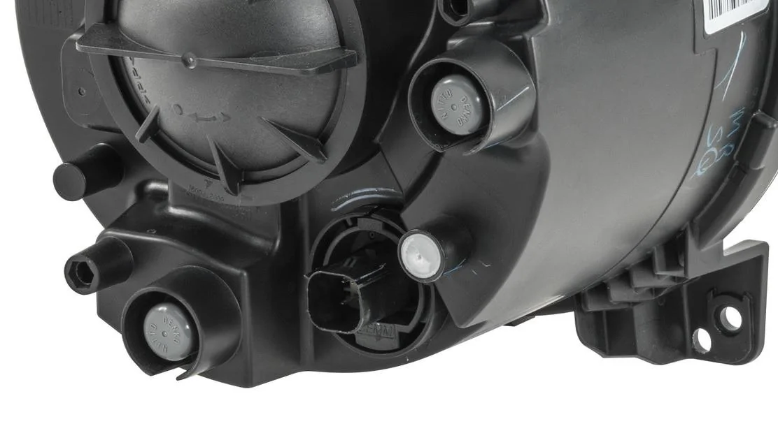

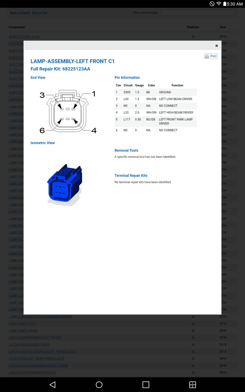

Also I’m pretty sure the connectors I’m back of the halogen headlights come off, this way there is no need to worry about wiring at all. I have not been able to remove it from the headlight though
I do believe you're correct. That changes everything.

It does detach. To the inside of the lamp. Plug and play impossible. I will have three brackets for sale some time next week .

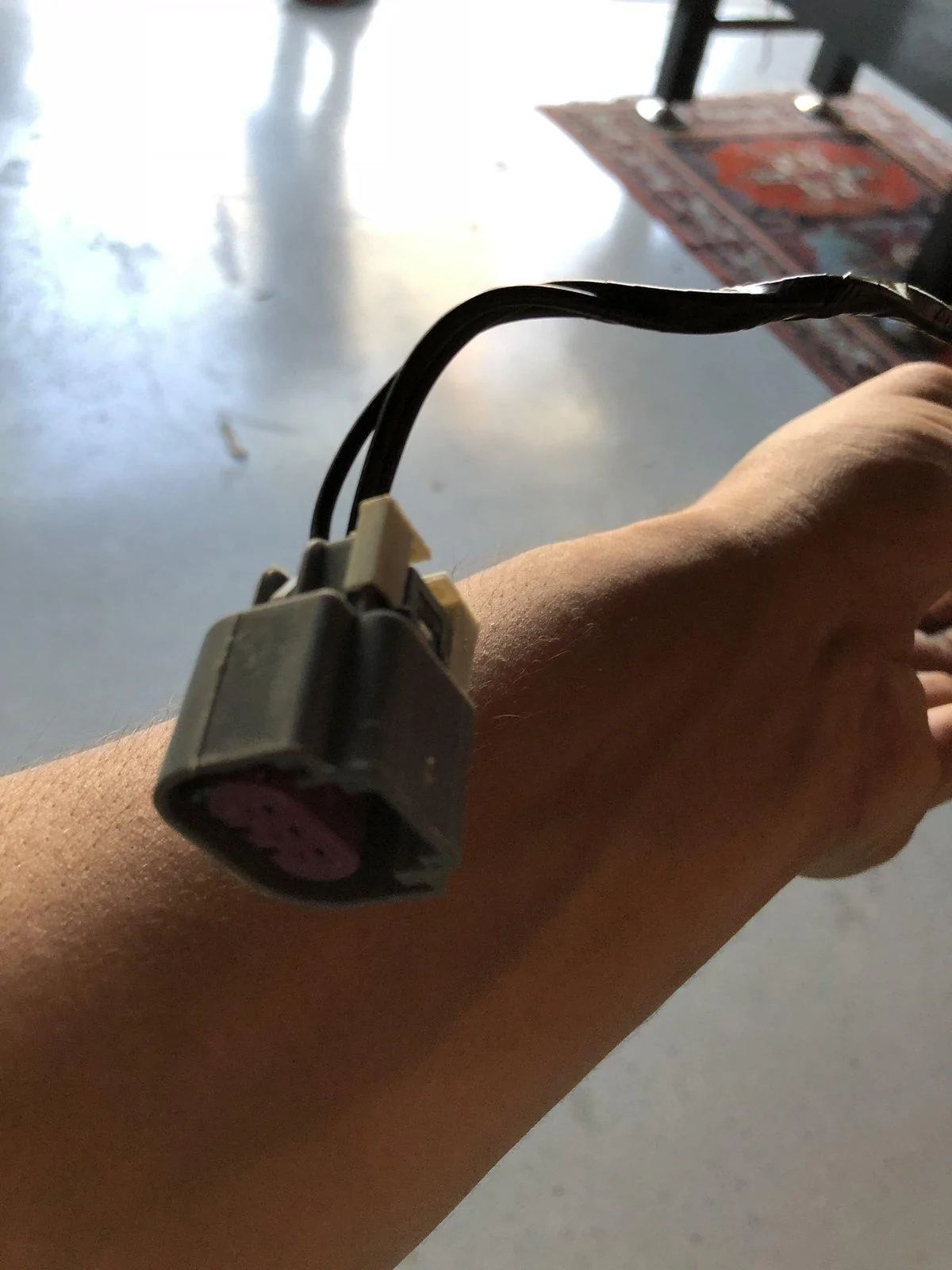

Ill take a set and be a guinea pig. Im done retrofits before, baked open headlights, installed HID kits, i know how to use a dremel and dont mind investing some time into getting these to work.
The one thing that does look to be troublesome is the harness you mentioned. The Jeep has that weird connector on the stock harness and doesnt turn to an H13 connector until the back of the halogen projector. Obv any HIDs or LEDs(depending on what aftermarket set we buy) will have an H13 harness. When we replace the whole headlight it seems like that stock harness/pigtail that converts the weird Jeep plug into an H13 will go away with the OEM headlight. How are we going to plug out new aftermarket harness in? Any input?

Hardwire the plug .that's going to be the only option at this point.

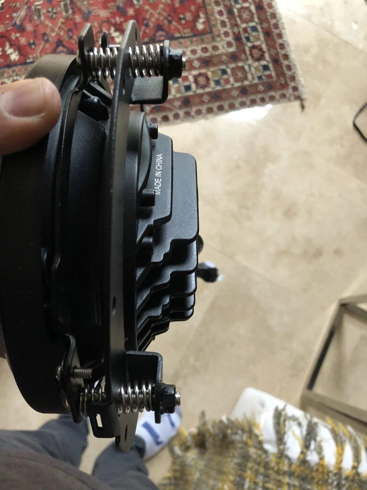

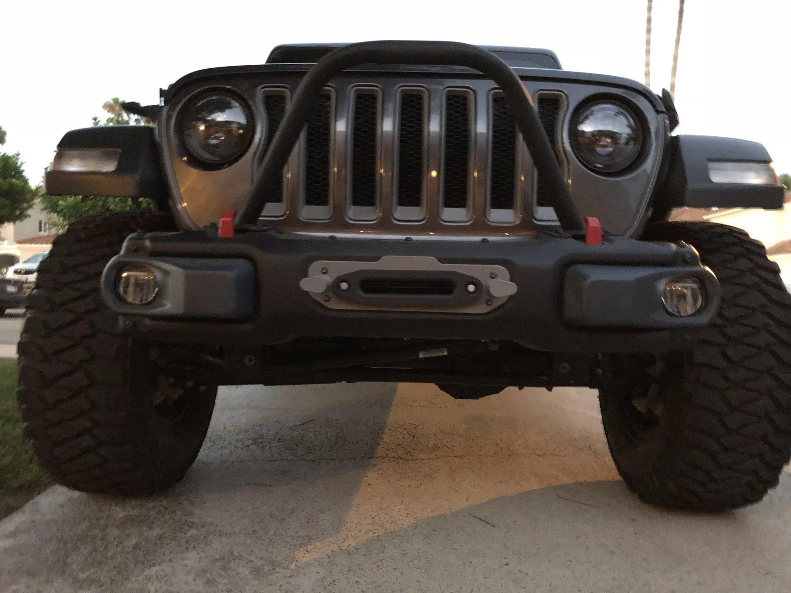

I couldn’t wait any longer so I made mine. I’m going to use a L bracket to secure the bottom of the bracket to the car as well as the top left bolt you have used on the driver side. Im going to come up with a custom bracket to bolt on to the existing top right mouthing bolt on the driver side should I need a more rigid platform. This is smipler solution, but less elegant than what you have done but I think it will get the job done. I’m not sure how you have secured the Harley bracket on your bracket since there is a .75 inch or so gap created as the result of the bracket adjustment springs

I cut notches out for the adjustment spring flange.

The headlight connectors are removable from the back of the headlight but you need two people to release the latch from outside and one to turn it . My project is done. You rock Americonium
