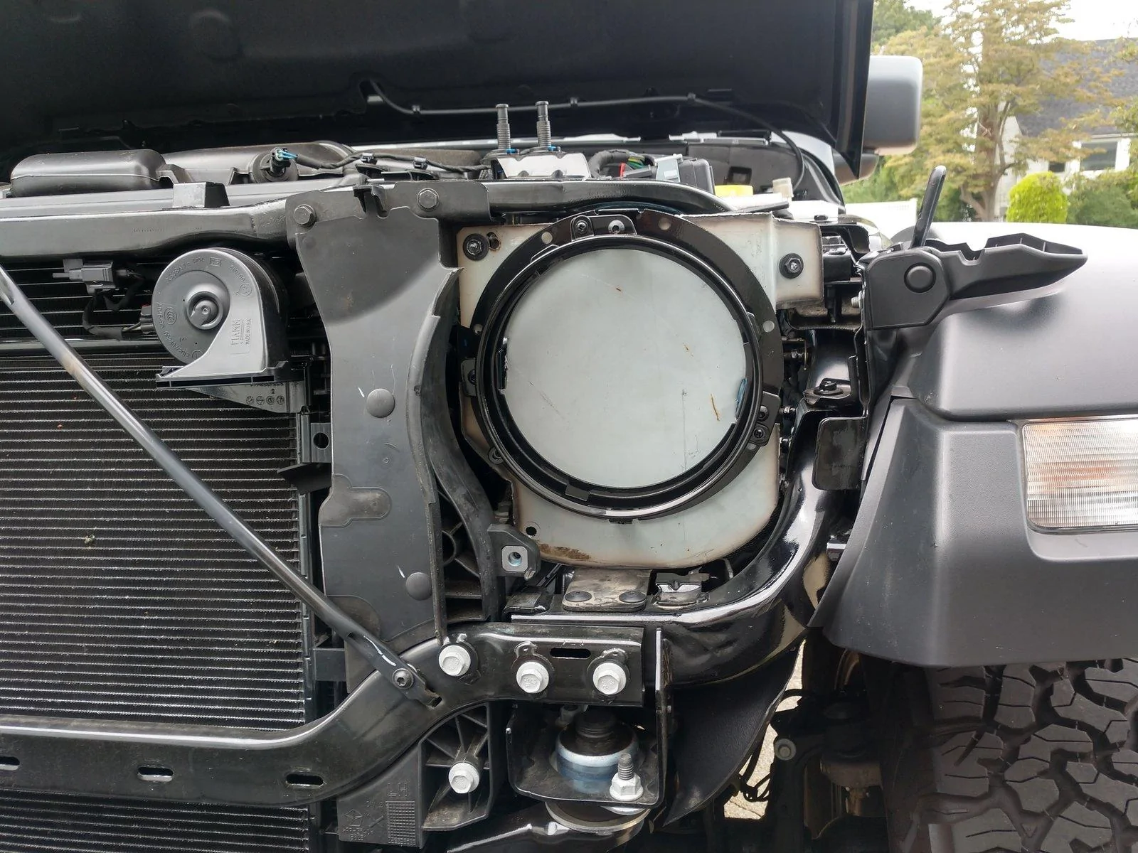

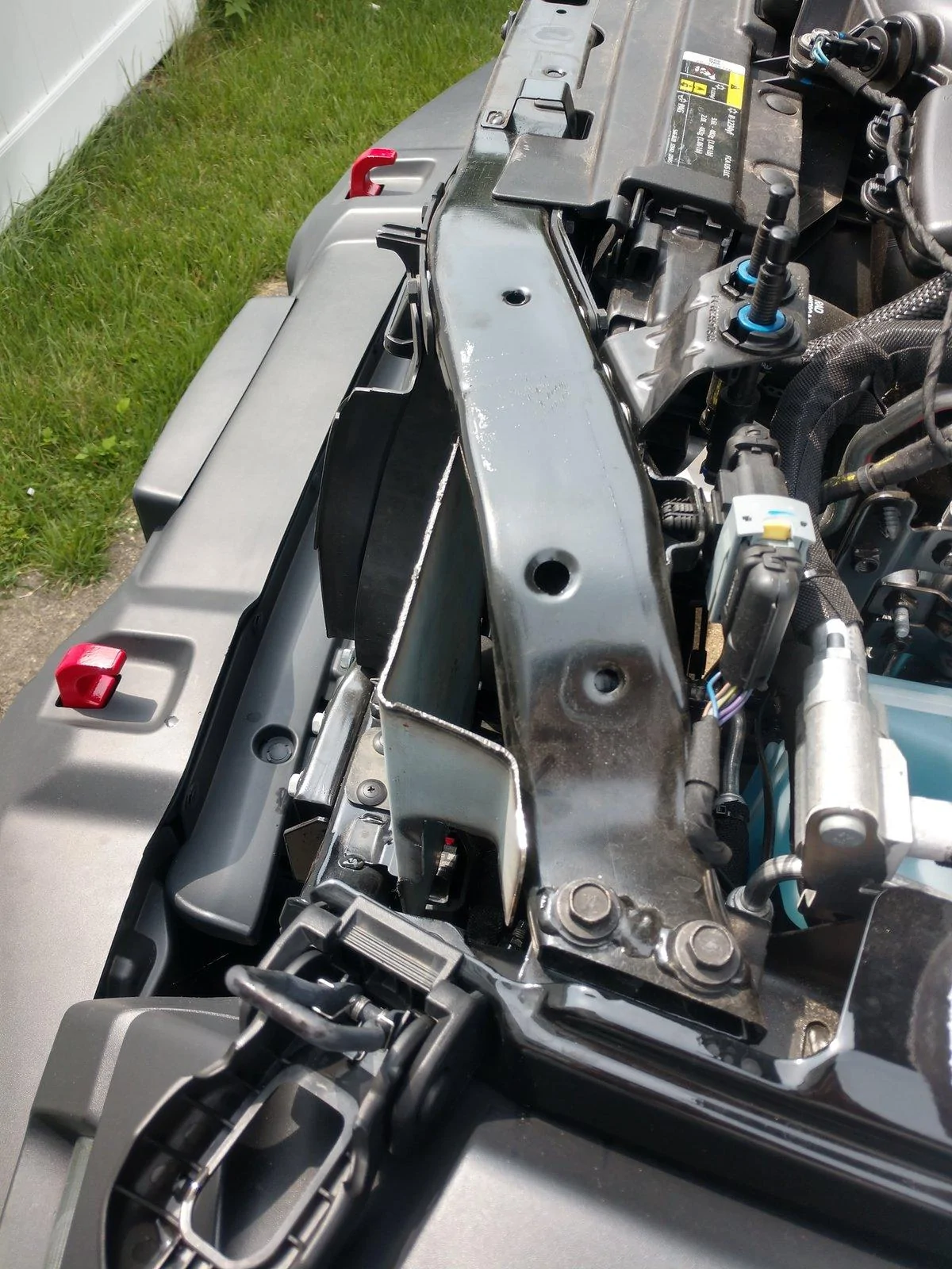

I ordered two 7" headlight adapters for a Harley Davidson, installed one light into a bracket, and have measured a template out. I'm going to make these out of steel or diamond plate aluminum, but I want it to be easy and repeatable. I'll post pictures of my progress and the final install.
I think there are/will be many of us that traded up, but want our old aftermarket lights. That and there are also a lot of 7" LED fixtures that are far cheaper than what is available now.

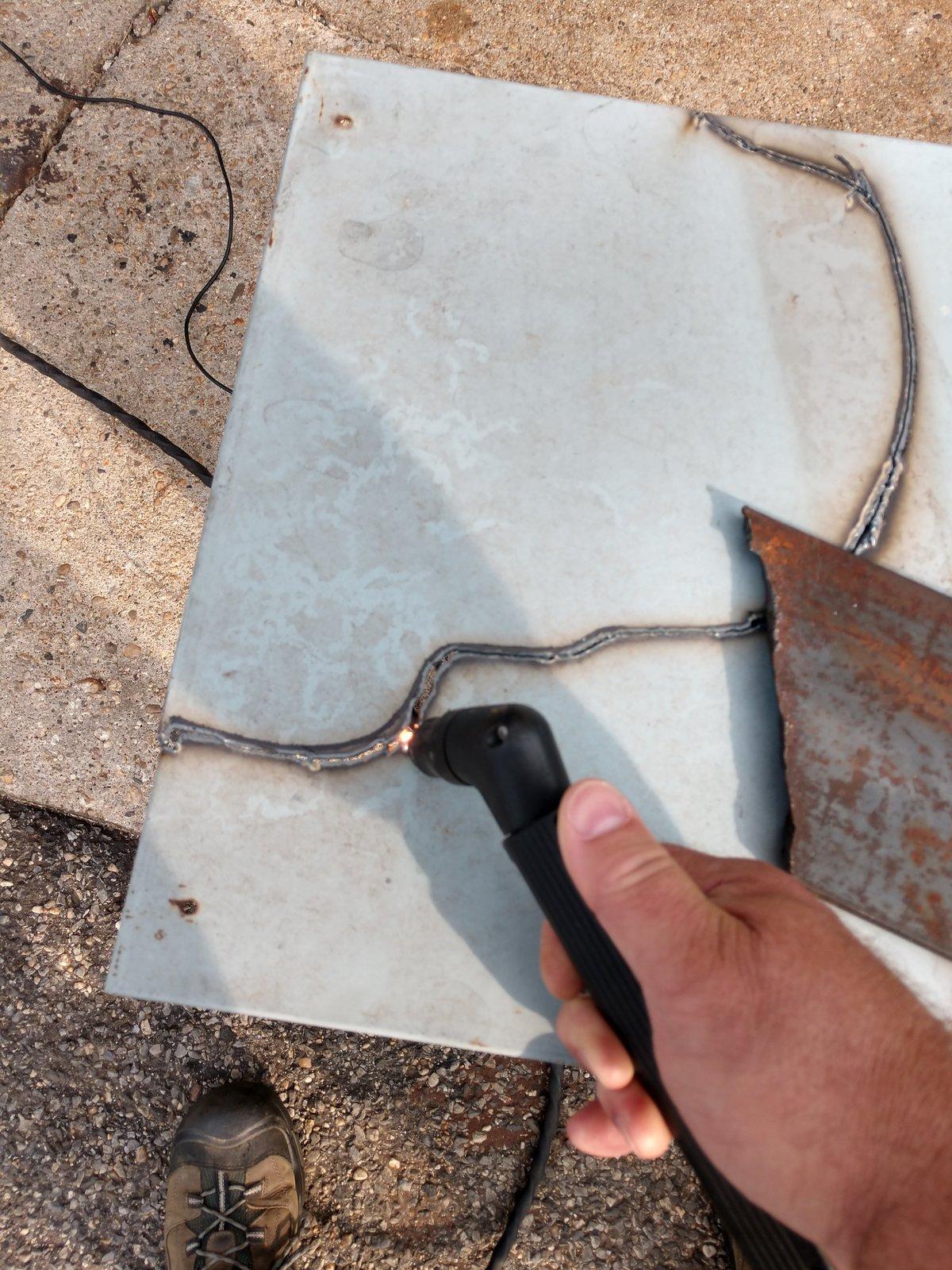

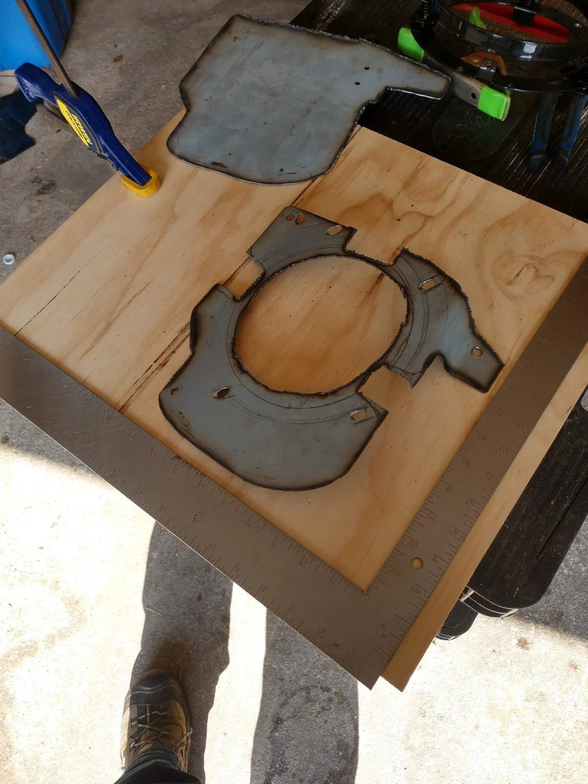

I used a plasma cutter to cut my plates, bent it in the vice, now drilling holes to attach it .

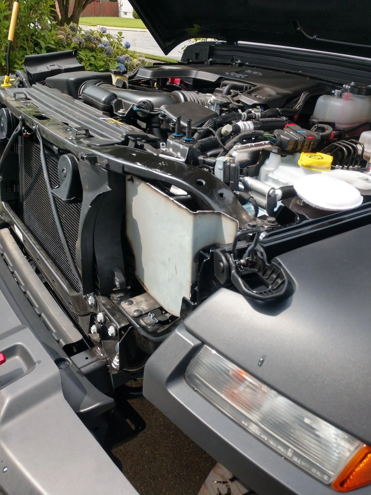

Light ring mock-up .
More: Driver's side done, ready for paint.

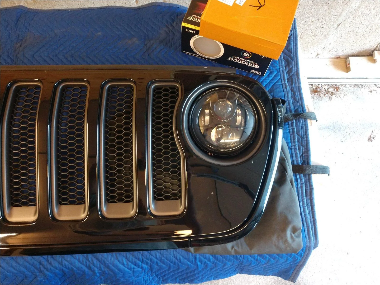

SKUNTUGUANG 7 Inch Black headlight... https://www.amazon.com/dp/B07CBQ97T1?ref=yo_pop_ma_swf
This bracket x 2, and my brackets will give us the ability to physically install the headlights. I still have to work out the wiring harness to make these not flash, as well as make it plug and play. I have 10 hours into design and fit, with maybe another fifteen to twenty for finalization.
All that being said, if I can find a local shop to punch these out, how much would you spend on a plug and play kit, vs a free drawing that you could take to a local fabrication shop? Just seeing where the interest lies.
