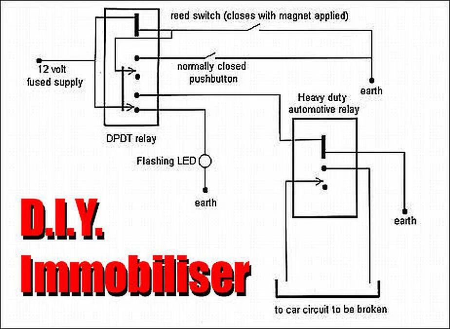

Like some others have said, if a thief really wants your vehicle, he's going to get it. A flatbed with a winch will drag anything away.
If you want to discourage a somewhat less determined bandit, I have used this method with success, so far.
With a fuel injected engine, disabling the fuel pump eliminates the possibility of starting the vehicle and driving it away. The engine will crank, but it won't start. I use this method in my occasionally street driven race car, which has no ignition key or FOB, only a Battery On switch and a starter button.
To disable a fuel pump, you simply need to interrupt the power going to the pump when the ignition is turned on. I use a high starting current 50A relay as the interrupt switch, and control the ground signal to the relay with a magnetic proximity switch that is hidden somewhere handy but is basically invisible.
I like to mount the magnetic switch in a hidden location but the actual surface can be in plain sight as there are no telltale holes. I've put these switches under headliners, in consoles, inside sunvisors, behind dash plastics, there are lots of places if you think creatively. Since it's just supplying a ground, there are no safety issues or fusing of the switch required.
To activate the relay, you simply put a small magnet over the hidden switch, it closes and sends a ground to the relay coil, and it completes the circuit. When you need to enable the fuel pump interrupt, you remove the magnet and take it with you.
I like this method, because some thieves will search for hidden switches, but they typically don't carry a magnet with them.
