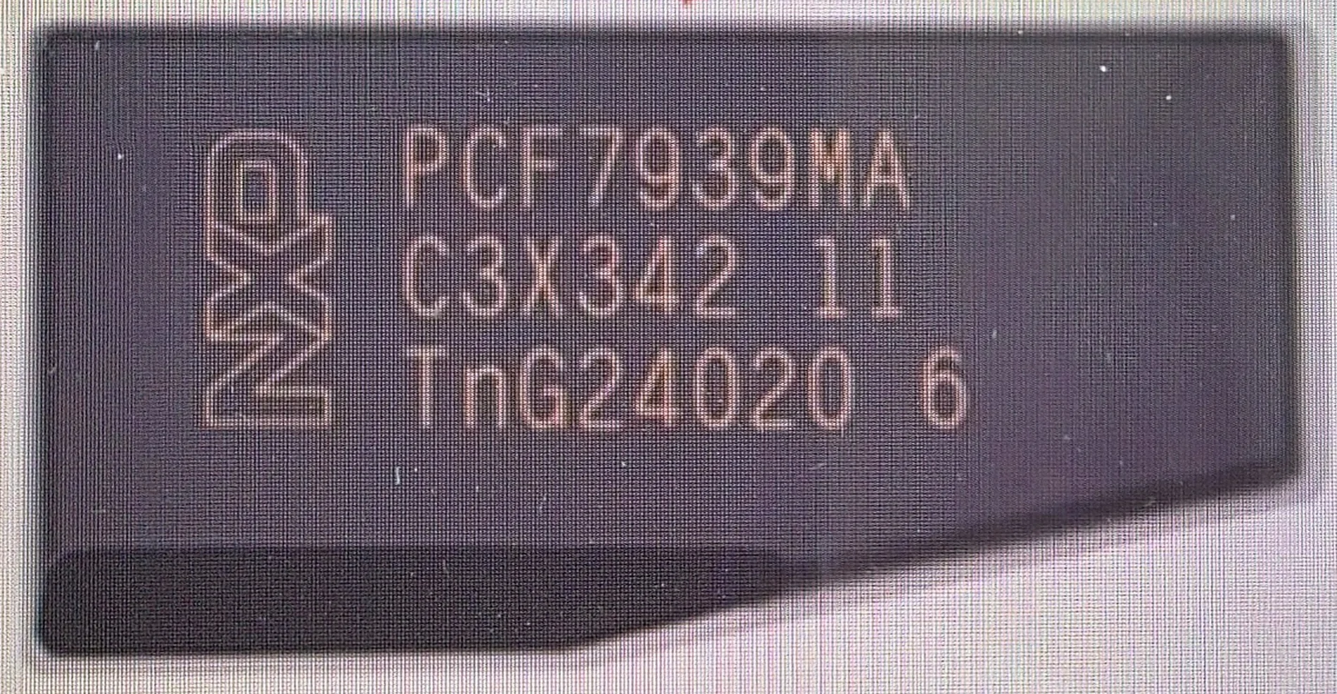

I meant the battery in the Fob. not in the car. I think deleting the aux is the wrong way to go, but many people do it and they are ok. The antenna is around the start button and the chip is a 433Mhz superchip when you take the key apart, it seems to me to be a 4A PCF7939M and a SIP22 blade. But I don't think there is anything wrong with it. If one key works and the other doesn't.
1. change the battery in the key and if that doesn't help, then few €/USD
2. delete and re-encode the key. If that doesn't help either, then 50-80€/USD
3. the same person who transcodes it will change the chip and encode the key with the new chip. 5€/USD chip and then coding

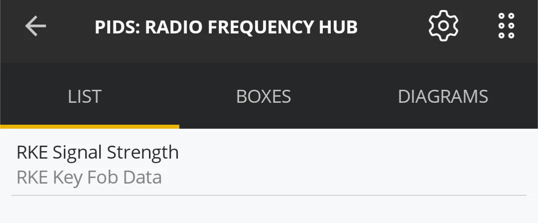

I have the basic 3 button fob and no passive entry, do you know which modules in Jscan display antenna info for the basic lock/unlock system? Ive looked under the RF module and the body control module but cannot figure out what data pertains to the basic wireless lock/unlock feature.
