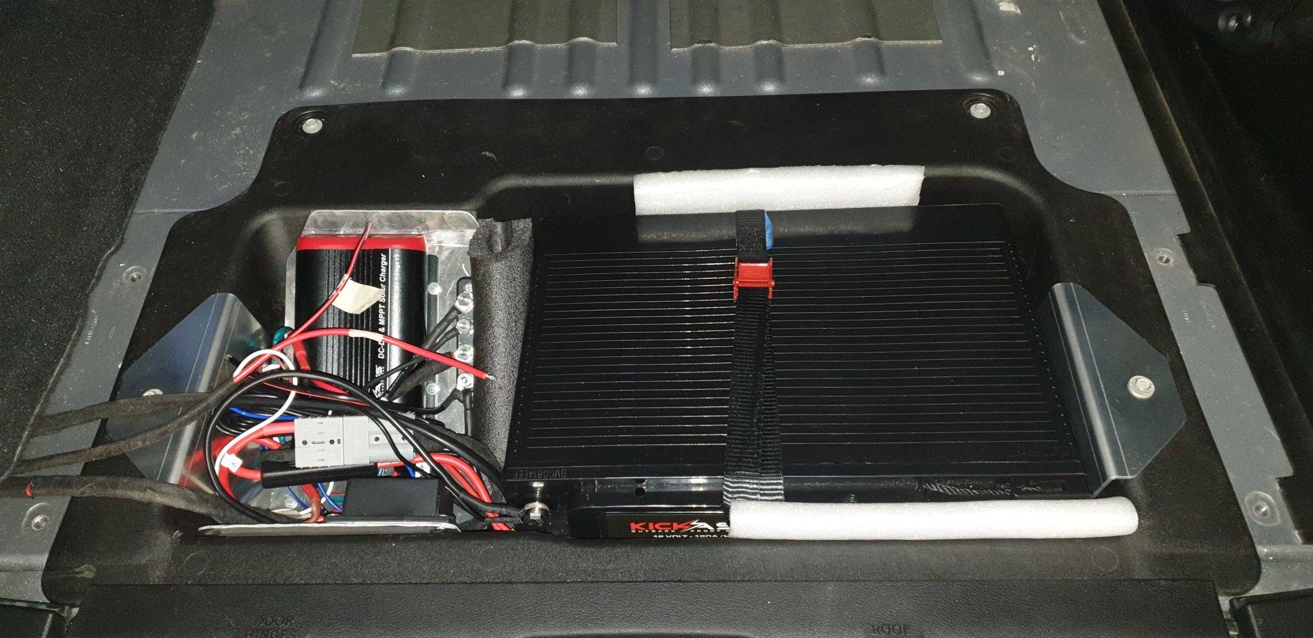

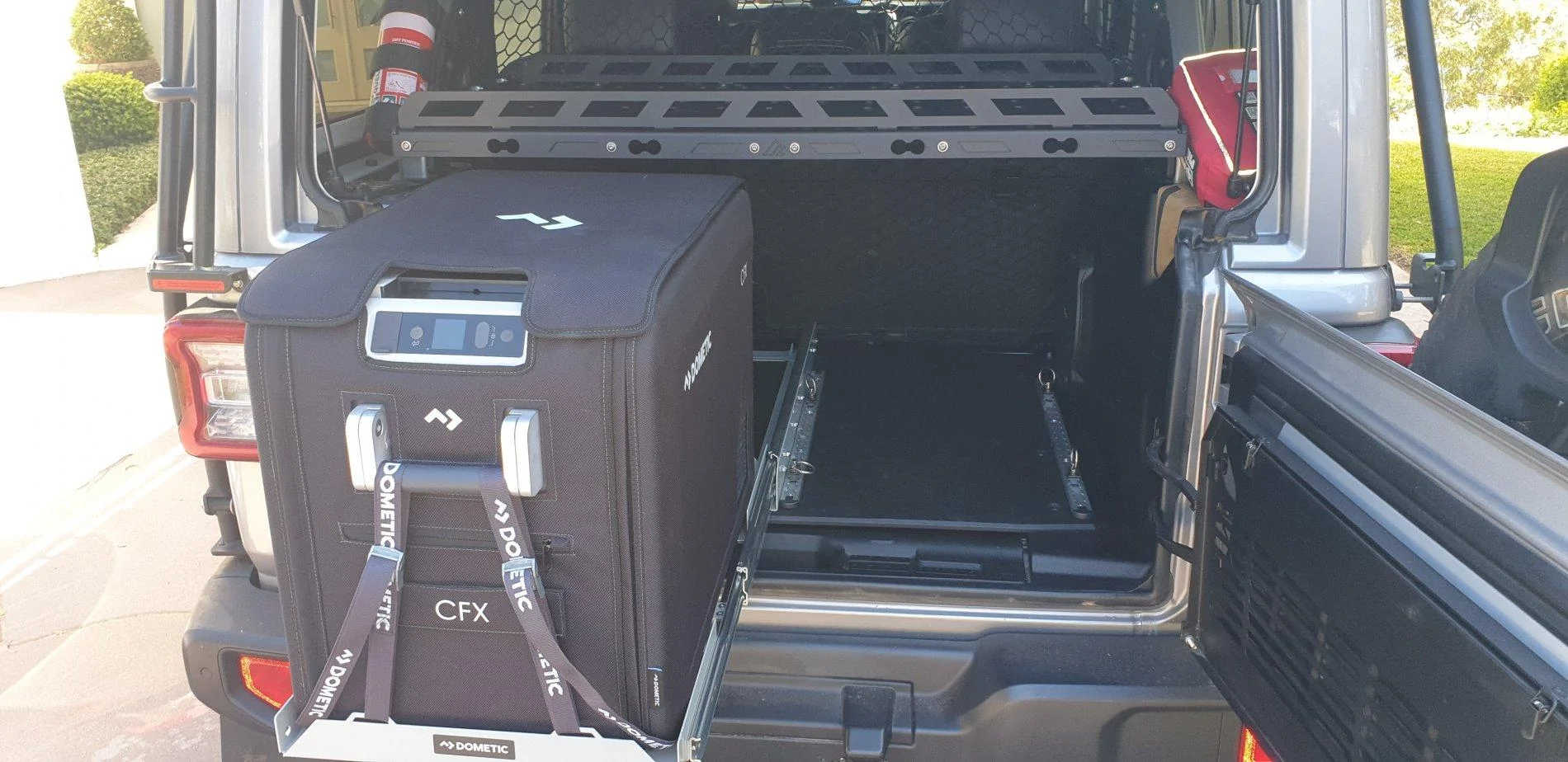

Hi,
I have been getting my rig setup for overlanding. I have installed a 120AH AGM battery and DCDC in the rear tub to power my fridge, lights and water pump. Since the JL Wrangler has a variable Alternator, the DCDC suggests connecting to an ignition source. I have connected to the Ciga Aux power in the back and I have the fuse in the IGN position so it is only getting power when the ignition is on. The DCDC works fine and goes into the right modes etc. The problem is my ESS (Start/Stop) no longer works and the dash show ESS not ready Battery Charging. If I disconnect the IGN source (pull the fuse) this problem goes away. I have fully charged the main battery, Aux battery and the new one. So the DCDC is showing that it is in float mode (fully charged). With the ignition override attached and powered the dcdc will start charging the battery at 12.2v and stop once if the voltage drops below 11.6v. Without the IGN source it is 13.2v start and 12.6v stop.
Any ideas on why this affects the ESS?
Given the variable voltage alternator have others achieved enough charge without the IGN override?

One thing you can do is temporarily place a fused jumper between two adjacent fuses in the Power Distribution Center (PDC) and disconnect the ESS battery to see if that solves your problem.
While this technique has been written up on the forum before, it involves opening the cover to the PDC: that black box on the top of the engine bay nearest the front passenger seat, and finding the fuses within the PDC closest to the driver's side front of the vehicle. Those two fuses are N1 and N2. A fused wire between them will permanently connect the two batteries in parallel. Out of the factory the PDC, as you may know, disconnects those batteries for an instant before cranking the engine and during ESS events. Let me know if you need links on the forum to this process.
Secondly, temporarily remove the negative cable from the ESS battery to the main one by disconnecting the factory cable on the main battery's negative post that is closer to the front passenger's quarter panel. (The cable closer to the driver's side is the body ground cable.)
What these two steps do is trick the vehicle into thinking that the main battery is also the ESS/Aux battery. See if this temporary change restores your ESS with the fridge charger running. If it does, it may point to problems with your ESS battery: a common occurrence.
I'd reverse both cable changes if you intend on running ESS, and like Will above said, this change will give you at most 6 ESS events per cold crank because the vehicle is designed from the factory to disable ESS after 6 checks of each battery's voltage (ESS/Aux and Main) being identical: suggesting a malfunction. Of course with you running 1 battery the vehicle will detect the voltages to be identical in this setup because you're only running 1 battery.
Other than that, the only other thing that I can think of is maybe your Intelligent Battery Sensor (IBS) that sits on the negative terminal of the main battery I believe, might be faulty.
Or maybe, set your DCDC charger, if possible, to not charge your refrigerator battery if the combined voltage of the two factory batteries, as detected in the cigarette plug, is under 12.5, AND restore that cigarette plug to its default behavior of always being energized, as per the factory, and see if that changes things.
