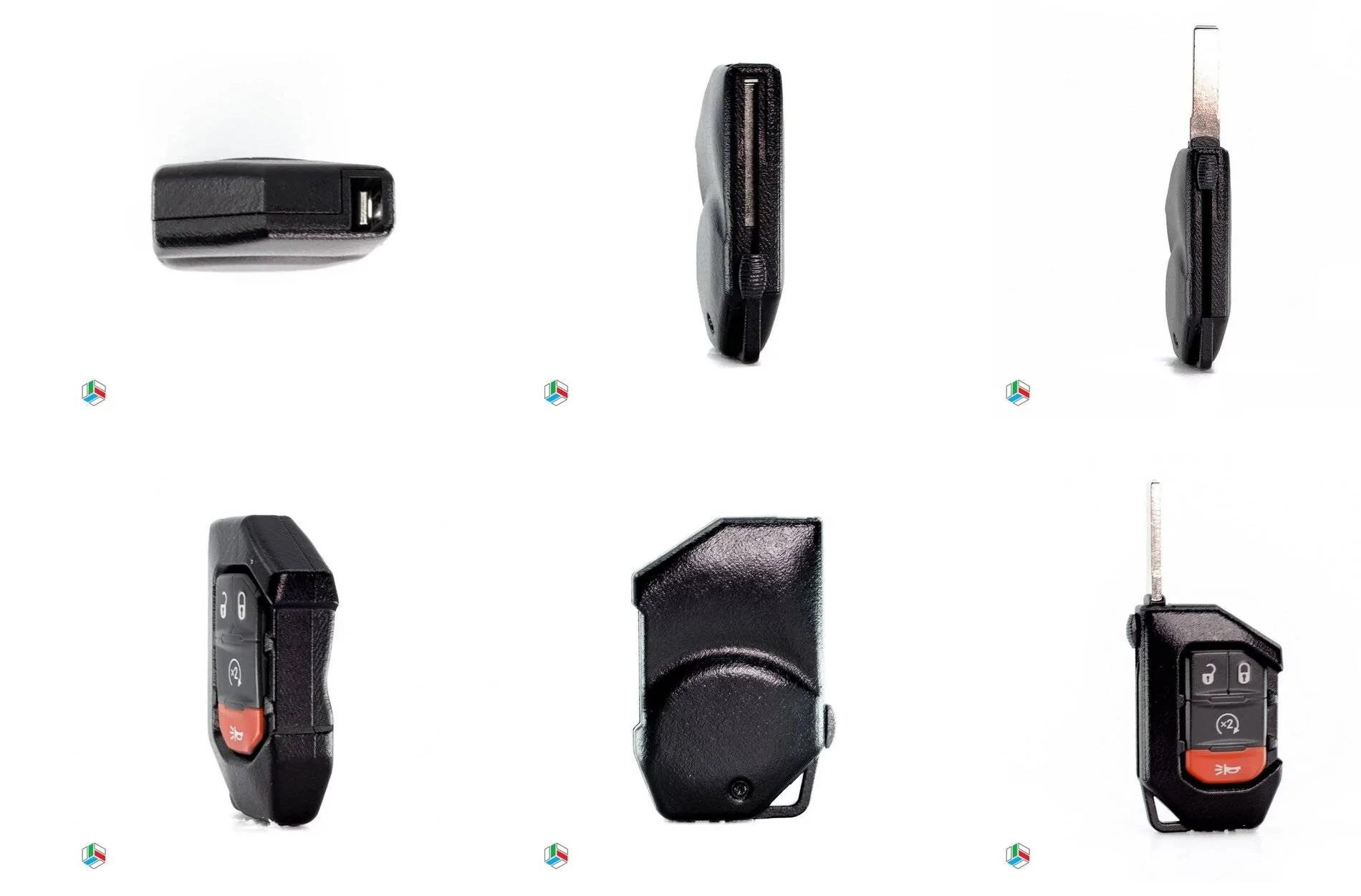

Well the time has come!!! You can now pre-order the DI Labs Model S+ . They will start shipping on 10/23/21.
Can tell you the S+ fob is way cool... Has retractable key and the slider lock is excellent.
The Model S+ which uses the stock button pad is quite a bit smaller then the stock JL/JT fob.
The Model S+ comes in different textures and patterns to include smooth...
Can tell you the Model S+ is a pleasure to have... to use..!
