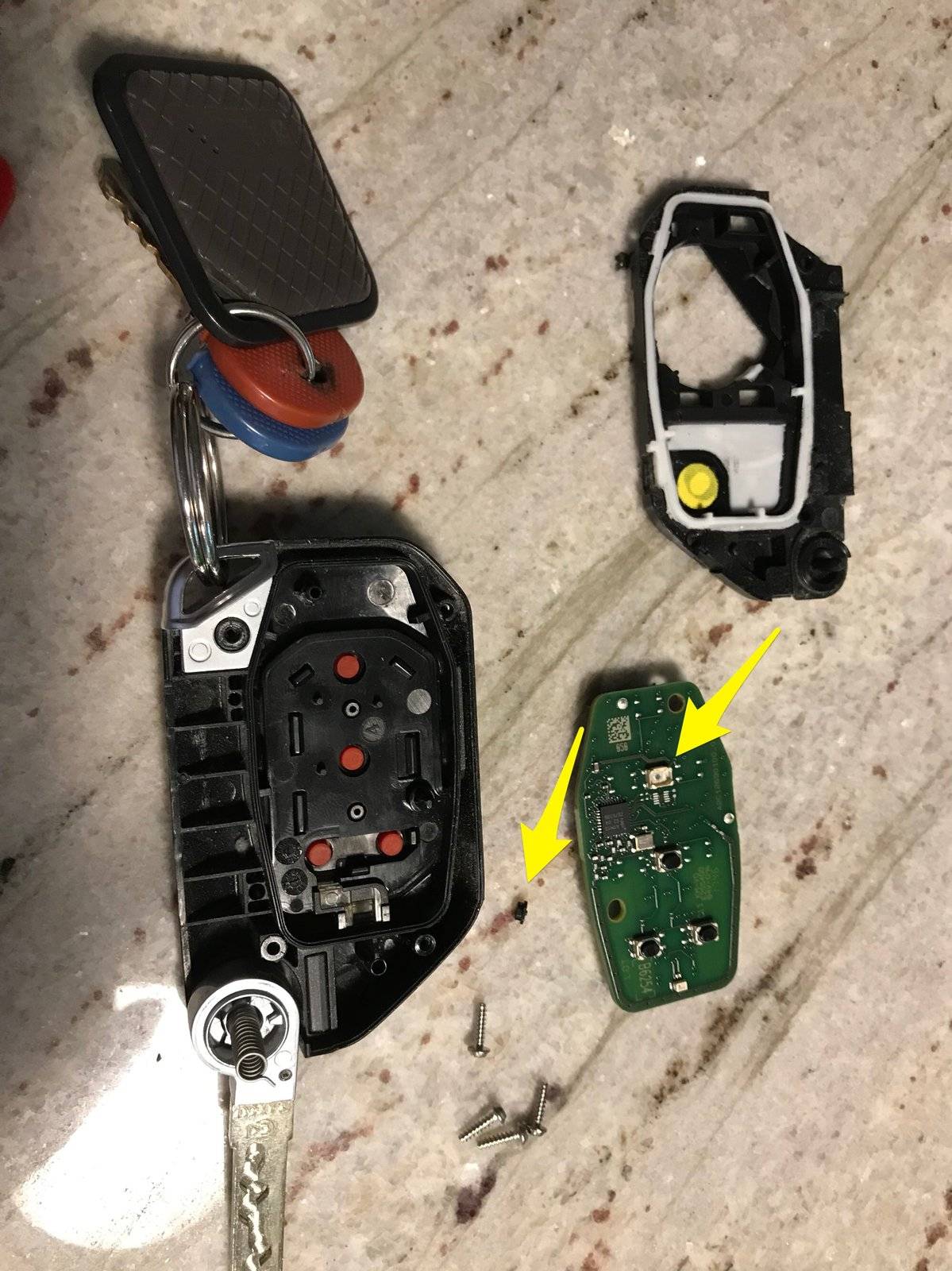

With any fob... whether it is a stock, AJT Designs, DI Labs.... there are easy ways to mod it, so panic button is non usable. These two mods iare non intrusive and do not damage the circuit board... Both, very easy to do..
Just take a small, very thin plastic disk or square and place it in the fob between the button press pad and the micro switch on the circuit board that triggers the panic alarm. The disk/square prevents the micro switch from being pressed down. The disk/square does not damage the micro switch...
ANOTHER WAY .... the small rubber trigger for the Panic button can be removed easily with a tweezers..... and without damaging anything. No rubber trigger and the Panic button is non functional. Of course, be careful to save the rubber trigger so you can put back in place if / when you desire to do so... It goes right back in....
See pics below of before and after rubber trigger removal from JL circuit board. 2nd pic shows small black rubber trigger removed.
IF you have a Tazer JL, it has a disable Panic Button feature.
Good stuff, thanks that's gone off couple times in my pocket and super annoying! Now if the giant key didn't flip open so easily and stab me in the leg LOL.
