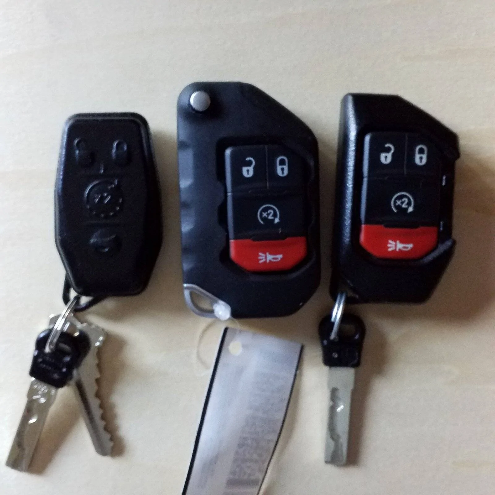

@blink9cd
I encourage you to disassemble your stock fob now, and place the disassembled fob in a zip lock bag...
Careful with the tiny tiny roll pin that secures the key as it can go missing quickly.
Doing the disassembly a head of time makes THREEDOM fob assembly day / when the THREEDOM fob arrives a more pleasurable day...
If you wait til the THREEDOM fob shows up.... and then start disassembly, you will find yourself rushing..
You do want to go slow in regard to the stock fob disassembly... Disassembly is quite easy but you want to take your time getting the RFID free from the stock fob...
IF you RFID chip resists removal, walk away for a few minutes and then go at it again... Some RFID's come right out and some make you work a tad at it... 8-)
You are really going to like/enjoy your Model M.
