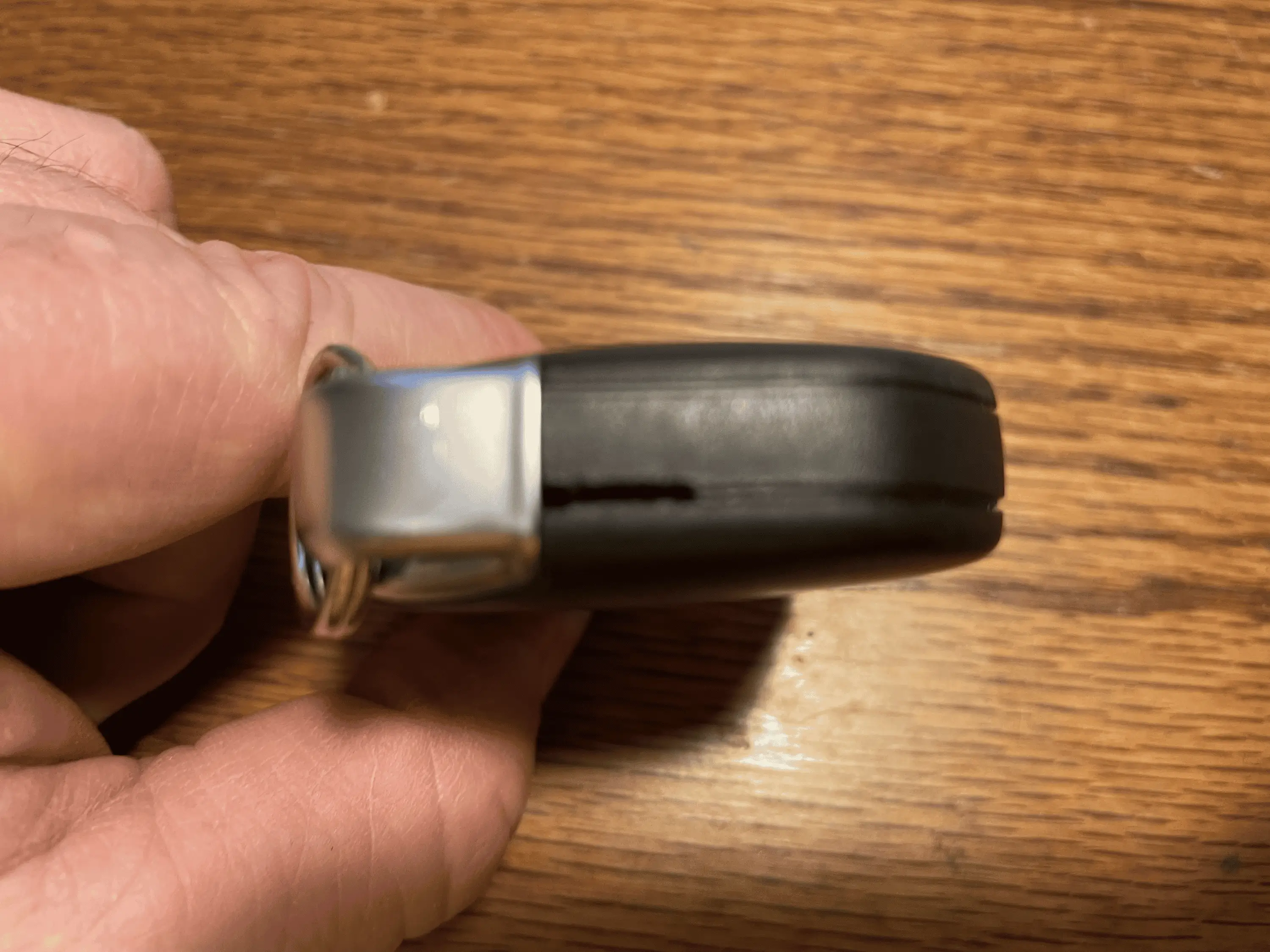

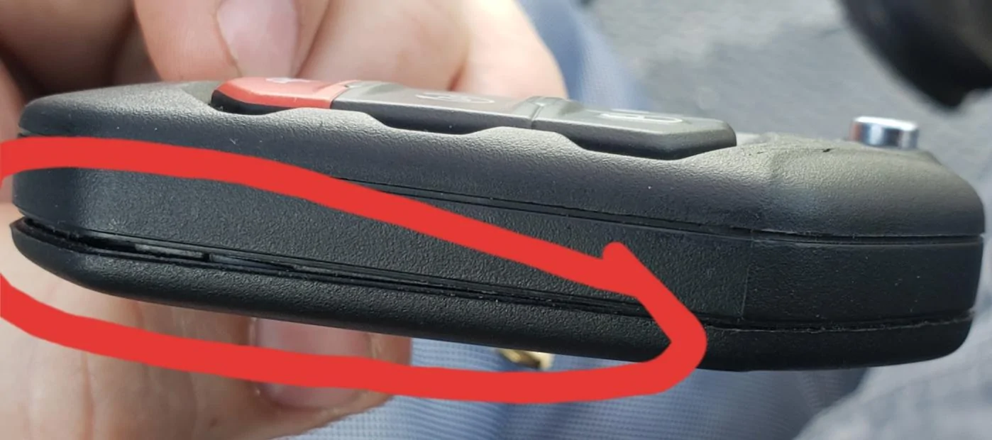

My key fobs both have the gap on one end like it’s not closing all the way. Took them apart and put back together and no matter what they won’t close. Design/manufacturing flaw is my guess. Only issue I see is that moisture might get in the fob because the seal isn’t closed like it should be.
Yeah, both my fobs are like this
Mine have the gaps as well.....
Brand new rubicon here. Both fobs looks this way. Lololol!
Hello everyone,
Please know the fob's are designed with a small gap. However, if you believe the gap in your fob is not working in spec, we would kindly recommend reaching out to your certified dealers as they will be able to properly diagnose. If you decide to go this route, please do not hesitate reaching out to us privately if any additional assistance is needed throughout that process.

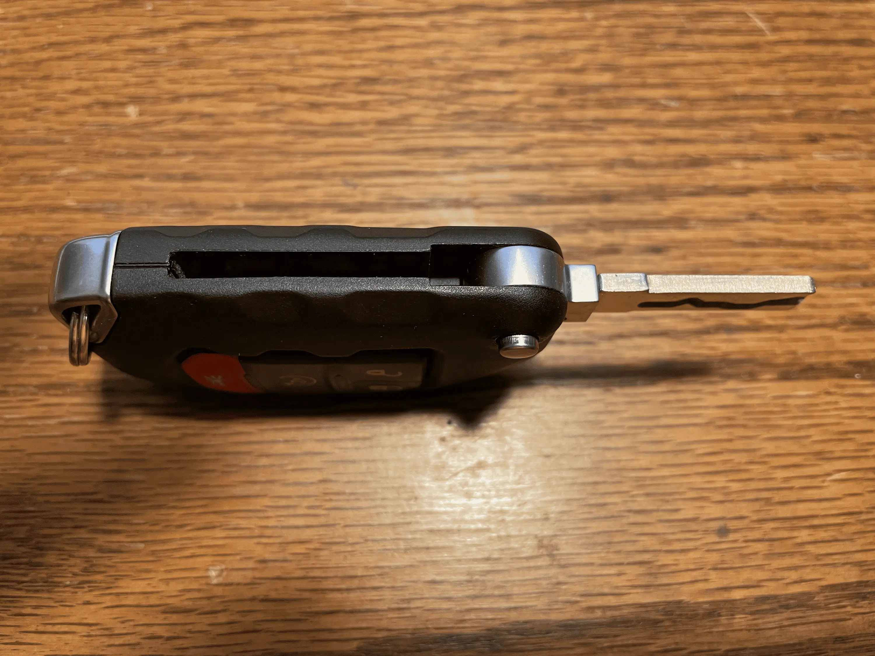

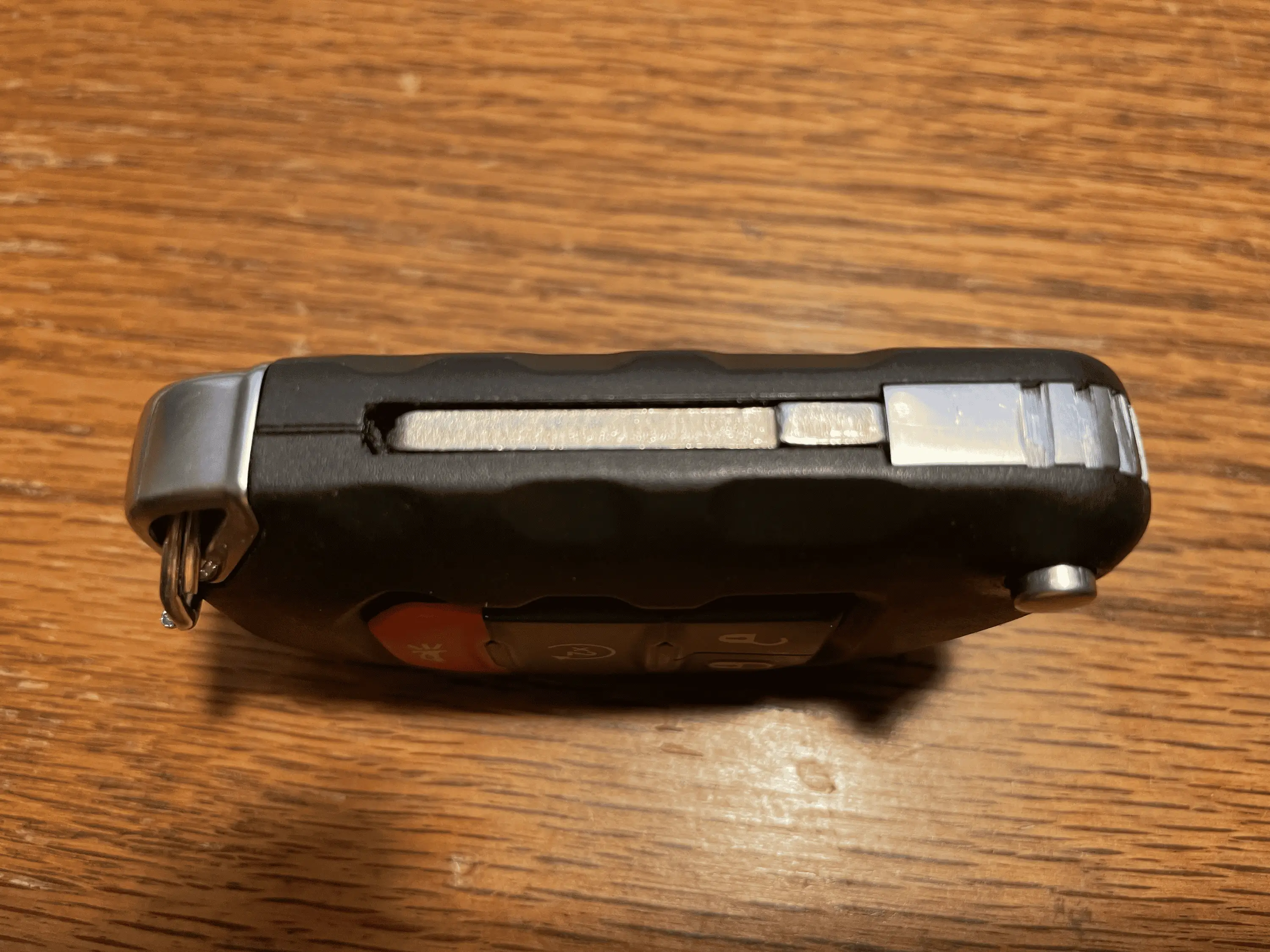

I found a solution to the key fob issues. • Back cover split open • Switchblade key stabbing you in the leg when in your pocket
If you cover is spit open, do this... Take the back cover off, remove the battery, remove the torx head screws, remove the battery tray, remove key/spring/button. Notice how the button works with the key and how the spring tabs into the battery tray. At this point, you can fix the key stabbing you! IF YOU DON'T WANT THE KEY TO FLIP OUT. ADD SOME KNURLS TO THE OUTSIDE CURVE OF THE KEY, PUT THE BUTTON AND SPRING IN THE KEY, PLACE THE SPRING INTO THE BATTTERY TRAY SPRING CATCH, WIND THE KEY 3/4 THE OPPOSITE DIRECTION. If you like the switchblade, do the same as above but wind the key in the open direction. Put the but the battery tray and button tray together, make sure it all settle flush, reinstall screws, reinstall battery, reinstall cover and BINGO your done.
Project Time: ~10 minutes
