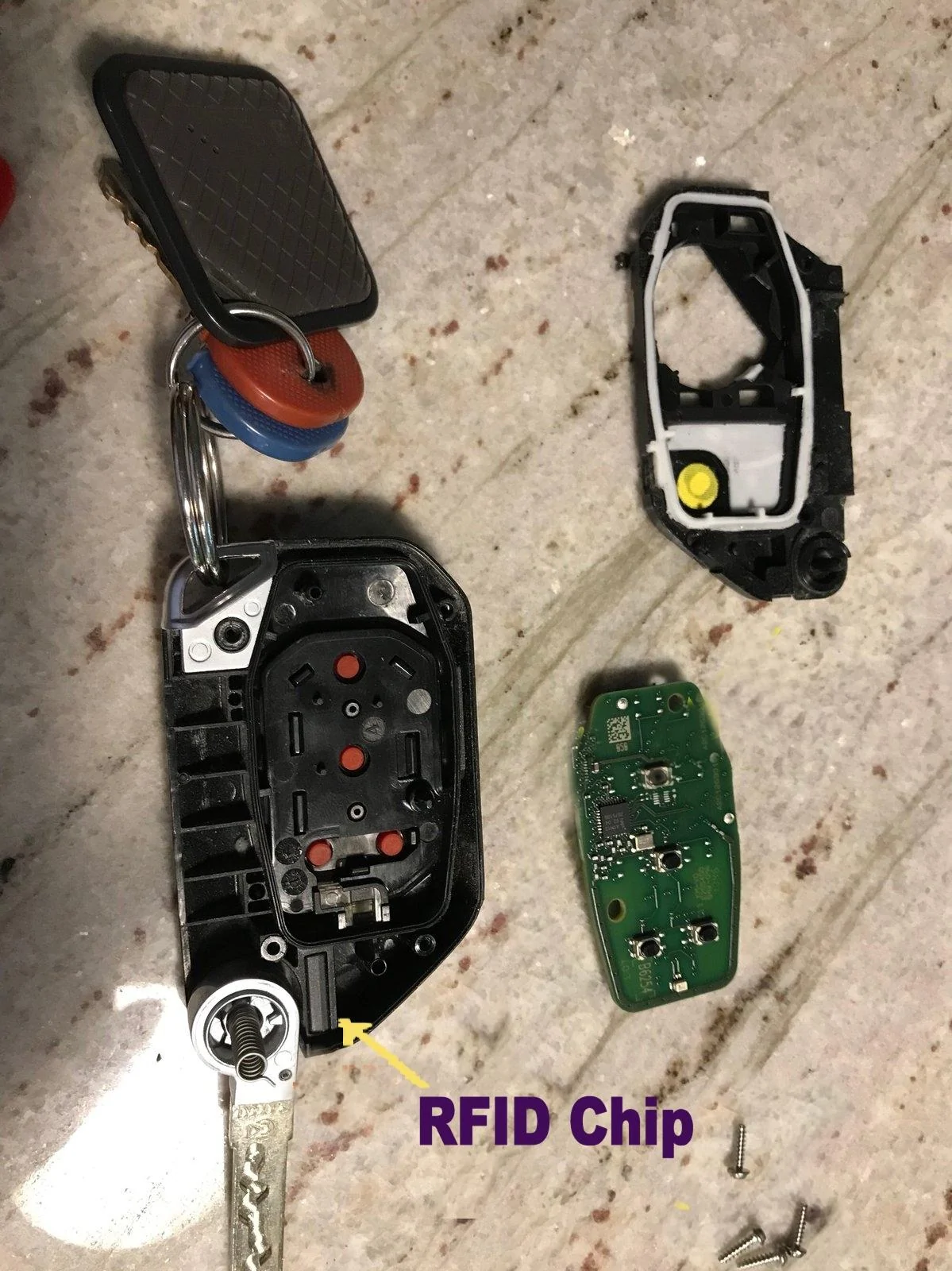

Well, if the fob battery "dies", you will have to open your JL /JLU /JT with the key on the fob and deal with the security / horn alarm as you did last time...
You'd get into the JL, and to start it, you would take the end of the fob that has the key attached to it and press that end directly against the JL's starter button while at the same time you are holding your foot down on the brake pedal.
The JL will start up and is driveable at this point.... until you turn it off and have to press the fob against the start button again to start it / drive it.
See the yellow arrow in the picture below that points directly to the RFID chip that is placed/secured into the end of the stock.
Were you to take that RFID chip out, you can use it alone, to start your JL..... you do not even need
the fob or circuit board/inner's of the fob anywhere near the JL.... just the chip, in your finger's pressing on the button is all it takes...
