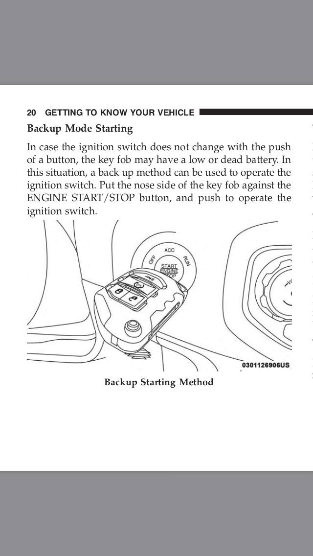

Are you able to start your Jeep? Will it start if you use the fob to press the start button? That’s what the owner’s manual recommends.Two months in and key fob is dead. Hopefully it’s just a battery. Anyone else experience this?
What would really suck is not being able to discover this if your jeep won't turn on, thanks to not being given a printed manual.....Are you able to start your Jeep? Will it start if you use the fob to press the start button? That’s what the owner’s manual recommends.
I was wondering if you are able to start your jeep with the fob battery removed using this method.
Even worse is if you print out the relevant page , and then don't read it , and then lose the key fob .What would really suck is not being able to discover this if your jeep won't turn on, thanks to not being given a printed manual.....
Hi Jeffinstl,Two months in and key fob is dead. Hopefully it’s just a battery. Anyone else experience this?
Yes, this is how I’m able to start it. Assuming it’s a dead battery but taking the Jeep to the dealer for them to replace the mismatched fender (hopefully) soon and will have them take care of the fob too.Are you able to start your Jeep? Will it start if you use the fob to press the start button? That’s what the owner’s manual recommends.
Someone posted a youtube video where the guy starts his JL using this method after he removed the battery from the fob.Are you able to start your Jeep? Will it start if you use the fob to press the start button? That’s what the owner’s manual recommends.

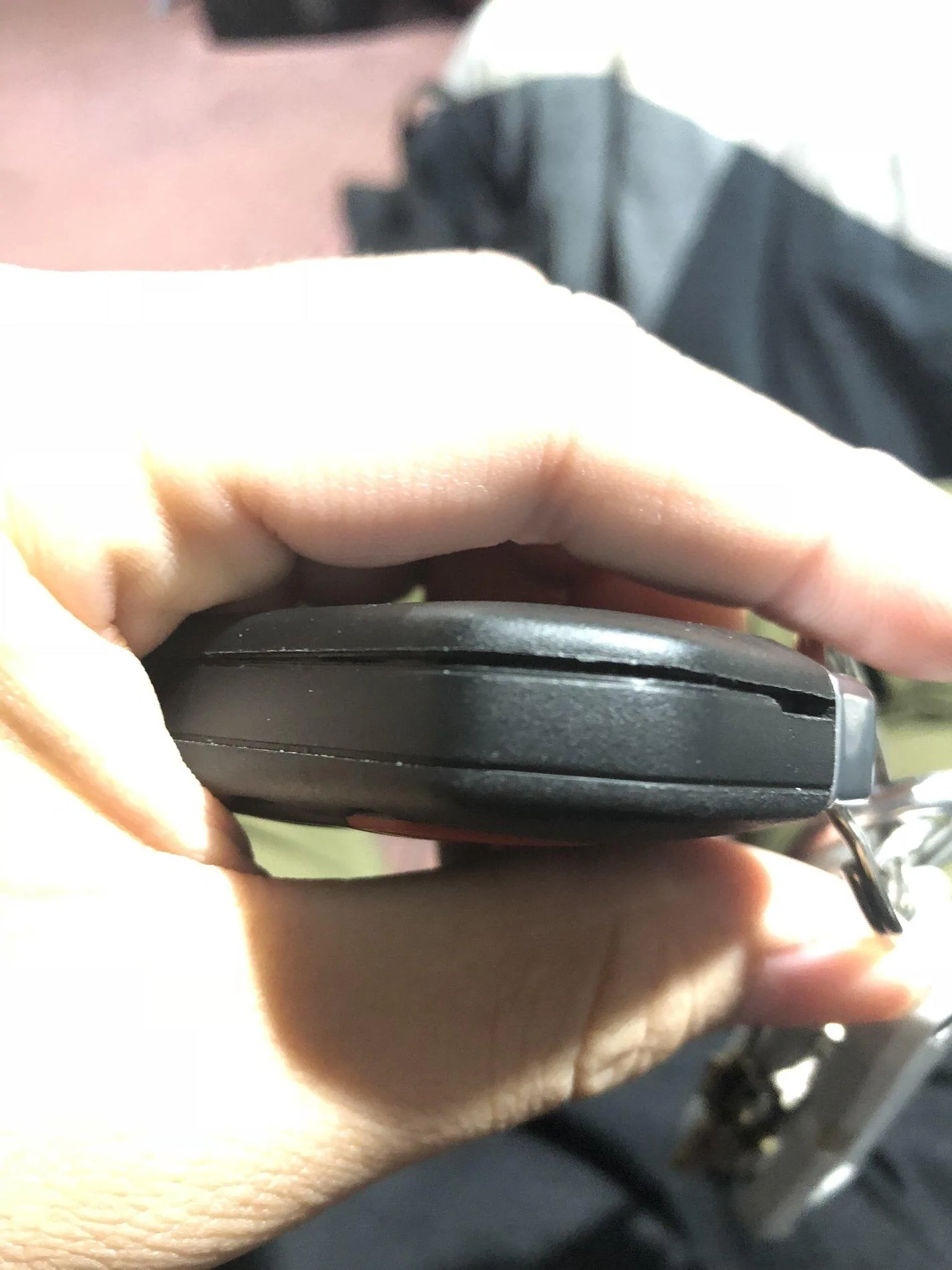

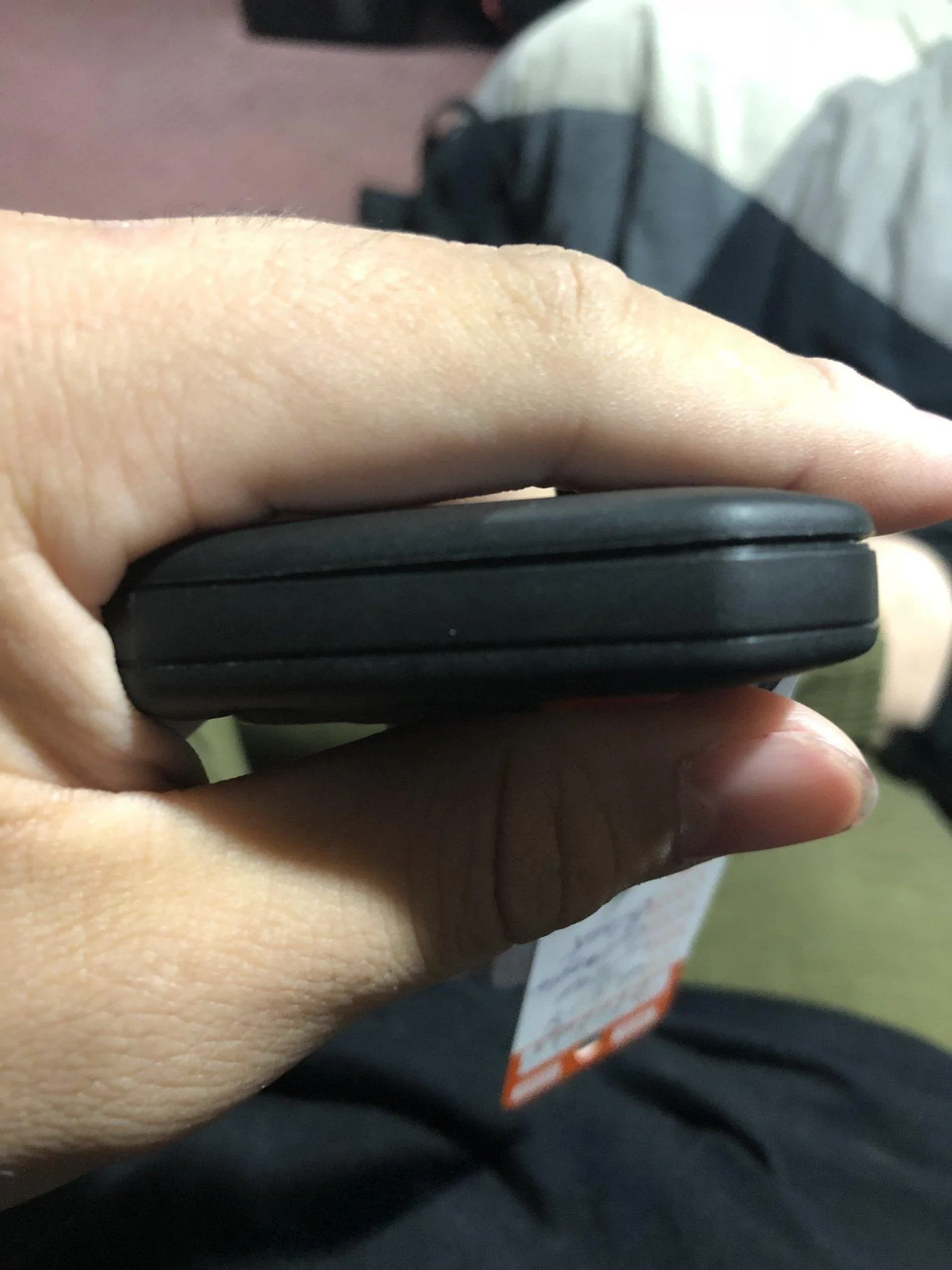

Can you post a picture of what you mean?not to hijack your thread or anything but does anyone elses keyfob have a gap like its not clipped in all the way? both of mines has a gap. took it apart and put it back and its still the same.
Same here, the case is not sealing properly.Hopefully you can see it. Both are different keys.
