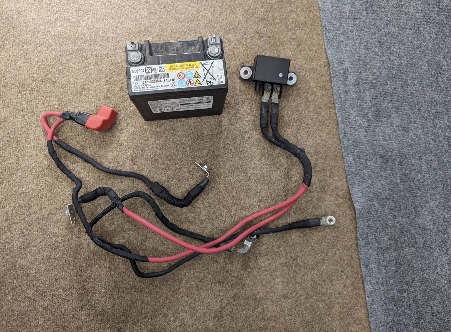

The black negative cable at the aux battery can be removed or it's terminal insulated. The red positive cables are already together at the aux battery terminal in the stock installation, but a bolt may be needed under the red terminal cap. See the below photo of a removed aux battery and it's cabling, which is from another owner on this forum.
To be clear about your assumption, ESS still operates after the aux battery negative/F42 disconnect. You have to either use the dash shut off button, or resort to aftermarket hardware/software, to prevent ESS operation.

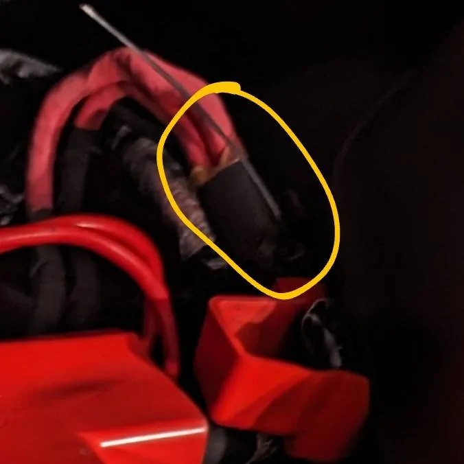

Minor point of clarification: the two positive AUX (ESS) battery cables are in fact crimped together on one connector.
Best photo I have:

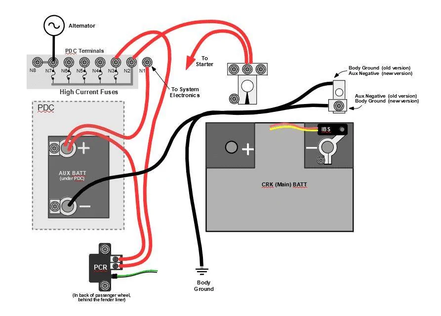

I'm not that fortunate. That photo is very helpful, but I was wondering if anybody has a simplified schematic that shows the starting and ending points of those cables? I know that once I remove what I need to remove I'll set it and forget it, but it would be cool to have a schematic to kind of know how it works while I'm dismantling it. My guess is that the two red cables that go to that smaller box is for a fuse? And 2 of the flat bladed pieces would go to the positive and negative terminals on the main battery? That leaves one random unexplained blade and one other end that I assume goes to a body ground?
