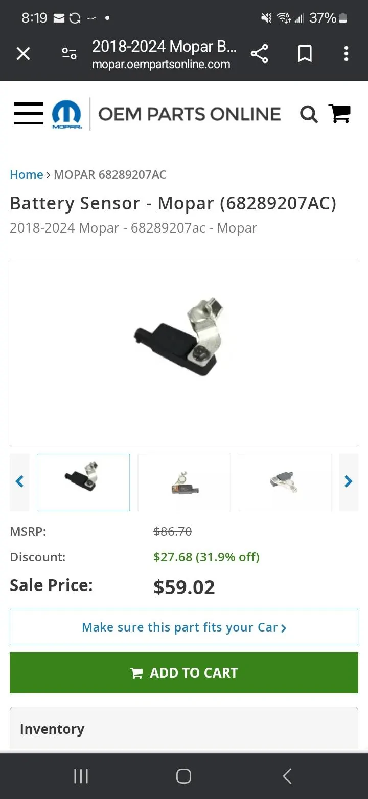

So a month ago I did this bypass, removing the fuse and disconnecting the negative cable for the auxiliary battery and yesterday I started getting the ESS service warning indicator. Any idea why this is happening? Main batteries fully charged no taser no other modification. I have an 2018 JLU sport.
Same issue.. I think our IBS sensors faulty and needs to be replaced.. light randomly goes on so sometimes its fine.. runs fine for now.
