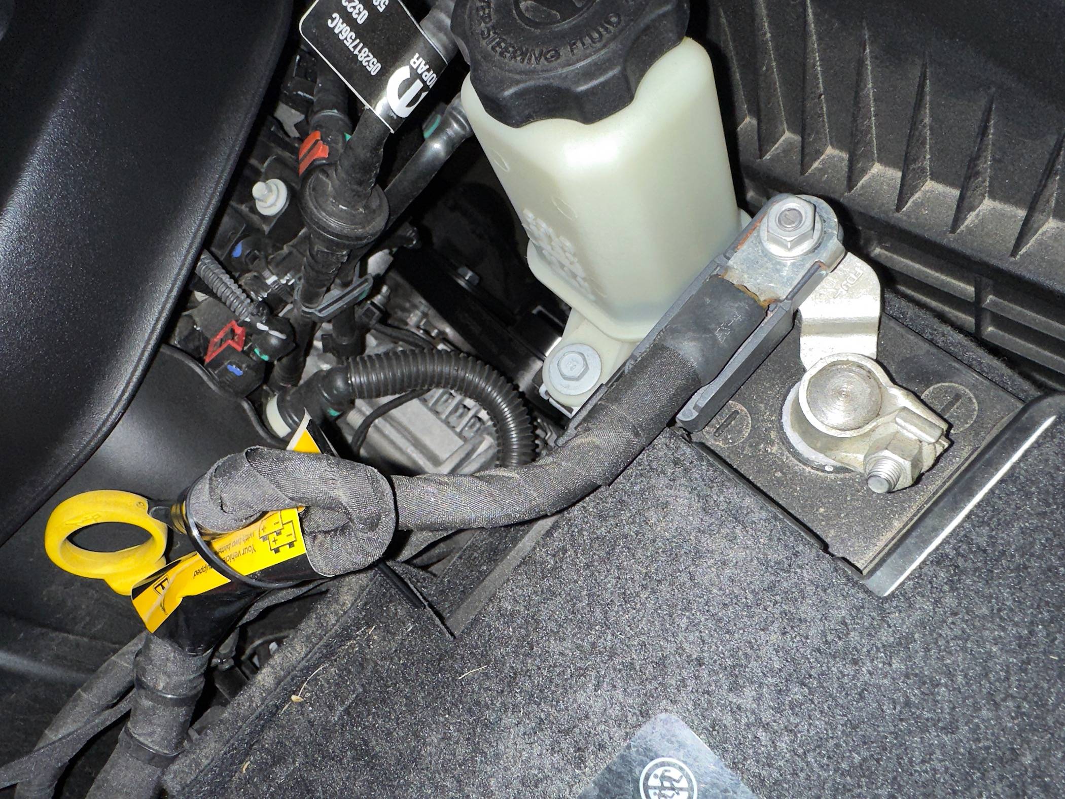

On Friday I joined the "no start" Wrangler club, with the vehicle less than 3 yrs old. Obviously the original Mopar batteries are POS', so I'm going the H7, aux batt isolation route. I have one question for those who have done it on a 21 up, which has the main ground as M8 and the terminal on the IBS as M6. Did you just put the M8 sized lug on the main ground cable, onto the M6 IBS sensor, or did you fab a bracket with both M6 and M8 sized holes, to keep from having any slop, with the M8 hole on the M6 stud ?

I just did this on my ‘22 yesterday. I just put the m8 over the m6 and tightened it down snug. No problems. I also plan on leaving the abandoned aux battery in place in the jeep.

Thanks for the info.....makes it simple....?
