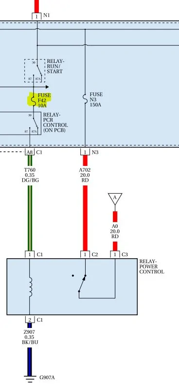

While working on another project, I was looking at the fuse descriptions on the underside of the PDC cover and saw this - F42 PCR CTRL FEED (ESS)*. Could it really be this easy? Yes it is. I pulled the fuse, disconnected the aux negative cable from the main battery negative post and it started right up without any errors.
Unplugging the PCR has always been an alternative to using an N1 N2 fused jumper, both methods defeat the aux battery pass/fail test that occurs prior to a cold start. Unlike using a jumper, unplugging the PCR doesn't require any additional parts, it's just not easy to get to the PCR plug. Removing the F42 fuse accomplishes the same thing as unplugging the PCR and the fuse is easy to get to.
Other than a couple starts, I haven't had the chance for real world testing, but I did look at the schematic and verified that pulling the fuse accomplishes the same thing as unplugging the PCR, both prevent the relay from activating.

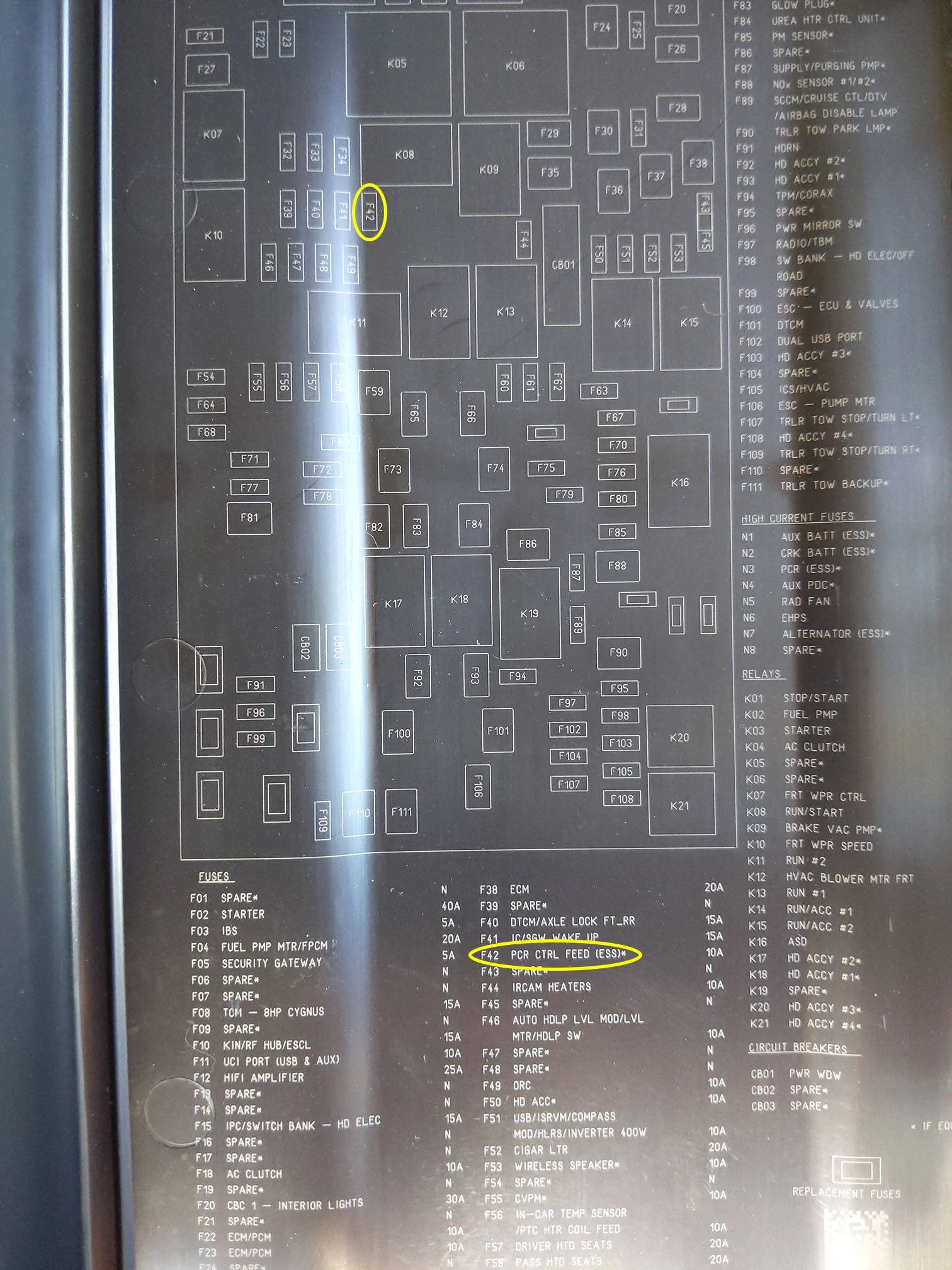

Here's the underside of the PDC cover showing the description and location of the fuse.
Here's the fuse location with the fuse removed.
Here's the schematic showing the fuse in the circuit.
