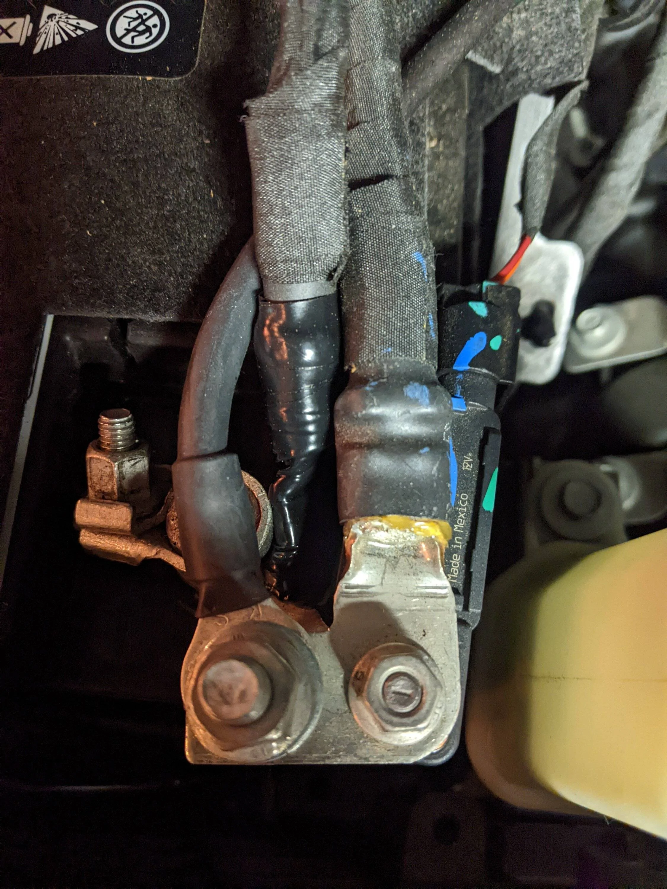

Here's my JL negative cables. Changed again! The aux battery is the flat with post that's attached with small bolt. I will need to swap to a longer bolt to add my winch and compressor ground to.

I’m dying over here, 2020 3.6L main battery tests 12.7 - I disconnect both grounds each and a dead Jeep, hook them both back up and Jeep starts.. I’m baffled..
yanked F42
Disconnected smaller ground
Then larger one
Will not start without both grounds connected. Ugh

sorry I should of explained it better no matter which one I disconnected the jeep will not start unless both are connected. Smaller ground off only and nothing, larger ground off and nothing then I connect both back on and it starts. Main battery 12.7 disconnected and out of the jeep.

yes I did have f42 pulled the ESS and disconnected the thinner ground, jeep did nothing then I switched the grounds and nothing and then hook them both back up and the jeep starts. Took the battery out it reads 12.7 while it was out I confirmed smaller ground was the aux and did it again, fuse is out, removed small ground and nothing.. hook them both back up and she starts again.

Taser mini is installed and operates awesome I’m baffled…. After both grounds were secured I started the jeep and drove it without the fuse in and no dash light either, Im totally at a loss for words I followed everyones directions as if it weren’t easy enough but testing my battery out of the jeep was just an added bonus to help figure out what is going on.
