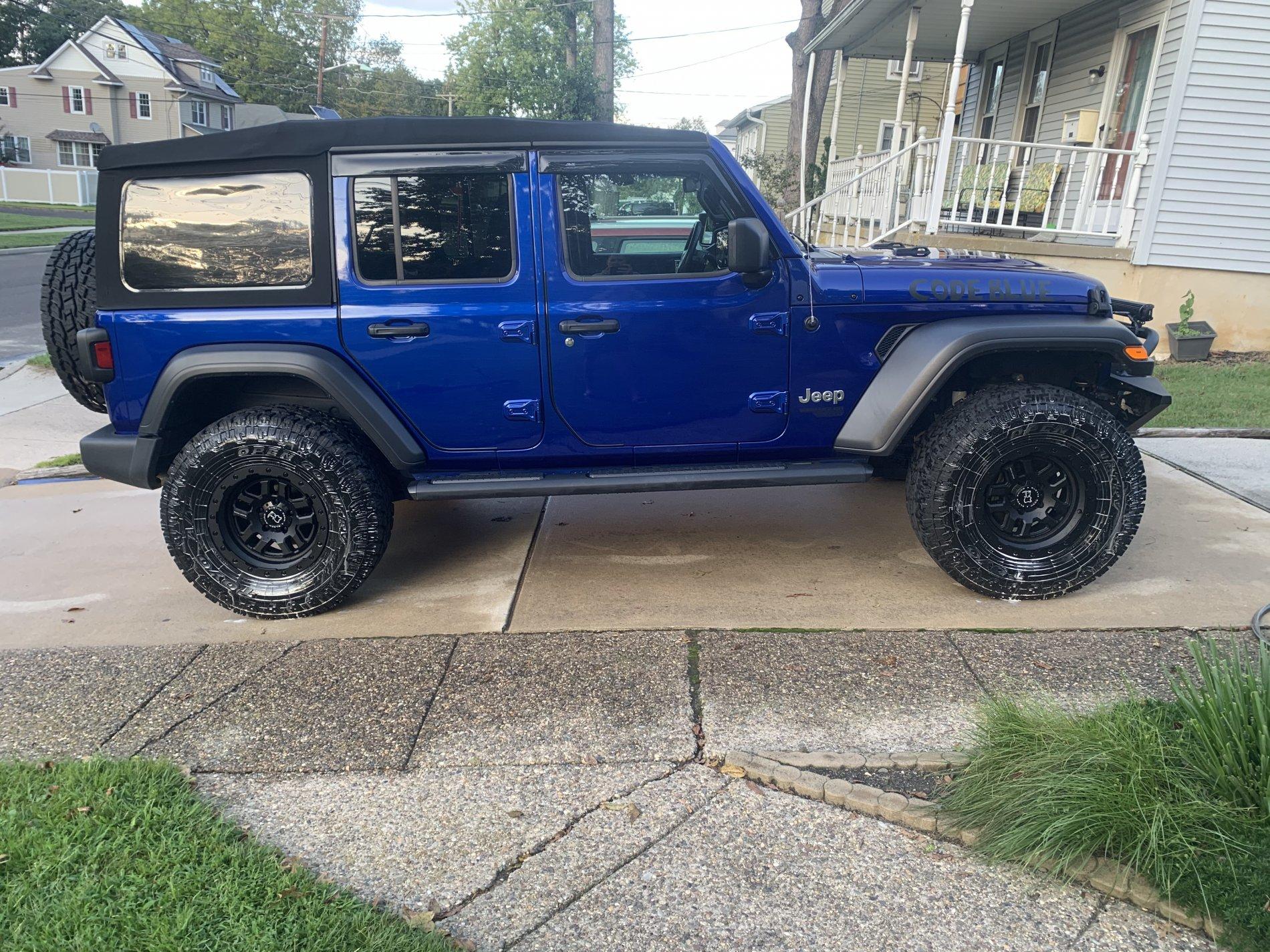

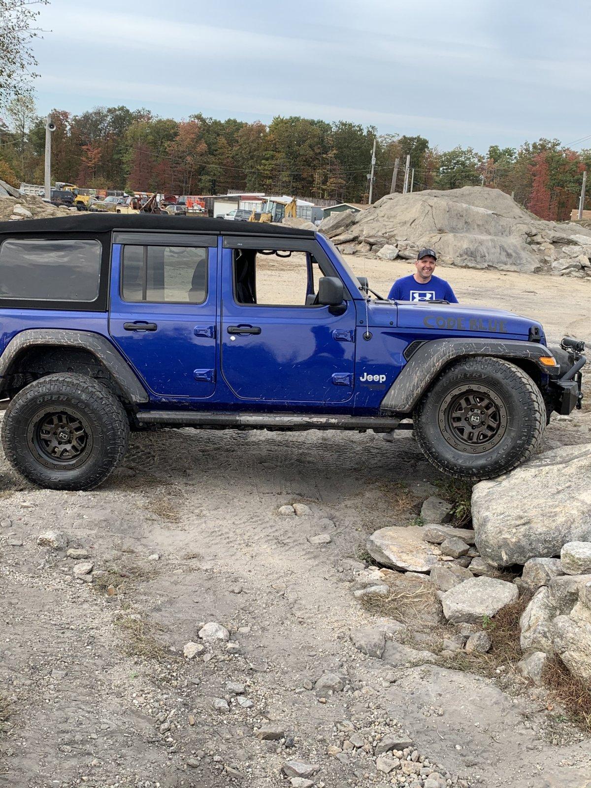

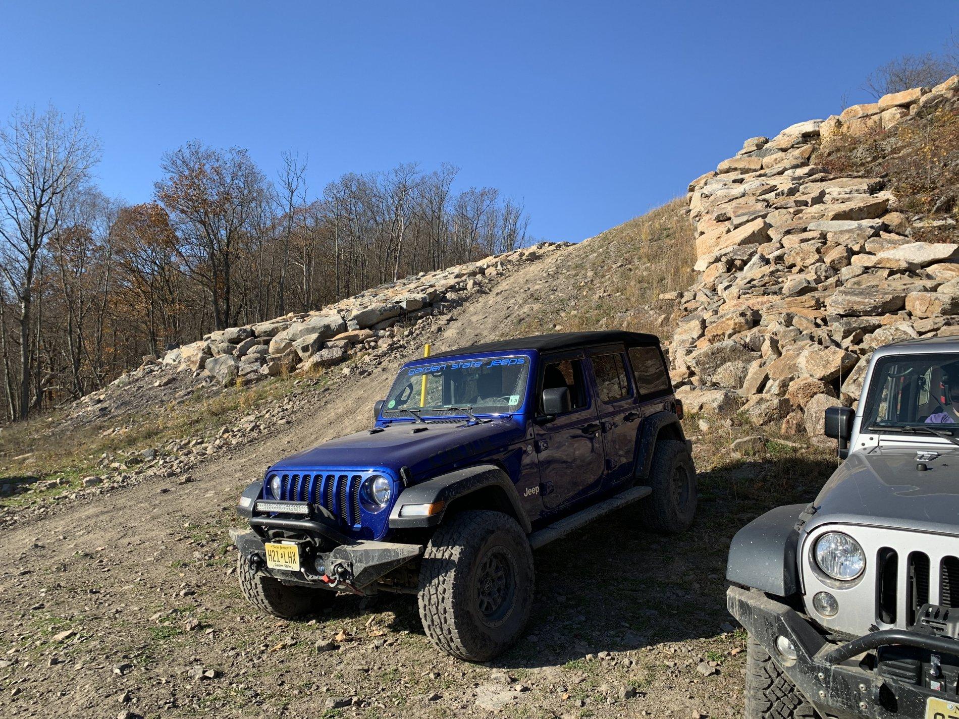

You don’t need a complete lift with these newer jeeps. You can go a 2.5 spacer lift and fit 35’s and do some pretty difficult trails. I’m not saying a trail rated black or above but I’ve done some pretty decent blue trails on a RC 2.5” spacer lift and the correct length shocks with no issues. Didn’t even have to adjust anything after the lift. Check out Raush creek reviews and you will see a lot of their blue trails should probably be a blue/black if not a full on black.

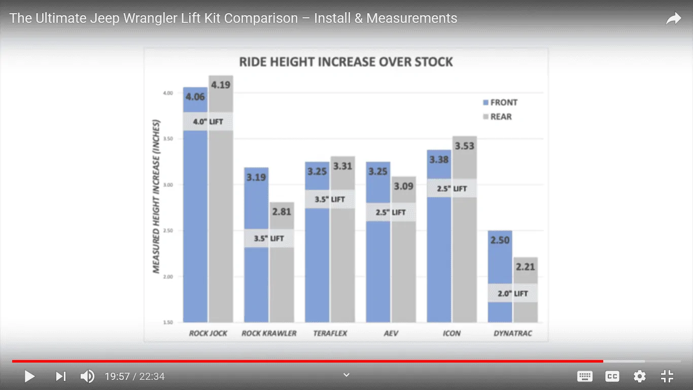

On Part 1 he covers prices, ease of installation, and the lift and articulation numbers --see video at the bottom.
Ironically, the 2.5-inch Icon lift provides the 2nd greatest lift --see screen shot below.
Jeep Wrangler JL JLUS Build Advice needed 1607704182036

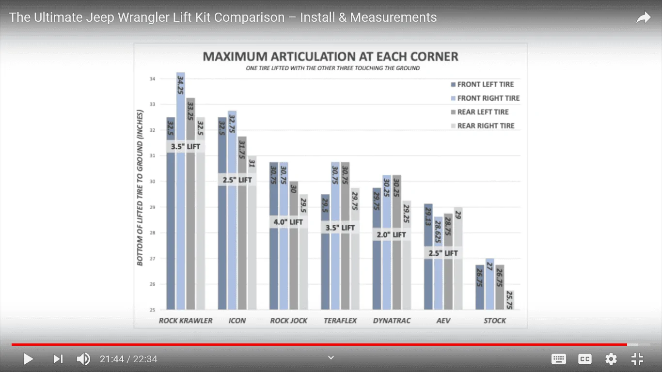

Also, I was surprised that the RockJock with Antirock front and rear swaybars do not offer the greatest articulation. And 2-inch Icon lift provides also the 2nd greatest articulation --see below.
Jeep Wrangler JL JLUS Build Advice needed 1607704953858
However, he already says towards the end of Part 1 that the overall winner, to be announced on Part 2, is not the lift with the greatest lift or articulation.
