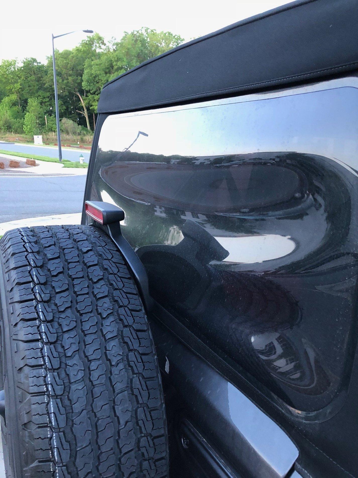

Here are the pics, let me know what you think. I will probably take it to the dealer this weekend and have them take a look at what might be causing this.
Interesting, it almost looks like it was left out under the sun or some intensely hot source and melted the plastic window panel a bit.
Maybe the dealer might be able to replace just that panel if you bring it in.

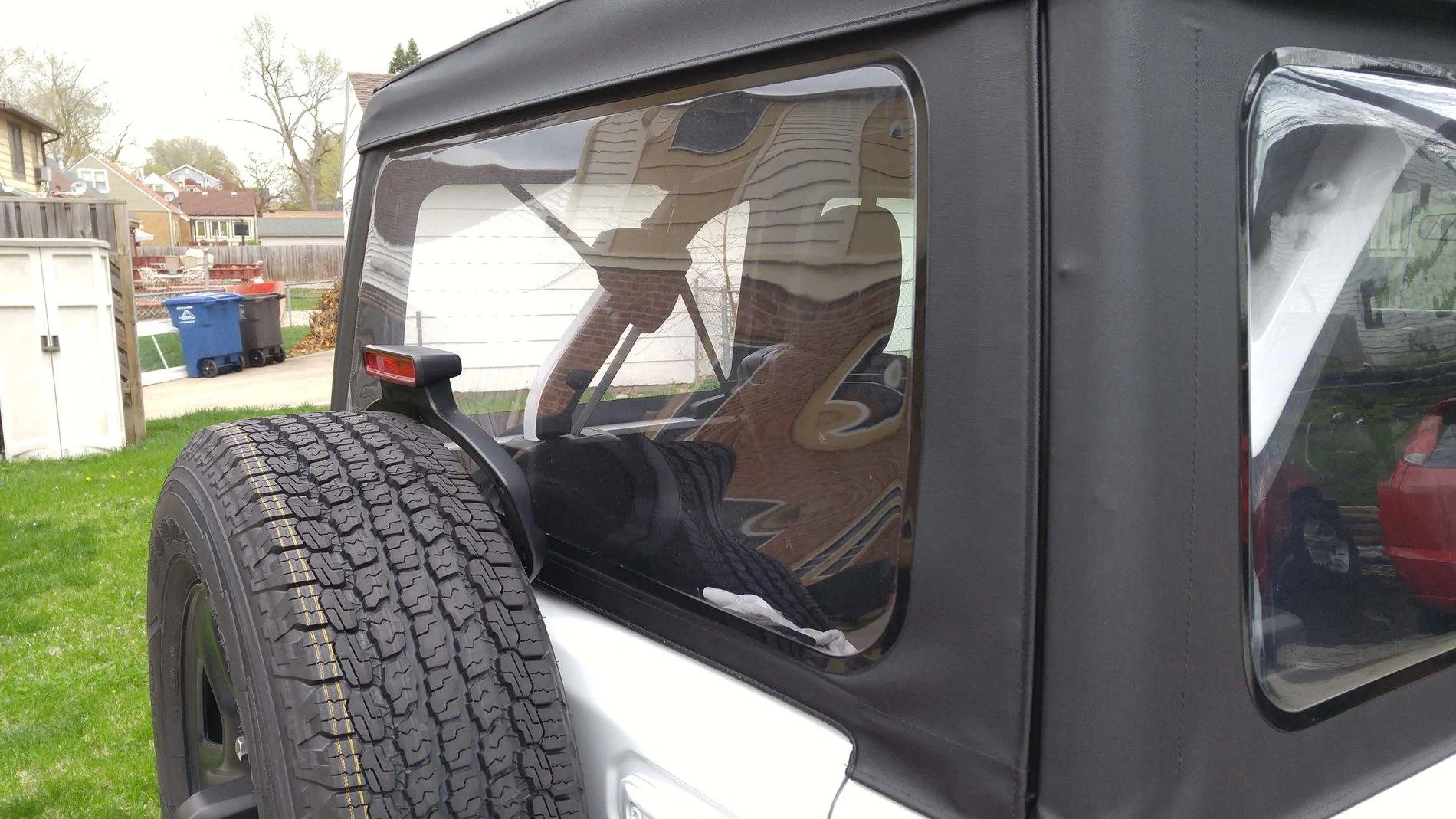

Here's what my standard soft top looks like.
Jeep Wrangler JL JLU Premium Black Soft Top Back Window Sag back_windo

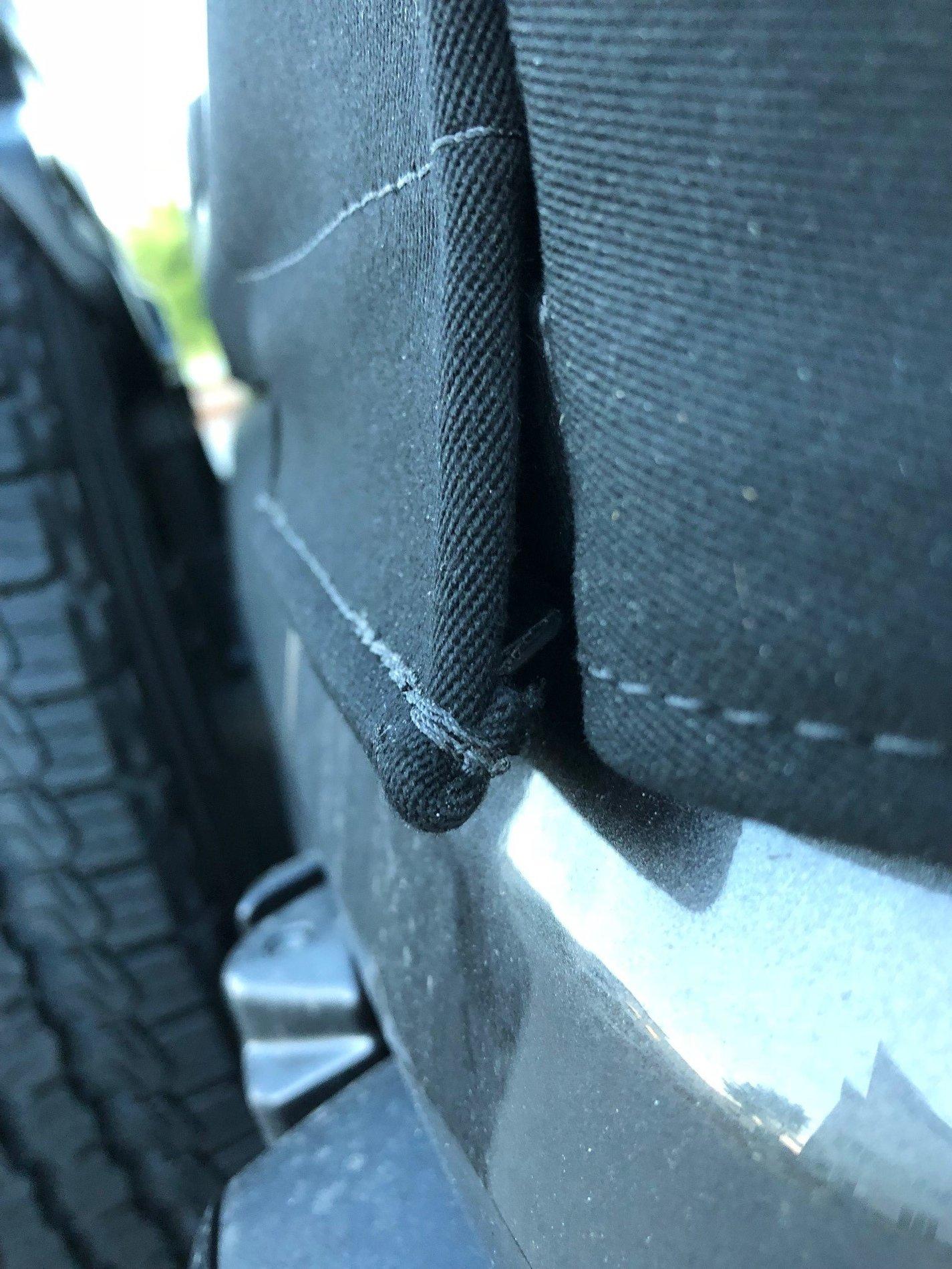

I have the exact phenomena as @mgrowc1. My back window is not sagging but the left clip won't stay inserted. No interference w/ the tailgate.
It looks likes these new premium soft tops have some issues. I just afraid over time my back window will form to that shape and the tail gate will destroy the bottom of the back window.
I guess it's just the premium soft tops? I also noticed, my left bottom window retainer is loose and does not seat snug as the right side. To the dealer I go.

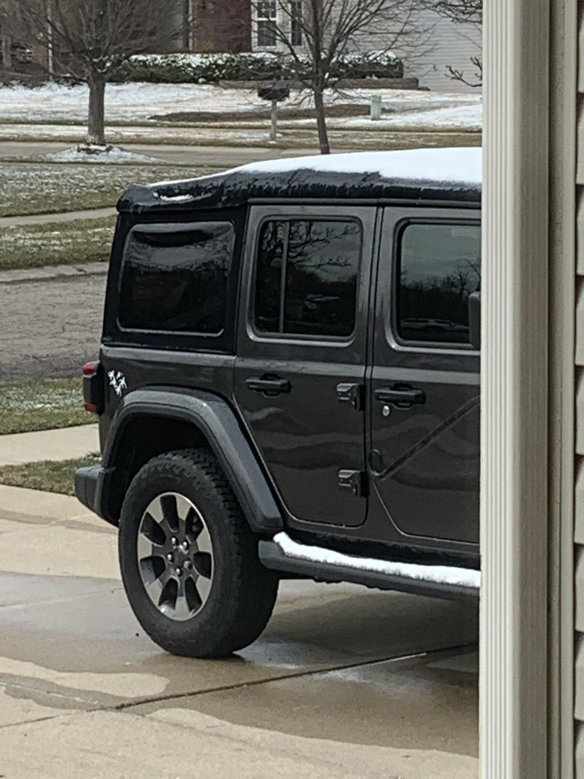

I have a 2018 JLU Sahara with the premium soft top and it has the same sag in all 3 windows as the photos from the original posts. It didn’t used to, then over the summer it started sagging more and more and never rebounded. It makes more noise at speeds 50+ mph as a result, which really annoys me. Picture attached.
I took it to the dealer and he said it’s normal and showed me another Jeep from the lot with sagging windows. He basically said “deal with it, it’s happening to them all”. Just fair warning to everyone in warm weather climates... buy the hard-top and then get yourself an aftermarket soft top apparently... unless my dealer is just blowing smoke?

Well....i would say this is a different type of sag. Your clear vinyl window has the same sag I have on my side windows. But what is interesting is the sag you have in the black top near the roof line. Never had that before.
