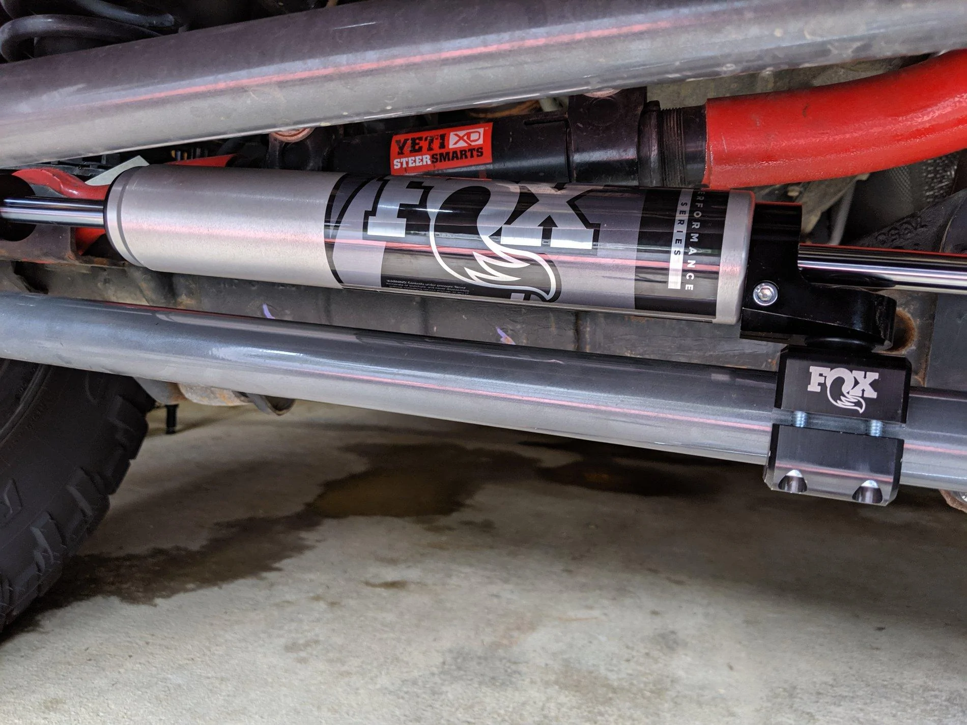

quick update, I flipped the unit around and the pulling went away. I have now had it on for a while and like it much better than the factory one.
Flipping it around has ZERO effect on the force it puts on the tie rod. You changed nothing! Did you really ever have an issue?

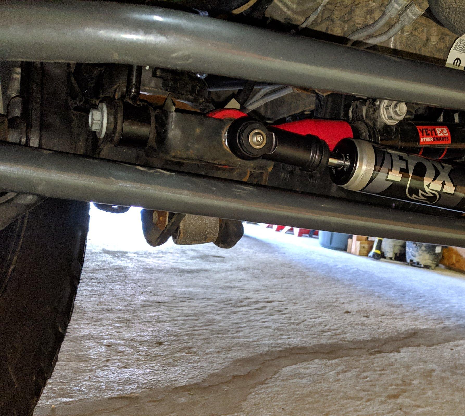

Hey guys, came across this thread as I was looking at the JK SS as well...
So @Command Line RC , the JK one comes with a relocation bolt like the picture; correct? Just torque it down to 120 ft lbs and call it a day?
Thanks guys for your help!
Jeep Wrangler JL JLU Fox Steering Stabilizer Issue? SS Relocation Bolt
Command Line RC
Mar 10, 2018
419
401
Cleveland OH
2018 Jeep JL Wrangler Unlimited
So @Command Line RC , the JK one comes with a relocation bolt like the picture; correct? Just torque it down to 120 ft lbs and call it a day. I did not have a hex screw that would fit my torque wrench so I did the best I could.
The JK version does not come with that relocation bolt. I put a synergy tie rod and drag link set on. The relocation bolt came with that. So in essence you would have to purchase it separately. Hope this helps

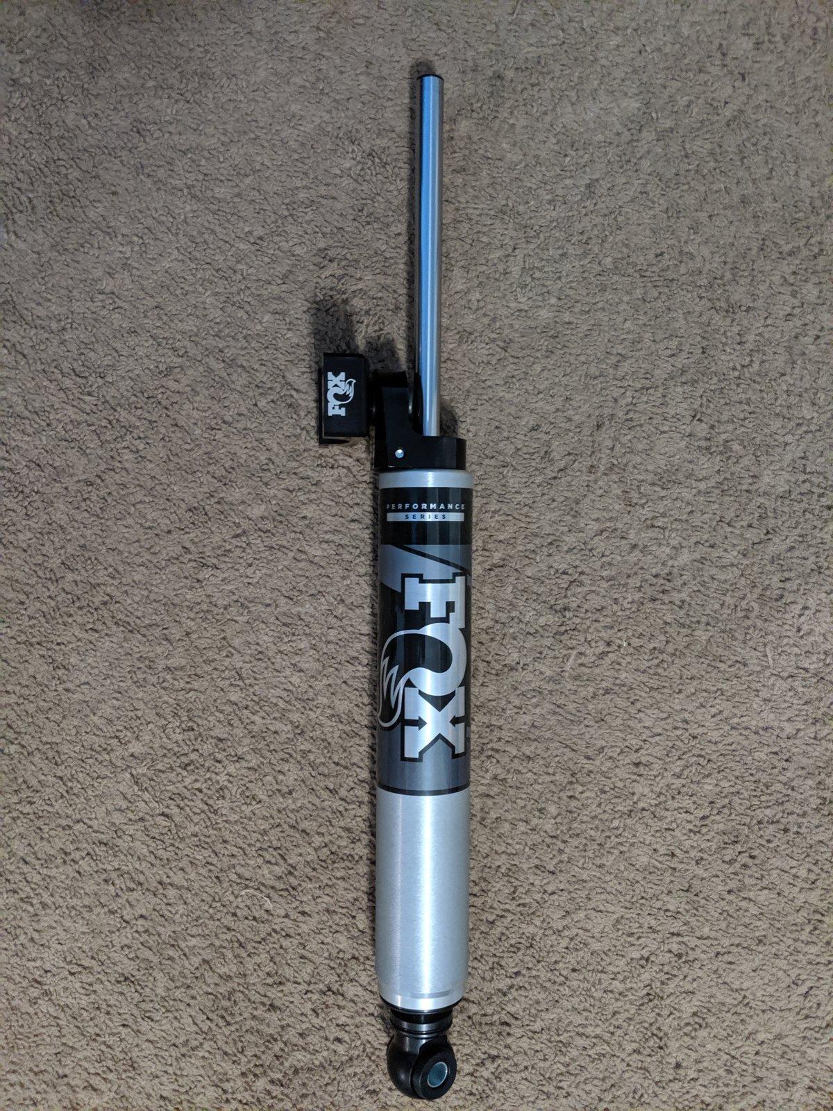

I just bought but of these but haven’t installed it yet. It very very slowly expands after being compressed. Does this mean it’s suffering from the same issues others have described?

no, not necessarily... mine slowly expanded too before I installed it but there is no pull whatsoever once installed. apparently there are some bad ones but odds are you'll be fine.
