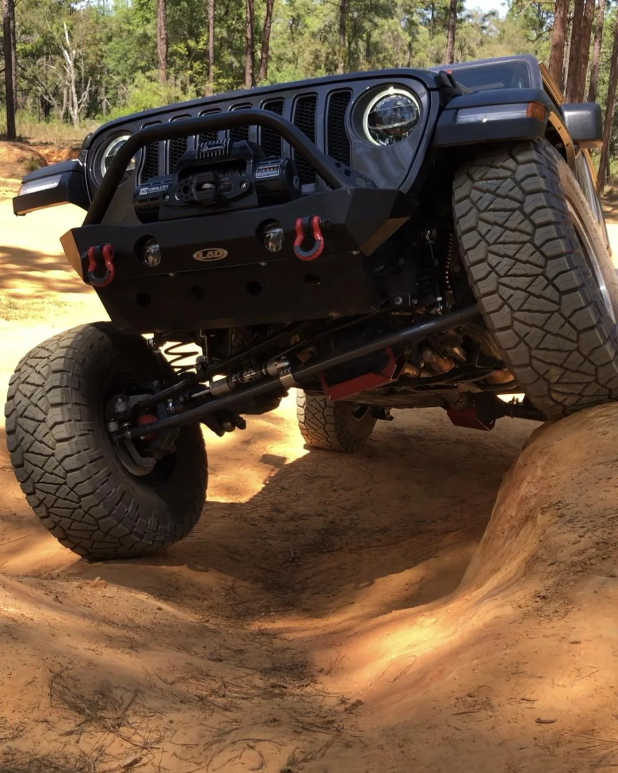

I’ve always run a dual stabilizer, not because it works any better, but I liked the heavier feeling steering it gives.
Jeep Wrangler JL Fox Steering Stabilizer 2.0 Pull Issue 66298FF5-2088-4CA1-AD4F-E0DE4231A357

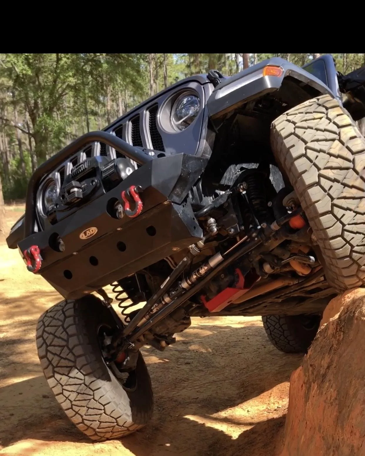

However..... since I put on the synergy tie rod, the dual won’t work because the new tie rod sits closer to the diff......:mad:..... So I’m using one of my fox 2.0s for now. I’ve got the fox racing ats ordered.
Jeep Wrangler JL Fox Steering Stabilizer 2.0 Pull Issue 4EE96471-6E20-4DB3-BEC5-38D1ED7DFA47
I wish I’d seen your thread sooner , there’s a way to let some pressure off those shocks......
