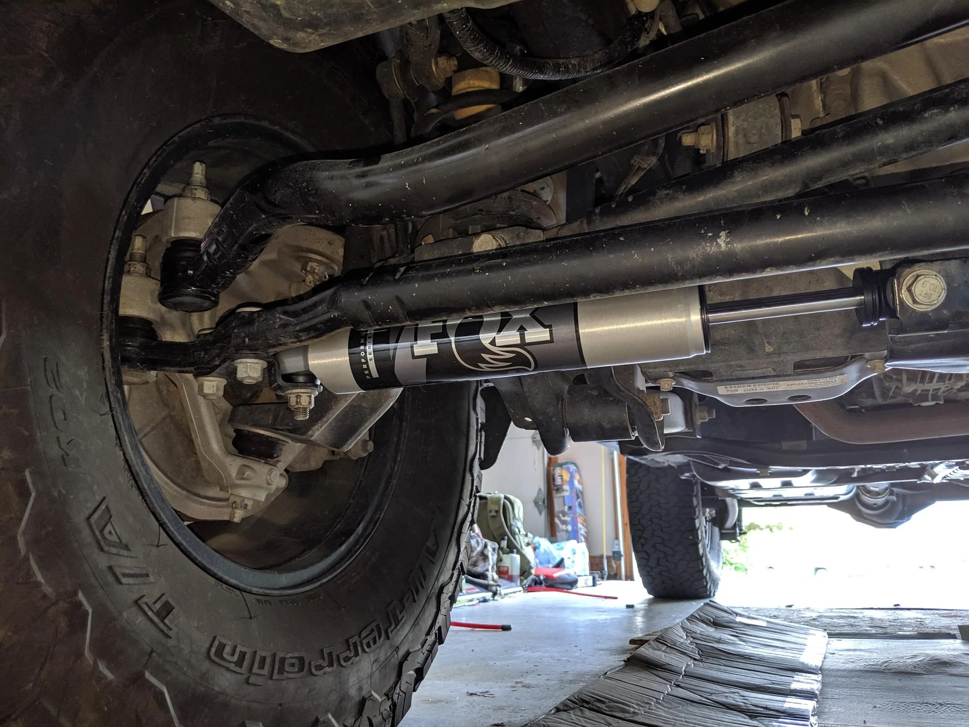

I installed the Fox a few weeks ago. No pull detected. It took care of my steering wobble, too. The shock body is mounted by the right wheel.

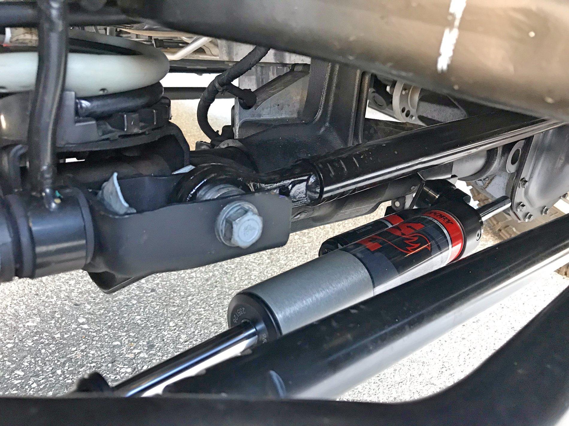

I had the fox put on today in place of the new updated mopar part that is on backorder by the dealership. It pulls to the right. I noticed it right away and after searching found this thread. The dealership installed mine with the main body in the center of the jeep, not by the wheel. Was there installation instructions with this? Maybe it is backwards? All online pictures i can find show it installed differently.
quick update, I flipped the unit around and the pulling went away. I have now had it on for a while and like it much better than the factory one.

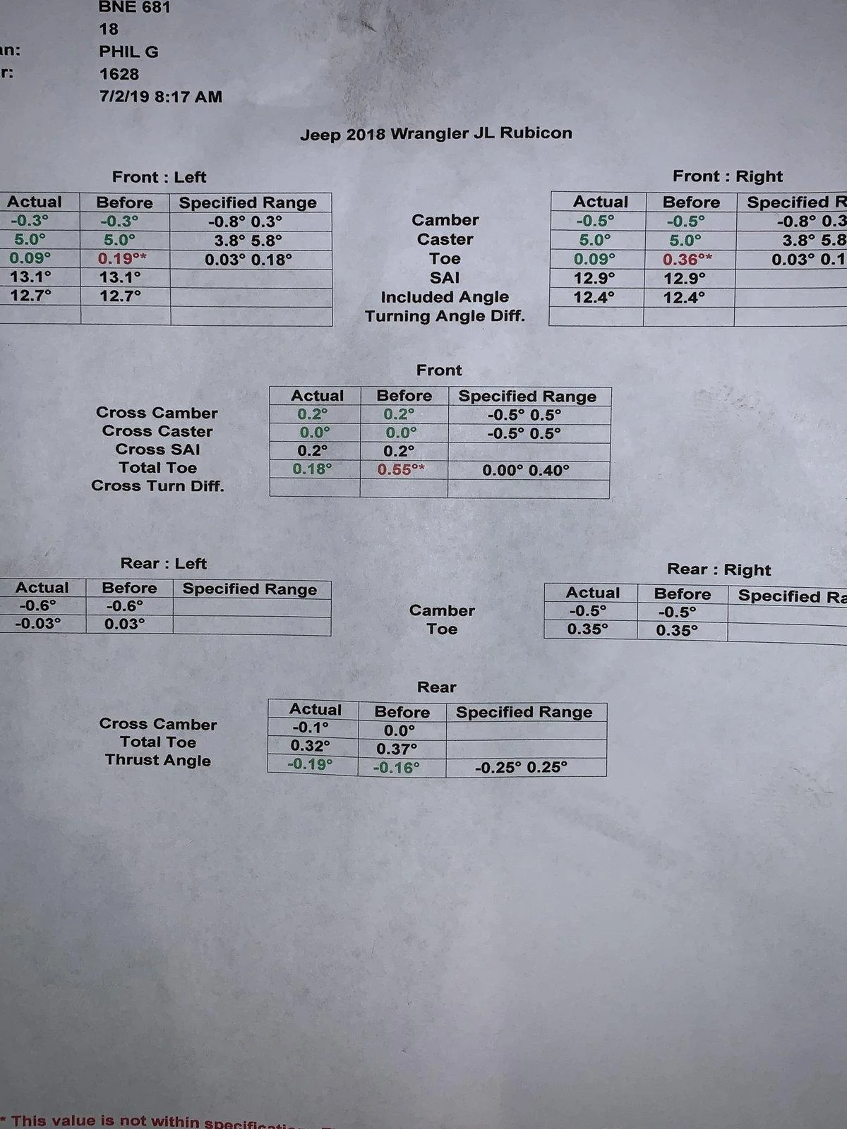

I’m new to the forum but I have the same issue. Mopar Lift and 37’s with the Fox 2.0 SS l. I just put TeraFlex Alpine adjustable front lower control arms and a Steersmarts Yeti front adjustable trackbar on over the weekend and took it in for alignment. The 4x4 shop that did the alignment says everything is set great and the only thing they can think of is the fox SS is the reason for the significant pull to the right. I’m going to try and put the old SS on tonight and try it. I called Fox today and they said I could send the steering stabilizer back and they would release some of the pressure? Sounds weird to me that that’s what a solution could be. also quadratec has the ATS neutral stabilizer on sale for $349 which is tempting but I don’t want to throw more money at the problem until I fully understand it.

You might want to also test it without any steering stabilizer to see if it still pulls. And what is your toe set to?

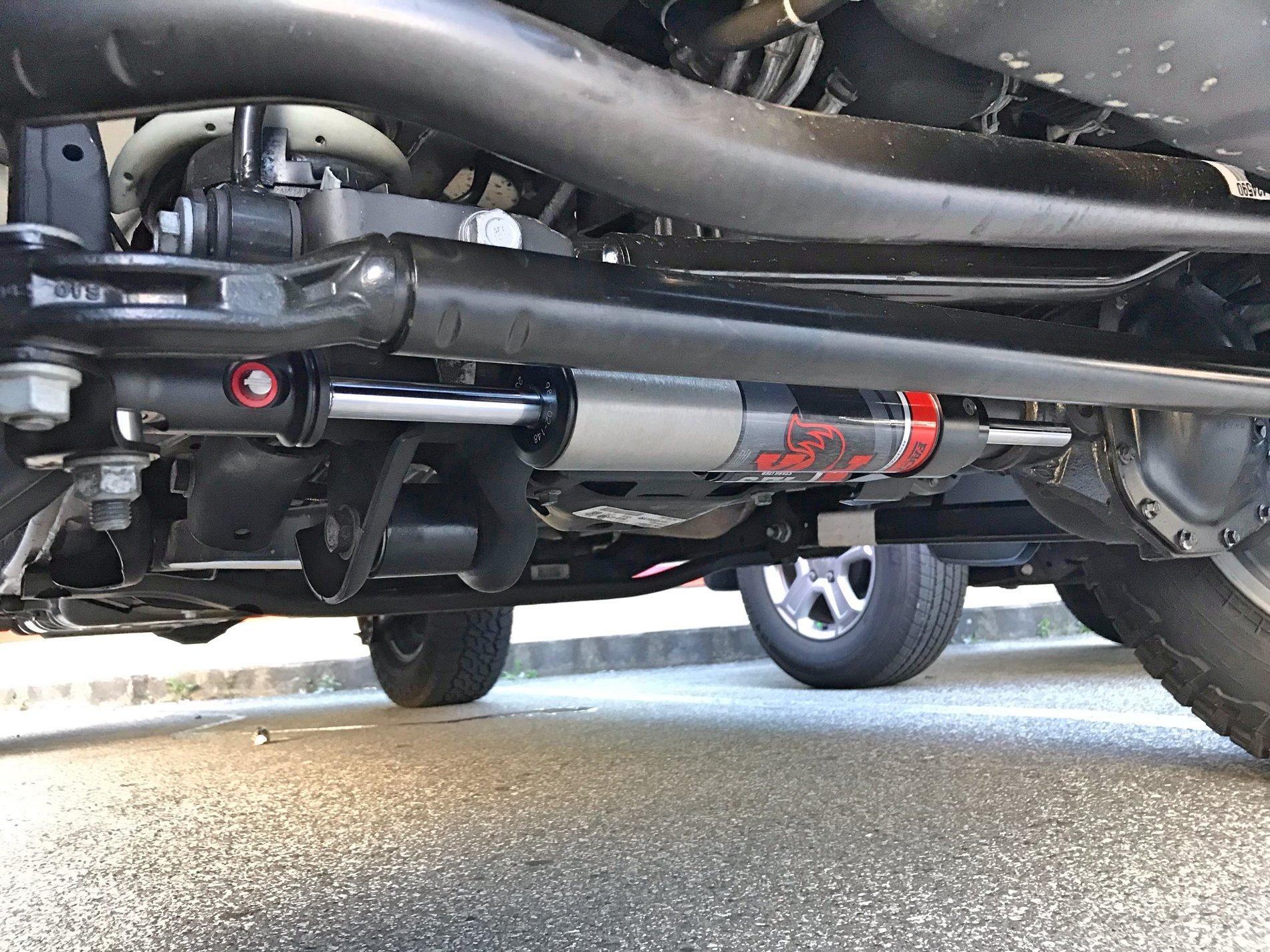

I believe I’ve found the issue as to the pull to the right. Here’s evidence as to why you should not not buy this Fox steering stabilizer. Watch the attached video of me compressing this and then letting it go. It expanded a full 8 inches after I tested it! I’ll be trying to get my money back. I thought it worked great at numbing the bumps when I first added it but this is unacceptable. It pushes my vehicle very quickly to right when driving.

So it won’t let me post the video here’s a picture of how far it expanded, 8 inches. I have the video of it expanding by itself if I can figure out how to upload

Yea this is why you should only run neutral force or equal force stabilizers.

Update: I put the OEM mopar SS back on and it drives great now. Problem fixed
