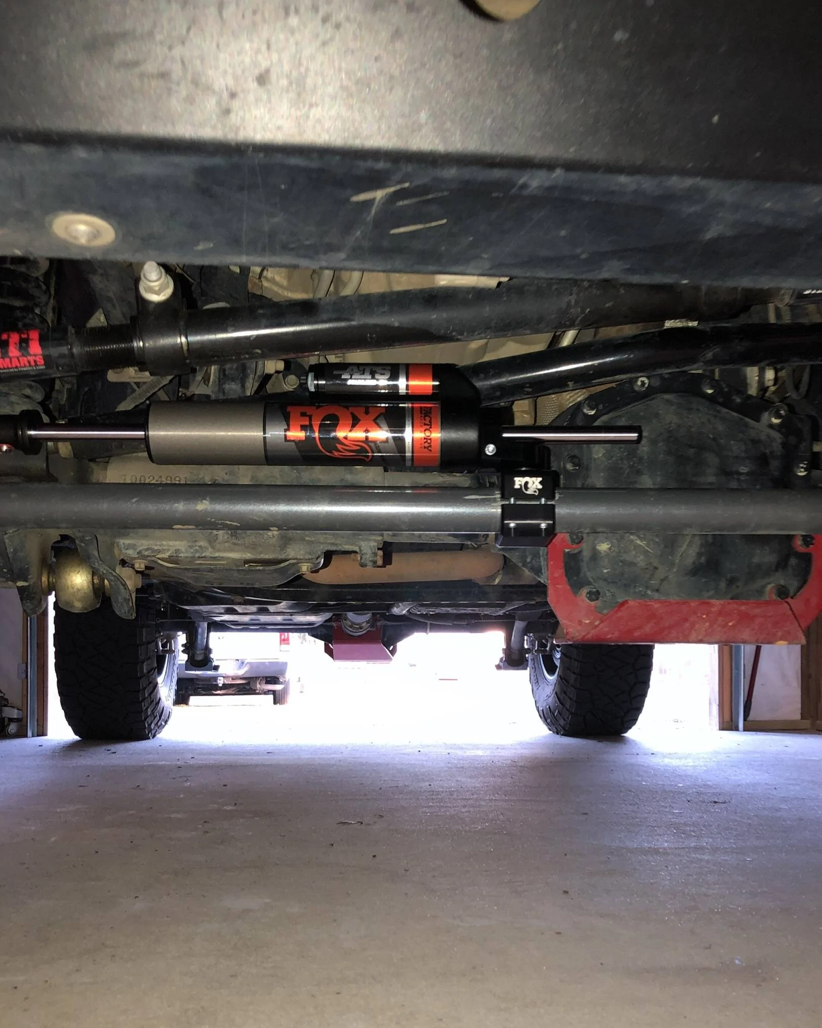

Shaft on axle end for me for added clearance when turning…….
Closed end shock…….
Jeep Wrangler JL FOX Steering Stabilizer - Orientation 4CA874A7-B186-4063-AAC5-AE6649F61922
thru shaft….

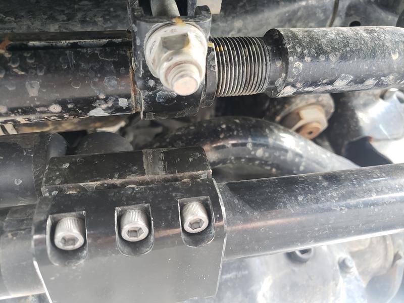

i had clearance issues with the fox thrushaft with my steersmarts kit, i finally bailed on it and just got a piston one but still bump the draglink and/or trackbar with the stabilizer bracket. i just lifted the jeep 2-1/2" so that should have made a little room since i was sagged an inch and a half or so because of gear weight.
(edit for pic)
prelift..
Jeep Wrangler JL FOX Steering Stabilizer - Orientation oRaguxB
