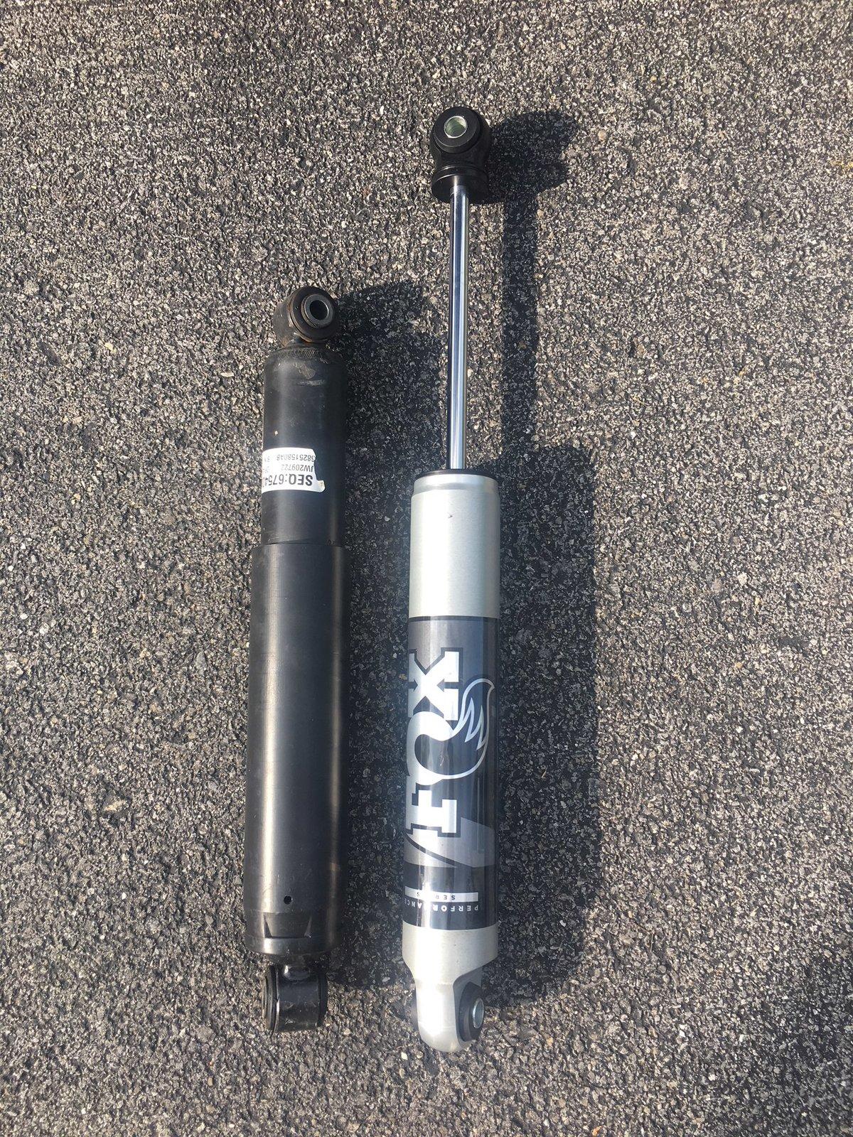

Do you have a hard time keeping it pressed in by hand?Yes, the Fox steering stabilizer definitely decompresses on it's own. It is noticeably slower than the Fox suspension shocks, but it does decompress.
Reason I'm asking is I'm actually working on a JK on the lift that has a completely dead stabilizer. The RC replacement requires a good bit of force to move in/out, but it will not decompress on it's own(Not gas charged.) If it is true that they are not supposed to be gas charged, then maybe you received a one off?!?
