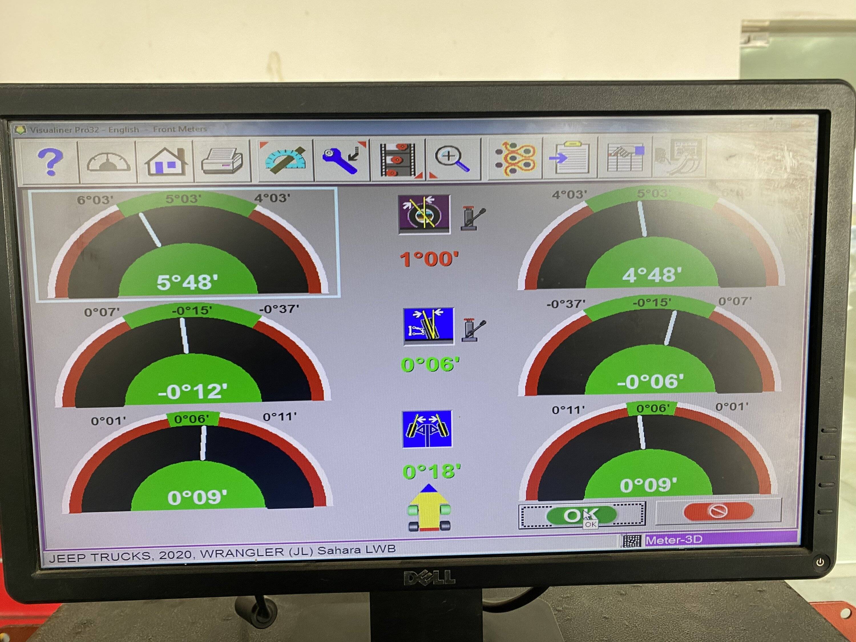

MEASUREMENT SPECIFICATIONS
Front Wheel Alignment Service Measurement Check Specifications
| Total Toe** | Caster | Cross Caster* | Camber - Left | Camber - Right | Cross Camber*
Sport | 0.20° +/- 0.20° | 5.35° +/- 1.00° | 0.00° +/- 0.50° | -0.25° +/- 0.50° | -0.25° +/- 0.50° | 0.00° +/- 0.50°
Sahara | 0.20° +/- 0.20° | 5.05° +/- 1.00° | 0.00° +/- 0.50° | -0.25° +/- 0.50° | -0.25° +/- 0.50° | 0.00° +/- 0.50°
Rubicon and 3.0L Diesel Sport / Sahara | 0.20° +/- 0.20° | 4.80° +/- 1.00° | 0.00° +/- 0.50° | -0.25° +/- 0.50° | -0.25° +/- 0.50° | 0.00° +/- 0.50°
Note: Caster values required to be greater than or equal to 4.0° for all variants
* Cross Alignment values are determined by taking the left side value minus the right side value.
** TOTAL TOE is the sum of both left and right wheel toe setting. TOTAL TOE must be equally split between each wheel on the same axle to ensure the steering wheel is centered after setting toe. Positive toe-in and negative toe is toe-out.
Rear Wheel Alignment Service Measurement Check Specifications
| Individual Toe* | Sum Toe* | Thrust Angle | Individual Camber* | Cross Camber*
All Models | 0.125° +/- 0.25° | 0.25° +/- 0.25° | 0.00° +/- 0.25° | -0.25° +/- 0.50° | 0.00° +/- 0.50°
* For reference only. These are non adjustable angles.
SET-TO SPECIFICATIONS
Front Wheel Alignment Set-To Specifications
Model | Total Toe** | Caster | Cross Caster* | Camber - Left | Camber - Right | Cross Camber*
Sport | 0.20° +/- 0.15° | 5.35° +/- 1.00° | 0.00° +/- 0.50° | -0.25° +/- 0.37° | -0.25° +/- 0.37° | 0.00° +/- 0.50°
Sahara | 0.20° +/- 0.15° | 5.05° +/- 1.00° | 0.00° +/- 0.50° | -0.25° +/- 0.37° | -0.25° +/- 0.37° | 0.00° +/- 0.50°
Rubicon and 3.0L Diesel Sport / Sahara | 0.20° +/- 0.15° | 4.80° +/- 1.00° | 0.00° +/- 0.50° | -0.25° +/- 0.37° | -0.25° +/- 0.37° | 0.00° +/- 0.50°
Note: All wheel alignments are to be set at curb height
Rear Wheel Alignment Set-to Specifications
All Models | 0.125° +/- 0.25° | 0.25° +/- 0.25° | 0.00° +/- 0.25° | -0.25° +/- 0.29° | 0.00° +/- 0.50°

Asking for a friend ;-D... so if they did an alignment on my JL with JK specs could that cause wobble?

Hello Guys
I have 1 inch castor difference and my Jeep pulls little to right side.
how to fix this difference?
