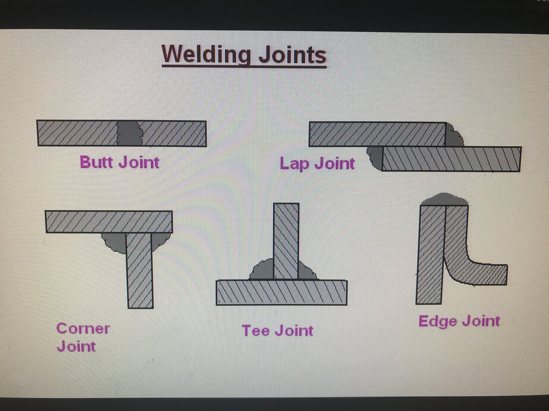

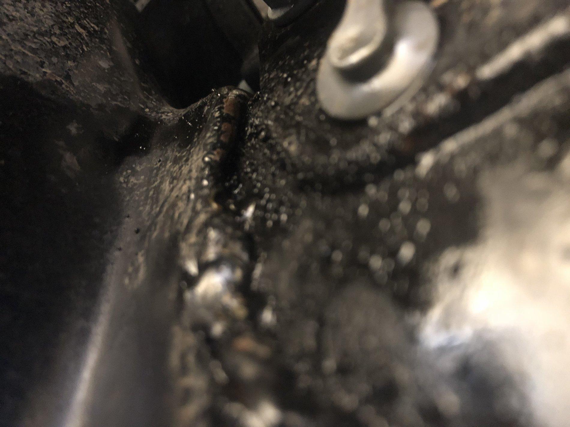

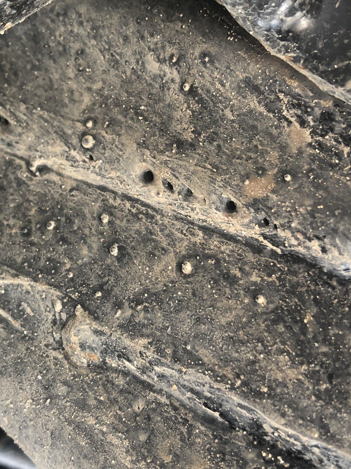

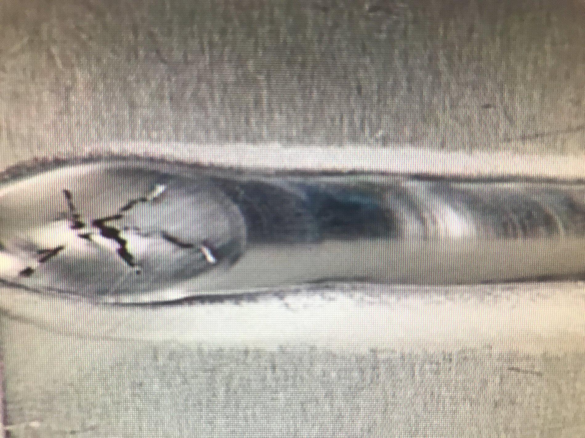

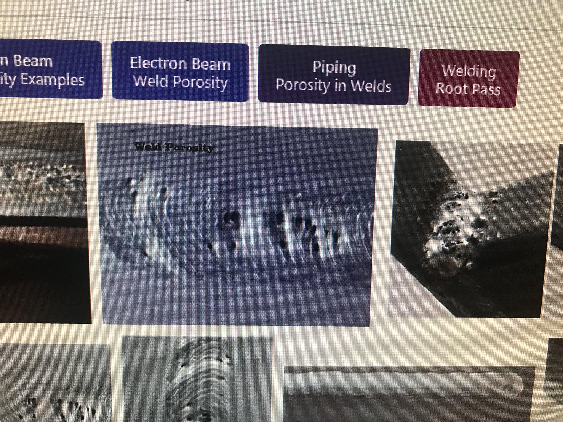

Ok, welding 101... there are 6 kinds of weld joints. Butt, Lap, Corner, T and Edge. Here’s a picture of the kinds... QC.. no holes in the weld, holes are known as porosity, weld should be convex, not concave, of course NO CRACKS, they usually happen at the end of the weld in whats known as the crater.. rule of thumb for weld size.. half the thickness of the base plate plus an 1/8”.... if you look at the welds on your rig and see holes or cracks there is a problem... here’s a pictures of joints also what porosity looks like and crater cracks... my opinion is this will not be a huge problem.. issues are usually caught quick.
Lastly, everything I’ve stated is regarding steel...Aluminum and Magnesium is different, same principle but different procedure...good aluminum welds look like stacked dimes

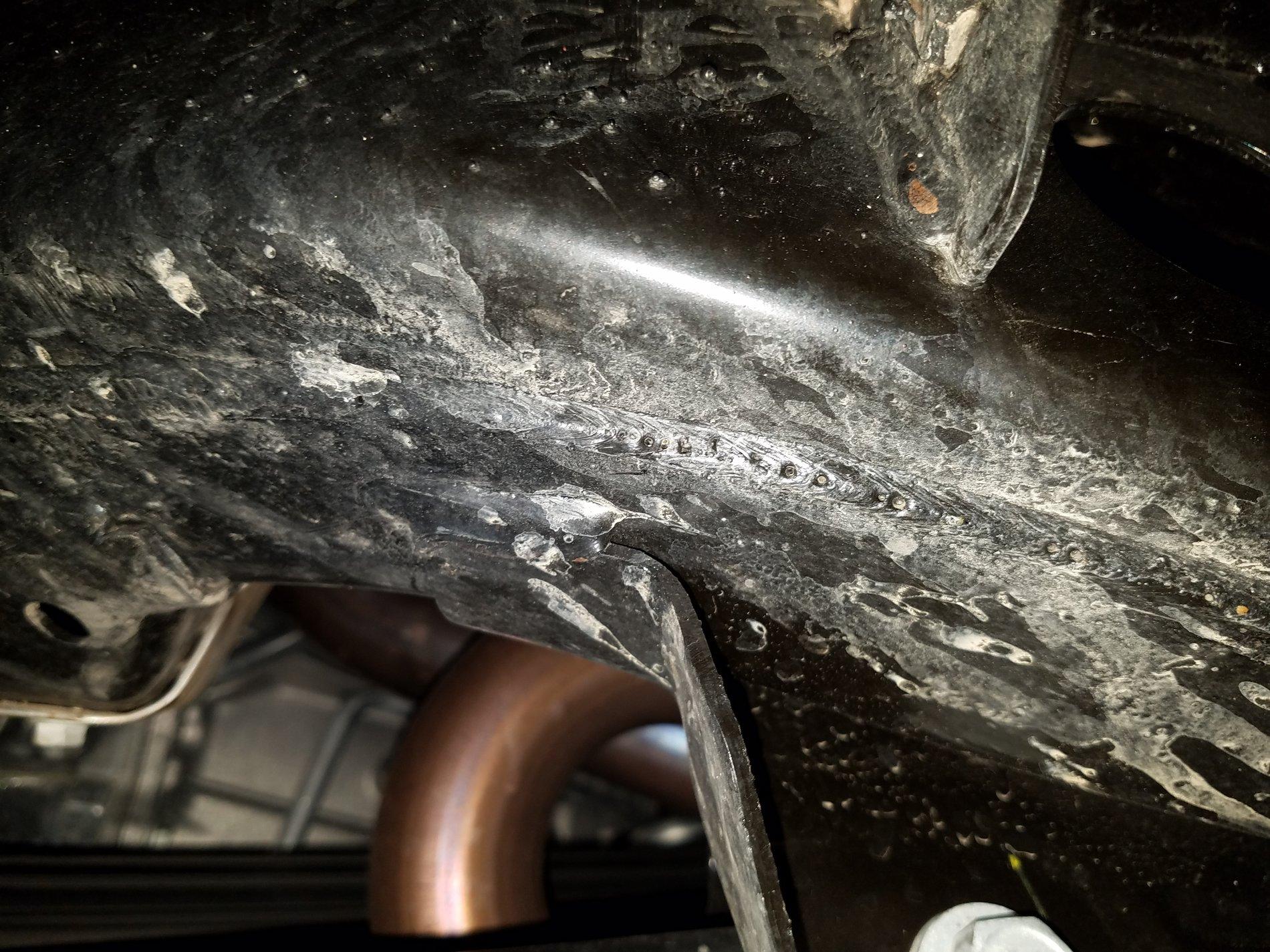

Mojito Mojo
Doug
Feb 15, 2018
447
663
Apache Junction, AZ and North Mankato, MN
2018 Mojito Rubicon JLU, 2004 Corvette convertible, 2015 HD Road Glide, 2014 Indian Chief Vintage

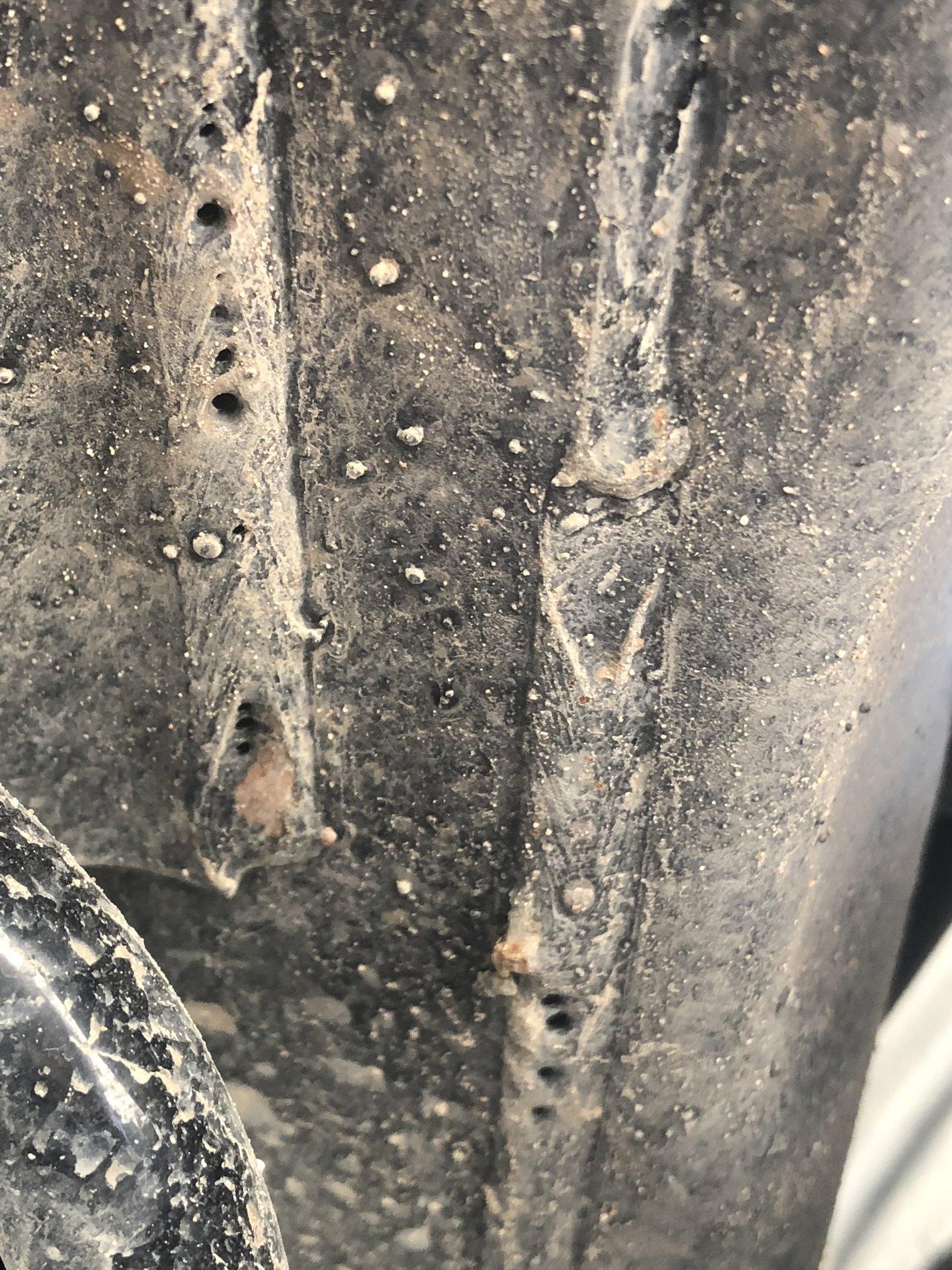

Holy cow those welds are terrible! It looks like splatter too that a previous poster mentioned. I would be requesting a new vehicle!

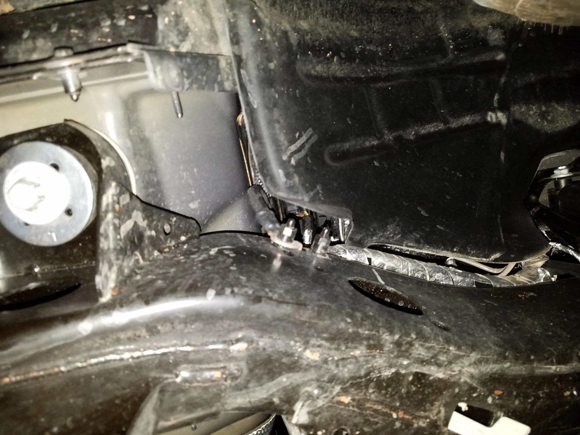

Nate
Mr. A-hole
Nov 16, 2017
836
2,640
Ohio
2020 Gladiator, 2019 Grand Cherokee, 2018 Road King, 1996 Bronco
Machinist, Gunsmith and Dumbass Whisperer

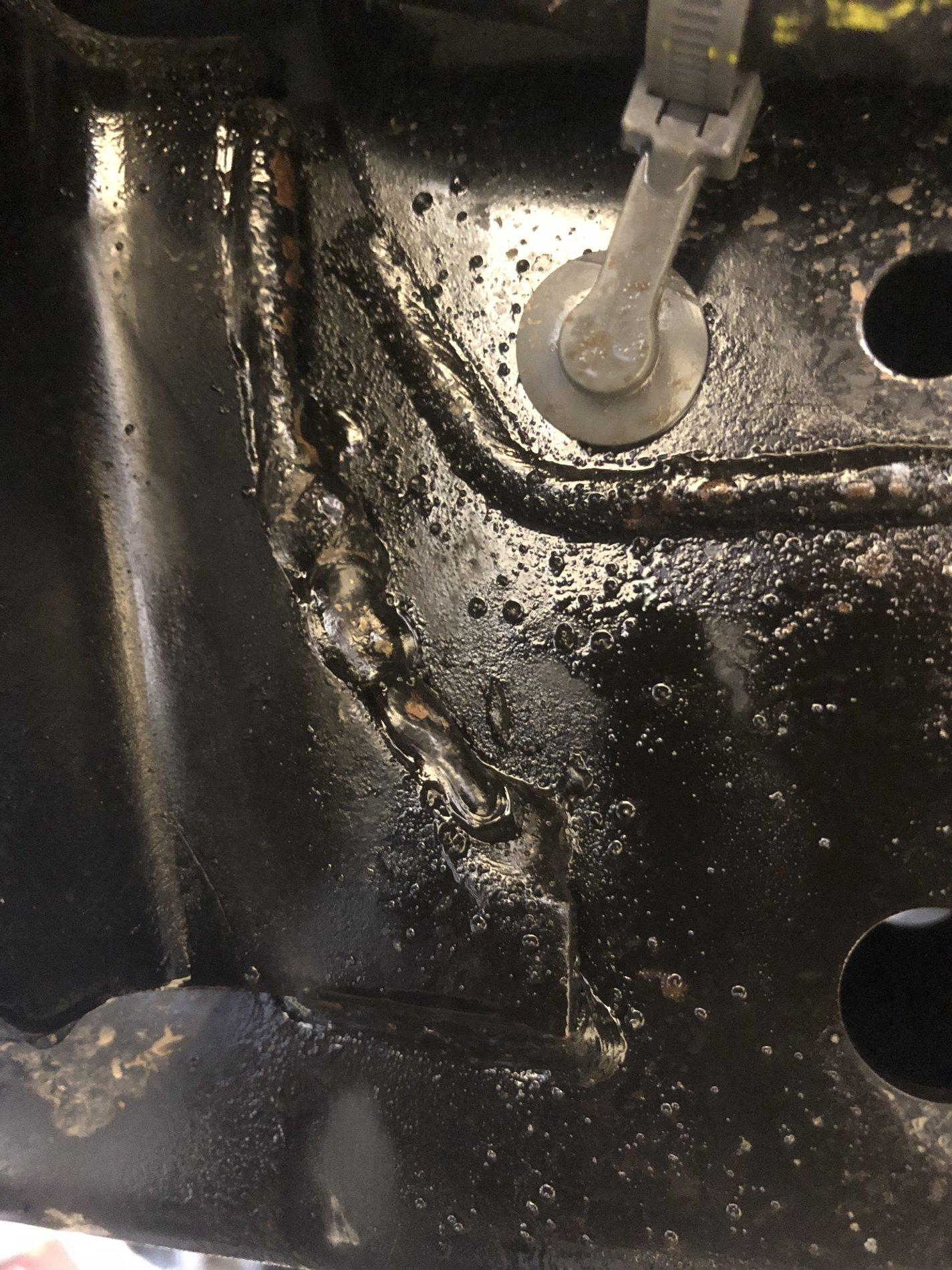

These are a few pics but almost all welds in the frame looks like this. Extremely poor quality.
Yup that looks like shit....
Most of that is robotic too, how in the hell did that get fk’d up?

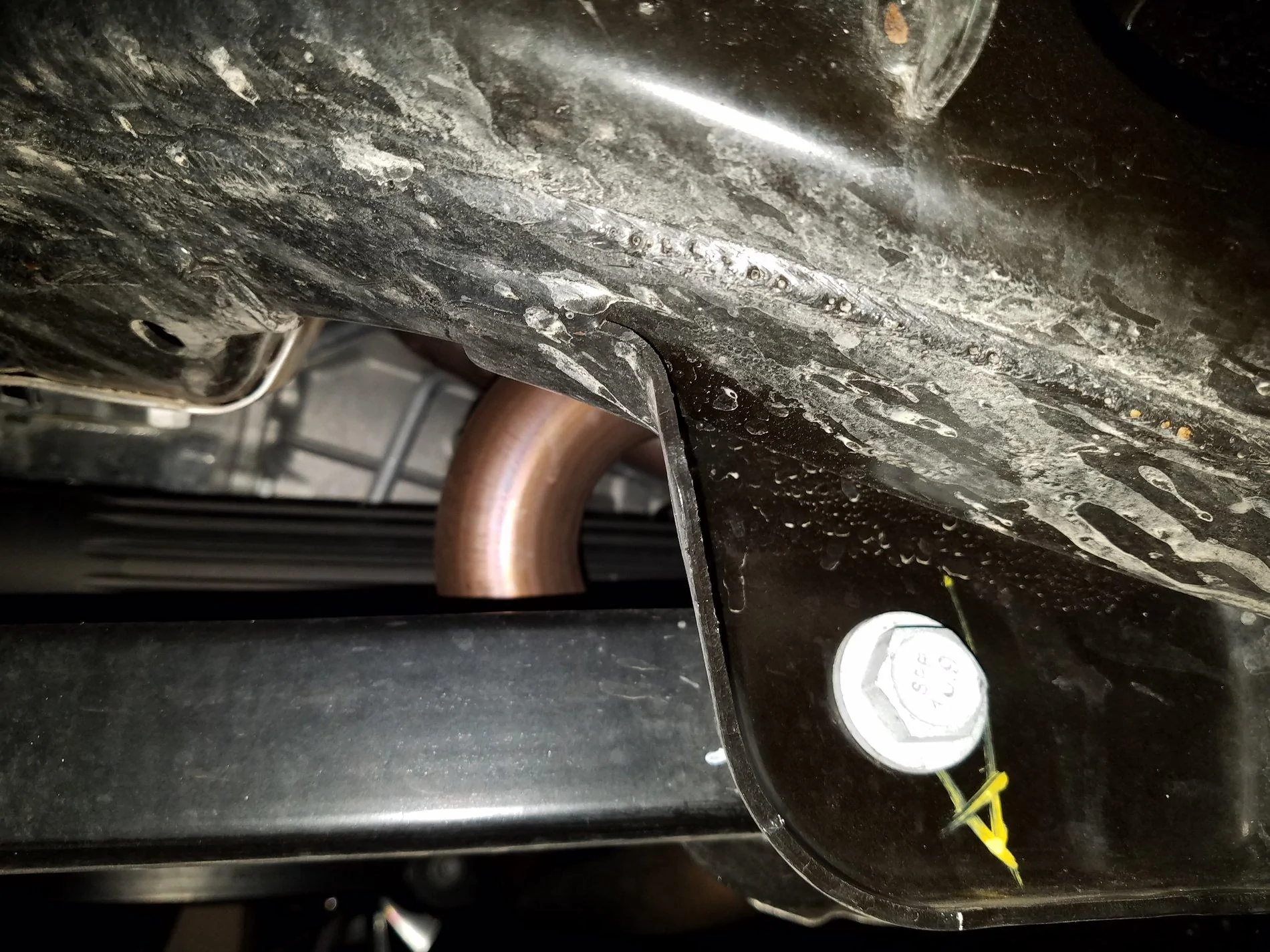

xpsruler
Feb 2, 2018
24
295
259
2018 JL Wrangler Sport

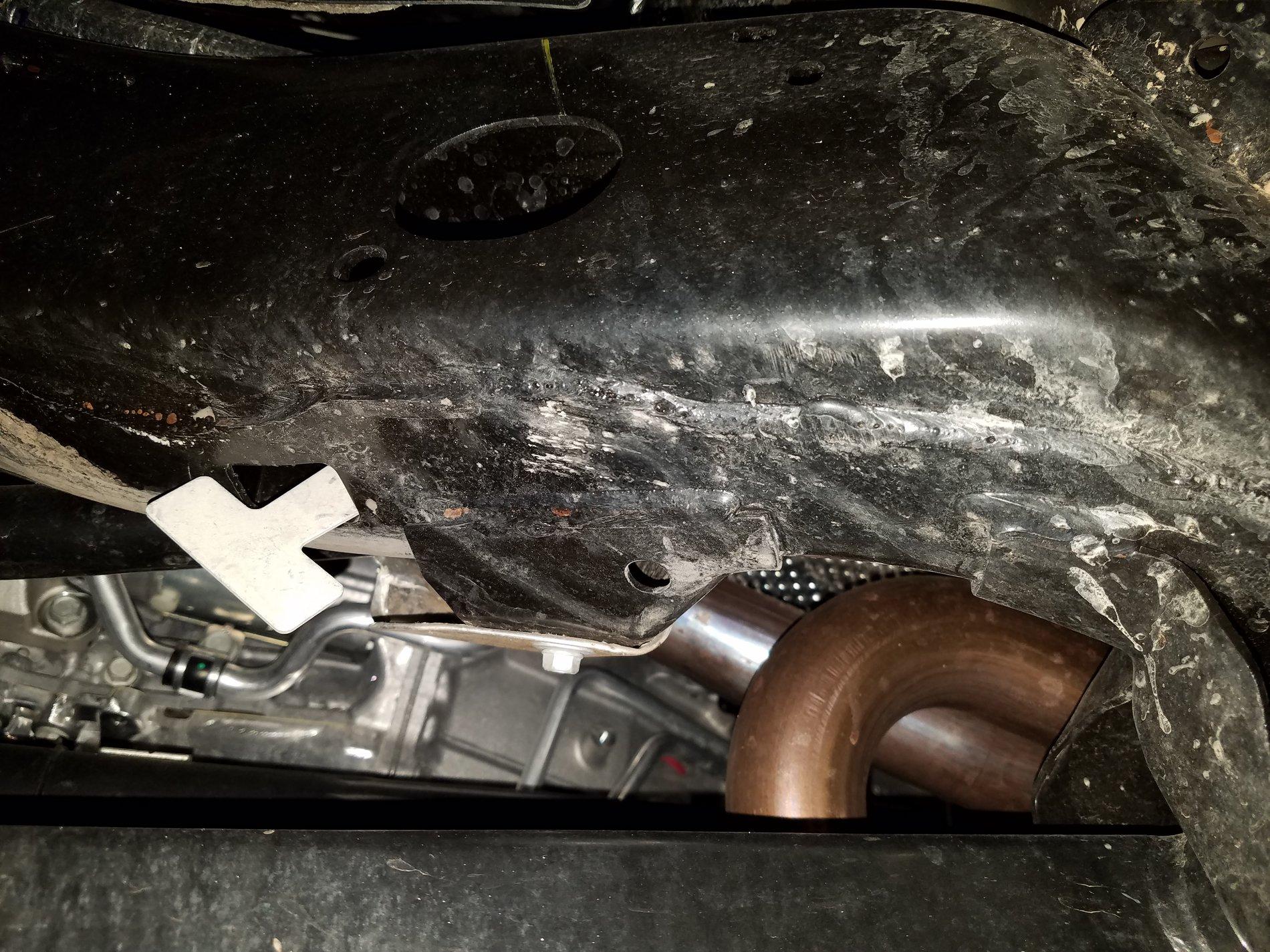

I took a look under my frame as well for comparison. Some porosity but it does not appear to be as severe.
