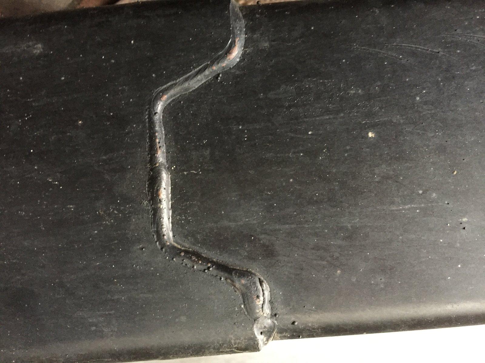

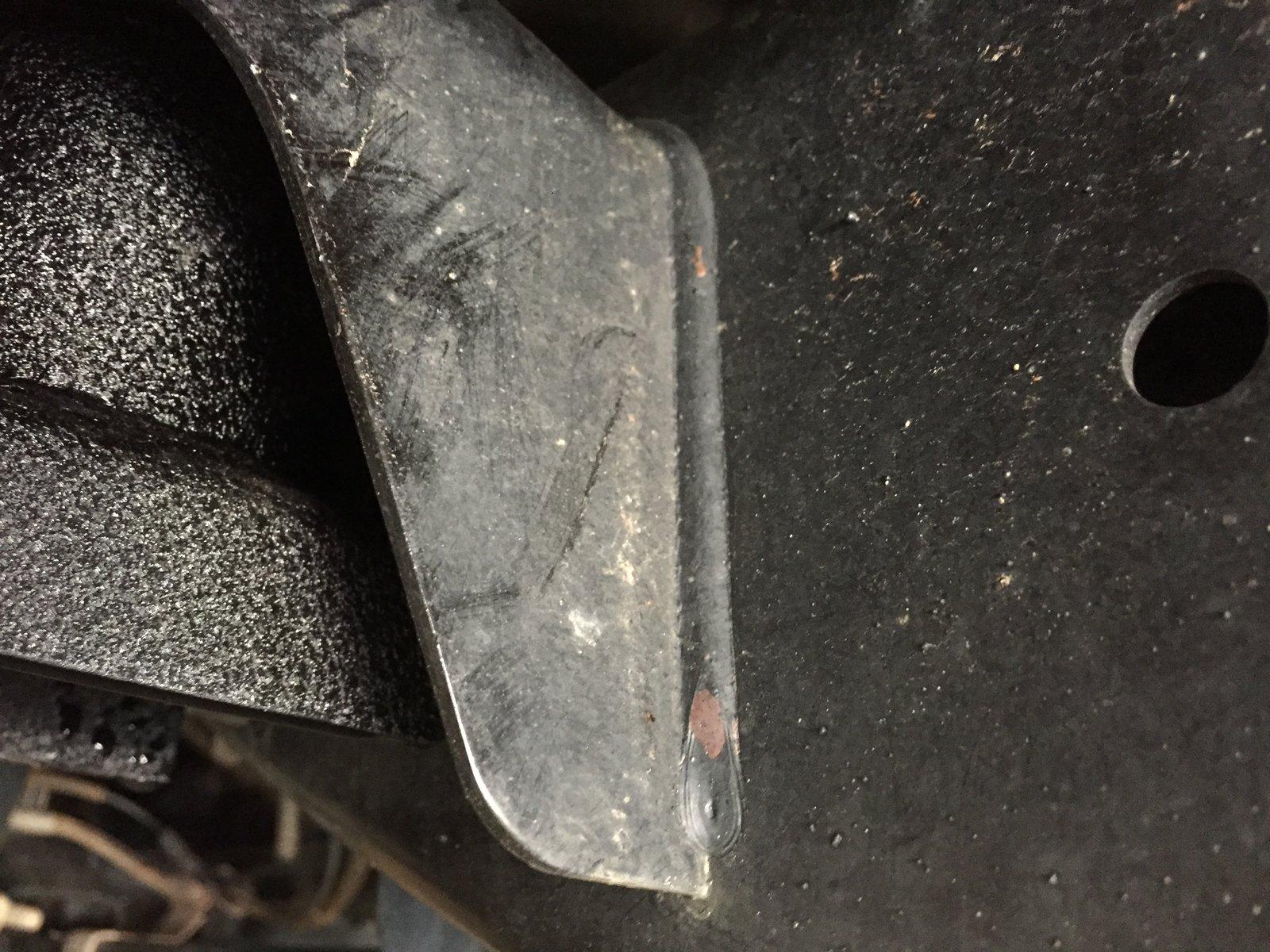

Looking at the the other welds, there is some brown formation on them, however it's not rust. I think many people are confusing what is rust and what is not rust (slag?).
Will the areas with slag start to rust because the paint didn’t adhere?
Yep. Rust will either cewwp under the paint or the slag will fall off and then the weld will rust. Rust can also get under the slag.
Elganja
Jun 21, 2018
30
2018 Bright White JLUR, 2015 Dodge Viper GT, 2014 Audi R8 V10, 2015 Audi S3
I'm not really qualified to answer that... but I've been trying to research it, and i have come up empty on it rusting. This is the wiki talking about welding slag: https://en.wikipedia.org/wiki/Slag_(welding) -- in it, it says the main reasons to remove the slag is for the following:
Slag does not contribute to strength or protection of metals after the welding process; it is waste material. Removal of the slag is necessary for four reasons:
  1. ability to inspect the quality of the weld area;
  2. aesthetics, or visual appearance;
  3. if a second layer or pass of welding is to be made on top of the first;
  4. to clean and clear the surface for coatings such as paint or oil.
Number 4 is what we already know from personal experience- i.e. paint will not stick to it. As well as Number 2- i.e. we all think it looks ugly.
I'm personally not going to worry about it-- i'll keep my eyes on it and check for rust over time, however I'm doubting it will cause any issues besides being visually unappealing. I'd be more concerned with porosity or actual rust, then welding slag (IMHO).
Ultimately, time will tell

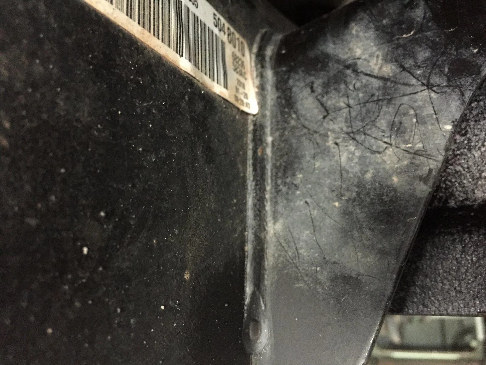

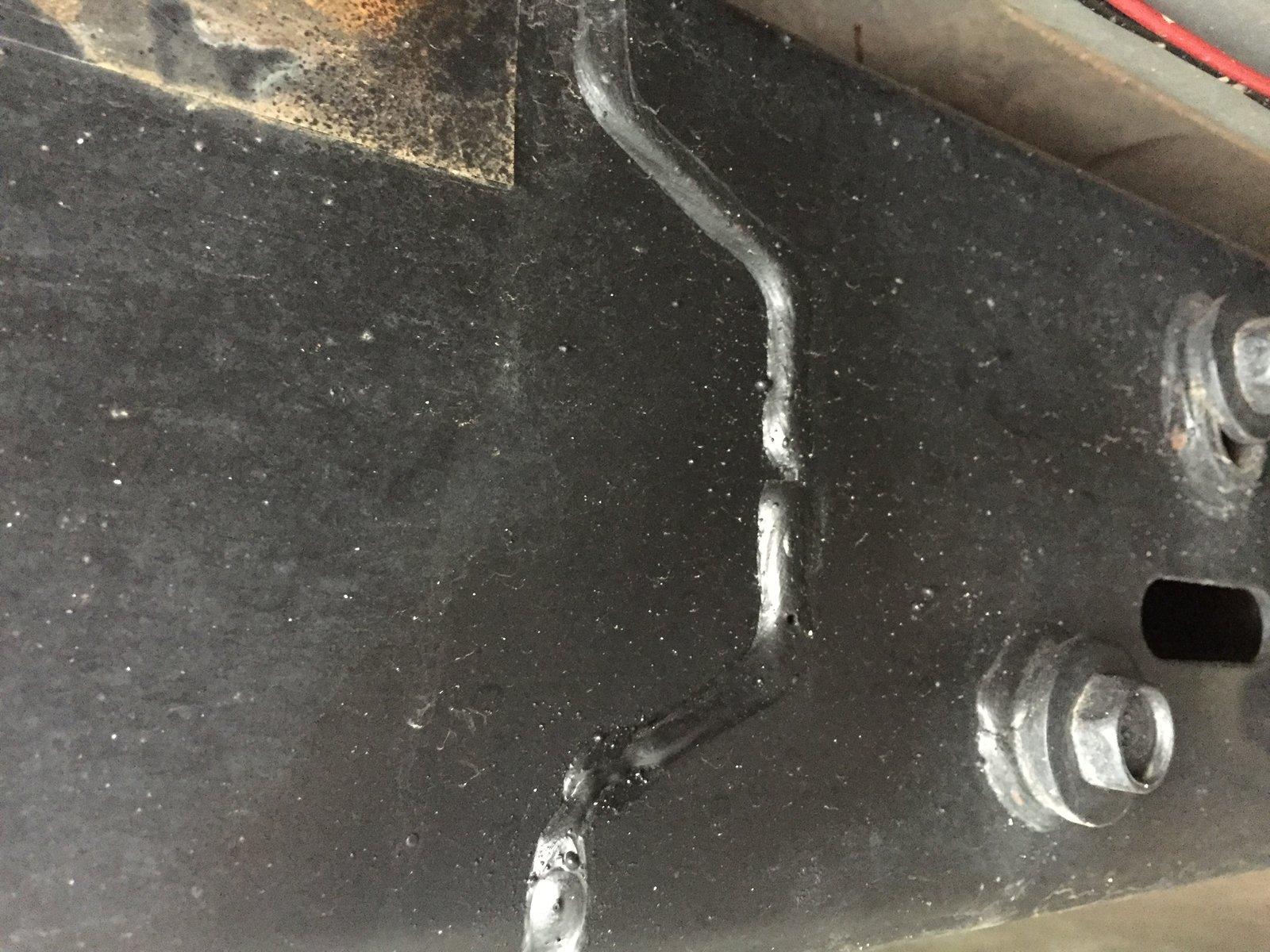

Sorry to see all these bad welds. I thought I'd upload some pictures of the welds on mine. They seem pretty good. It's like night and day! Very poor quality control. Mine was built in January.
Thanks for posting. I just posted in another thread asking for pictures of good welds so I can see what the difference is to compare
