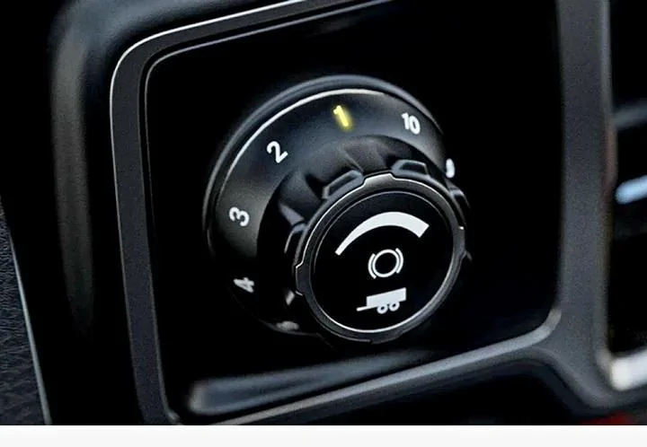

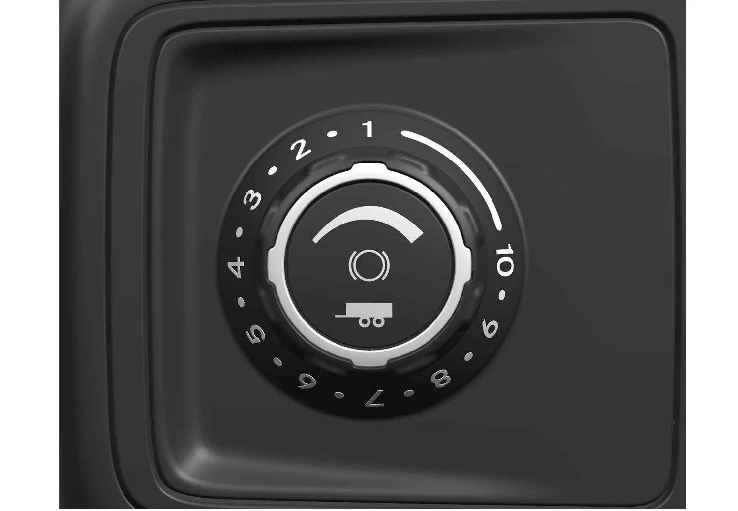

Has anyone installed the Mopar Brake Controller shown in this thread from the Gladiator site?
I’m going to order it but curious to know what it will be like without the factory installed tow package. I have already installed the hitch receiver and tow harness wiring but waited for the Mopar Controller.
Here’s the link:
https://www.jlwranglerforums.com/forum/threads/jeep-mopar-trailer-brake-controller.46238/
Looks like from their website it won't be out until July at the earliest.

Where does the controller go? I want to make sure I don't use that space with any mods I am doing between now and its shipping
Bryce
Bryce
Jun 2, 2019
1,302
2,804
Acworth, GA
2019 JLUR
From. This picture, it looks like it replaces the 12v Cigarette plug to the left if the window switches
